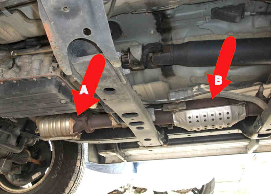

I had to learn about this stuff few weeks ago for emission here in CA cause my 99 t4r wasn't a CA version.
Look at your cat, if you have two like this pic, you have a/f sensor upstream and a o2 downstream. If you only have one cat, you have the both o2 sensor for both up and downstream (like I did), this is the most certain way to know what you have.
a/f is more expensive BTW.

Let me know if you have a Cali and need the front O2 (a/f) denso sensor, I accidentally ordered this one instead of the federal.
