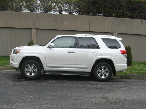

I have Bilstein 5100's all around, front set at .85" of lift. I love it. Noticeable improvement handling, feels more balanced, brake dive is gone.

can we see your setup!
Not much to see, really. I wanted to eliminate the fore-aft brake dive and acceleration squat, which was my motivation, and which the 5100's do. Side benefits were leveling, and a firmer, more controlled ride.
Fronts set at .85 + an alignment.
