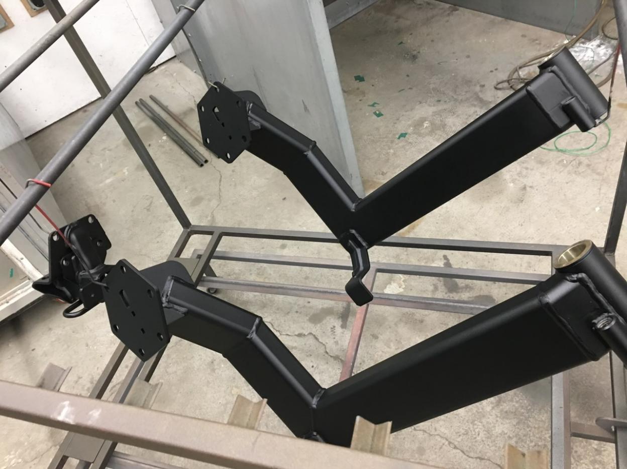

As far as the tab is concerned, the reality is that you can probably get away with just two mounts but the third mount will be extra redundancy.
I’m on mobile but I’ll do my best to describe how the bolts work:

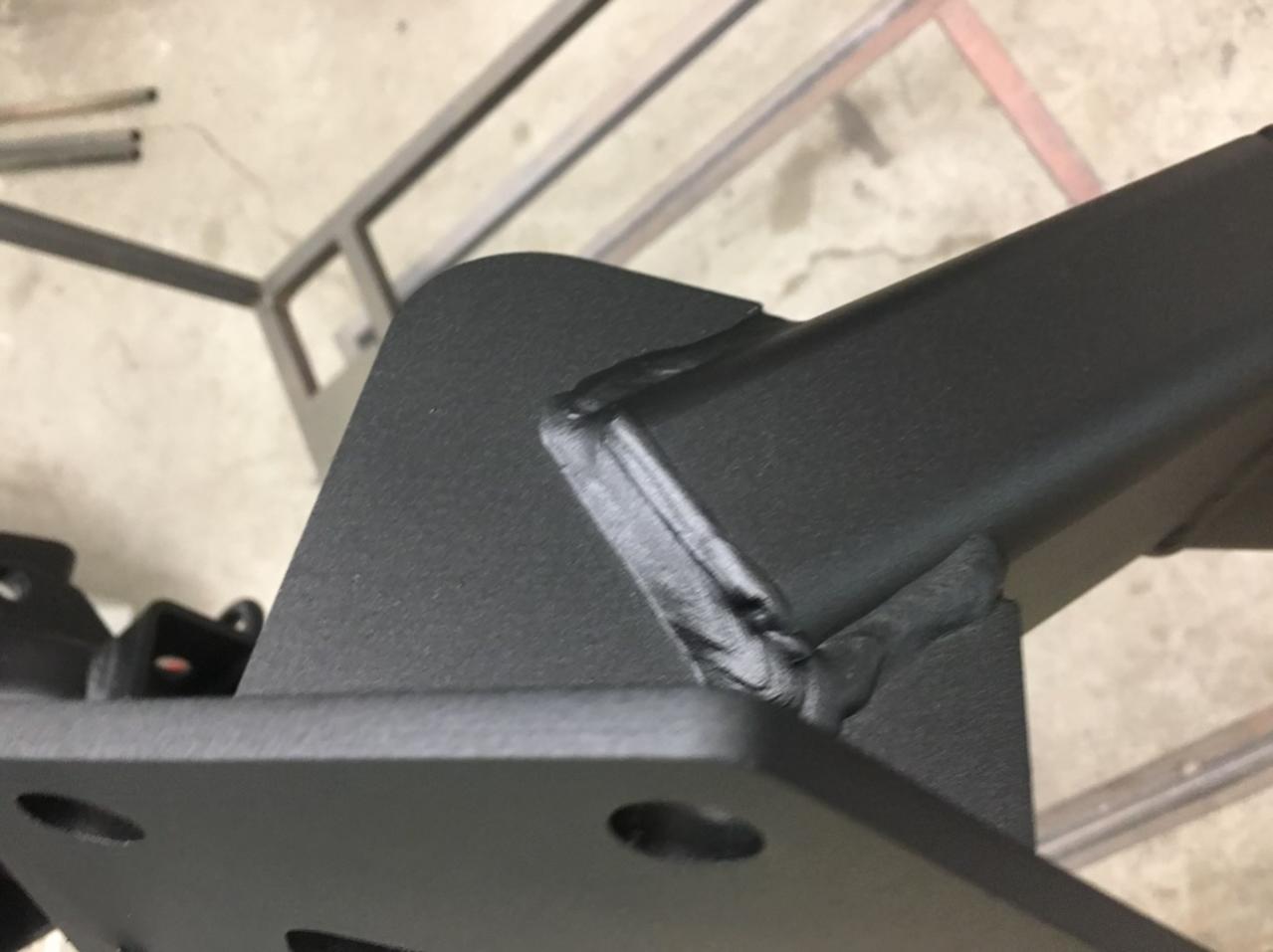

Bolt 1: grade 8 socket head cap screw. Threads into a “nut on a stick” on the inside of the hitch inserted from the rear. You don’t bottom out the head of the cap screw. The threads that stick out from the opposite side of the nut get a very tall nut/washer/lockwasher that pulls the carrier sideways - tight against the receiver. Here are some pictures, sorry I don’t have pictures from the “nut side”
These are the “nuts on the stick”
Bolt 2: is coupled with a stainless “yoke” that pulls the carrier hitch down - right against the bottom of receiver. I upgraded the yoke plate to 3/8” from 1/4” because I bent one of them (of course I was hammering on it with a snapon impact)
These two hold it super rigidly so the third bolt is really just extra security. Pretty self explanatory with this one, weld it on once the other two are installed and tight:

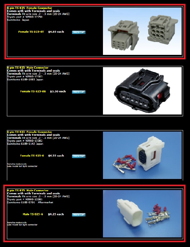

So, If you want to make your own Camera Harness using the connectors purchased separately and omitting the splices at the camera wires, you can purchase these items highlighted in red below.
Items found at > www.cycleterminal.com/ts-025 sealed series
They also sell the crimping tool.
Toyota part # 90980-12790
Toyota part # 90980-12381

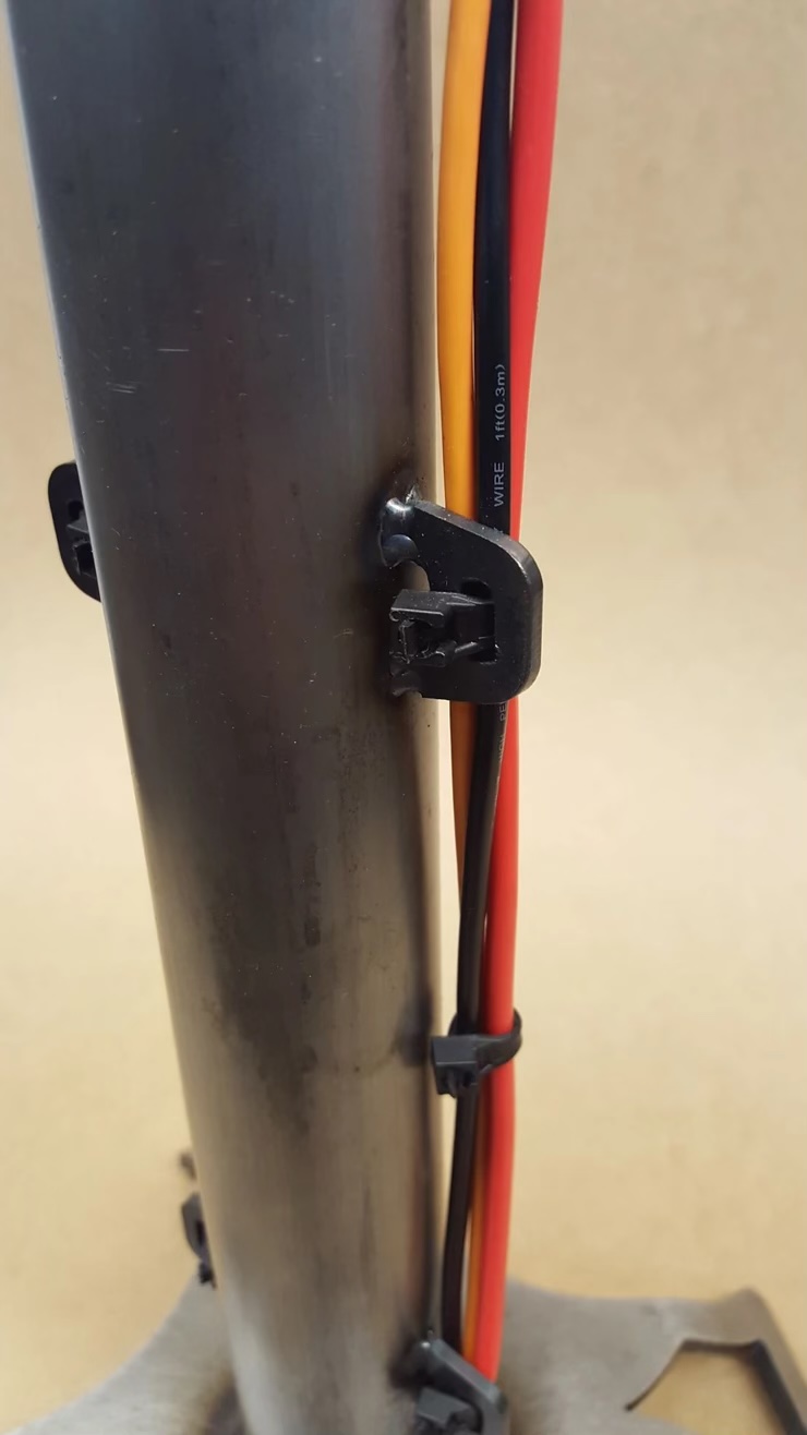

So I thought I would drop this photo of some wire tabs.
Installation of the zip tie should be as shown.
Through the tab and not over the top.
Of course wire looms covering your wires would make it look xcellent!.
Thanks to [MENTION=602811]ctnewman[/MENTION] for supplying the photo.
