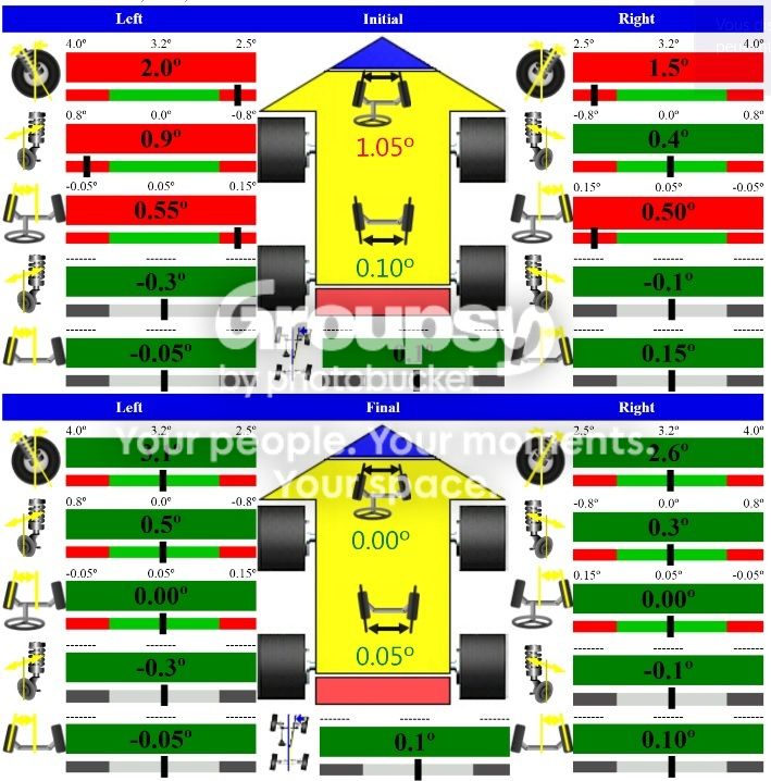

So fellas, I think I might have gotten the world's most wack, BS alignment today. As backstory, I had visually noticed that my front tires looked like they had a tad of positive camber \ /, and I noticed when driving that the steering wheel was slightly off-center.
Went to a local shop that supposedly does performance work, went over my setup with them, told them what I wanted (~4* positive caster, 0* camber, straighten out wheel, and below is the *best* they can do. I am running Icon extended travel front COs-set to Icon factory height (not cranked up) and Camburg Uni-ball UCAs. With my setup I strongly believe my alignment request is achievable, am I wrong???

Looks like they only adjusted the tie rods and didn't touch the eccentrics.

The dealership was able to get the alignment in spec and the truck now handles like it is supposed to. Ducmonsta, thanks for reaching out and I'll be going to your shop for the next alignment and whatever else I need that doesn't fall under warranty work. I also wanted to see if your shop does any car alarm work. I had a Viper 5901 system installed a couple weeks back and I need some follow-up done on it.

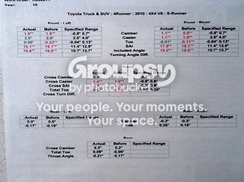

Figured I would throw mine in here for some opinions as well. Just did this alignment after putting in 5100s on a 2010 LTD last saturday. I did it with my buddy who is a service manager at a local shop. This is definately the highest we could get the caster with stock UCAs.
Still a bit odd to me that there is such a difference between the sides, although I know for a fact there is nothing more we could do. Rides awesome so far, no highway wander.

How do these numbers look to you guys?

Looks better than mine, but I think they could have given you just a tic of toe in.

You should have given up some caster on the drivers side to get them to match. Having the caster that far off from side to side can create some odd behavior. It might be good enough...

What would be the ideal toe-in amount for our trucks with lift?

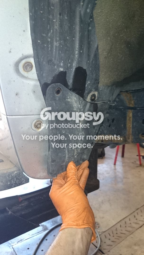

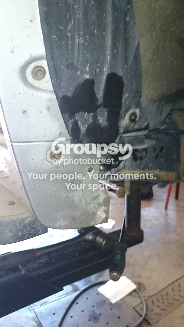

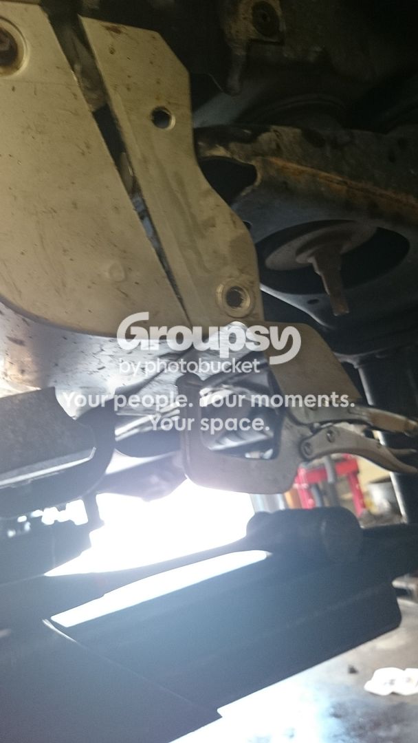

Went with max forward caster because I was trying to avoid doing a BMC if possible, mostly due to time constraints of 1 day in the shop. Once we got in there, looked like I would have a ton more cutting to do to get to the point where it would be worth it to do a BMC on a LTD. The forward fender liner mod was so easy and gave an extra 1.5" at least.
After driving around with it for a while now and testing it on a few concrete inclines, seems like rubbing on the BM is not going to be an issue at all. I'll have to check it out at max stuffage in reverse when I get the chance. I added white out to the BM to see if it rubs off.
I'll have an other go at the alignment to add a bit of tow in and reduce the caster a bit to match both sides when I get to see what kind of room I have to work whith when I get it flexed a bit. Just gotta start stacking up enough "favors point" with my buddy...
Here are a few pics of what I cut / removed, besides doing the fender liner mod, to fit the 275/60/20 on a LTD:

Just drive it for a week or so and see how it feels. @2" of lift, 1 degree of caster, and maybe a total of .2 degrees of toe in mine rides fine but it is a little drifty at highway speeds. If yours seems darty or drifts any ask them to put a tenth or so of toe back in. For all I know your increased caster over mine may offset that zero toe in you have. I'm just used to seeing some toe in on RWD vehicles to increase straight line stability. Yours being AWD maybe that is normal. :confused:
