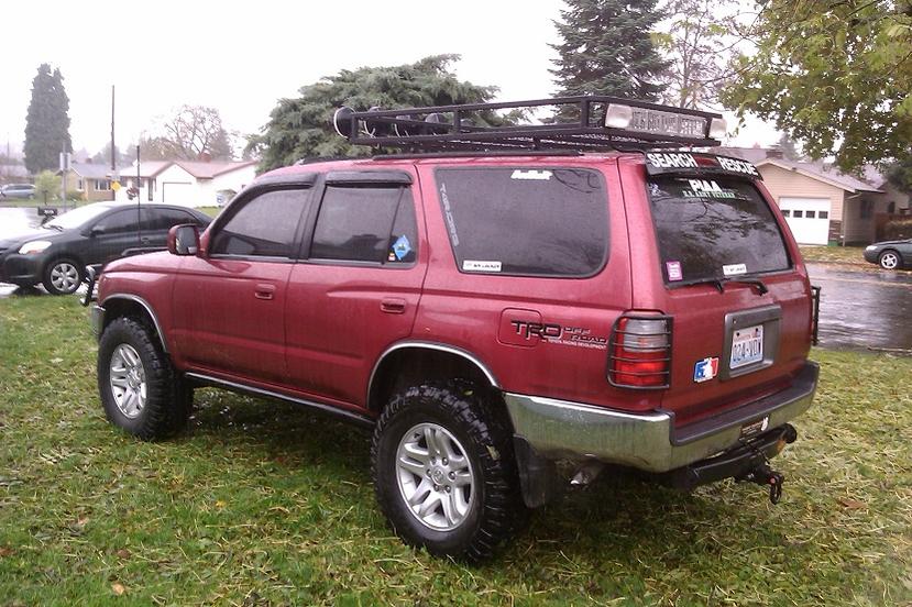

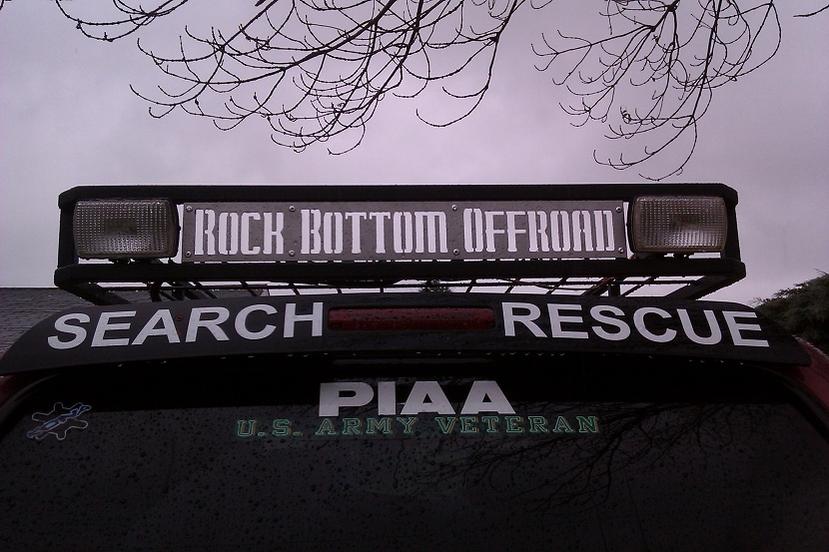

well this worked great for me...
there isnt much i cant see behind me, and for those of you who like to tailgate with your brights on, well ill help you see more too...
