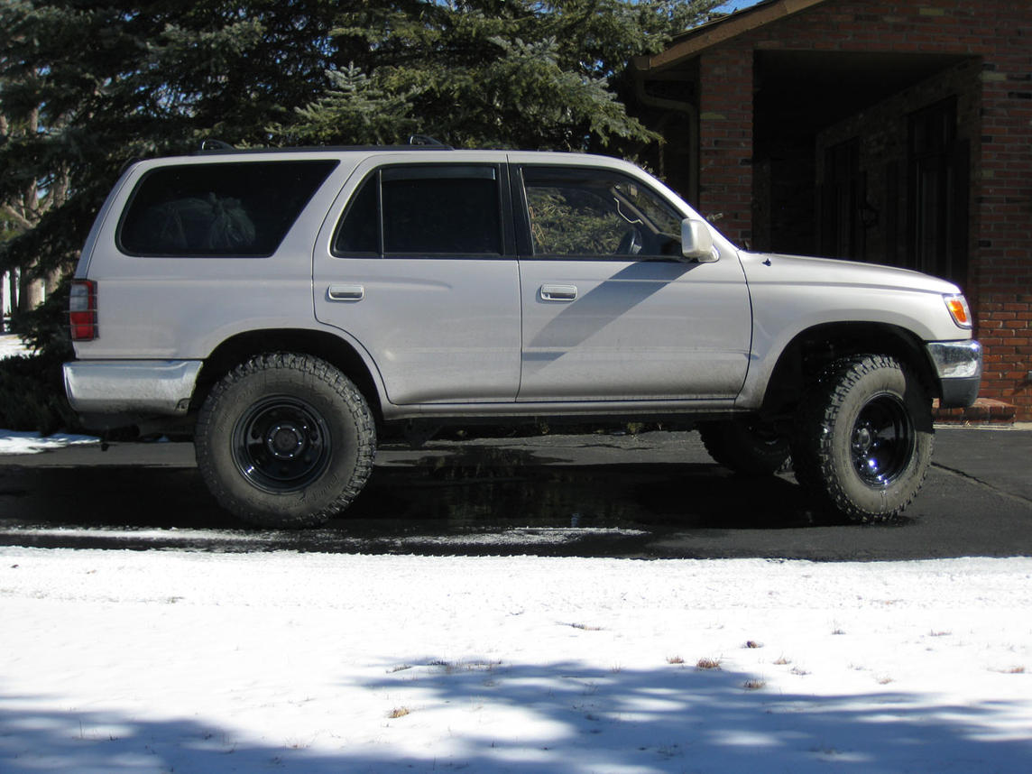

Here is my 98 right now. I have the adjustable coilovers from Camberg which sit anywhere from 2.5-3" in lift. I have 1.5" Daystar space in with my stock rear coils. I want something that rides a little high than it is now, but I dont want those super giant rear springs that everyone gets and the wants them to settle overnight.
I also just put on 255/85/R16 on my rig and there is a small amount of rubbing where the seam welds are on the front. Im thinking that if I raise the rear a bit more it will give me a bit more clearence right where they are rubbing?
Anywho, suggestion would be appreciated!
Do they make tundra or FJ springs that would fit? looking to level this thing out!

Does anyone think that running OME 891's would be better to level her out, or are 8 wrap LC coil better?

891s will sit pretty darn level with your front suspension. You'll have at least an inch of rake with 8 wraps (which I think looks and functions good). If you are interested, I will have some used 891s available soon, you can PM me if interested.
