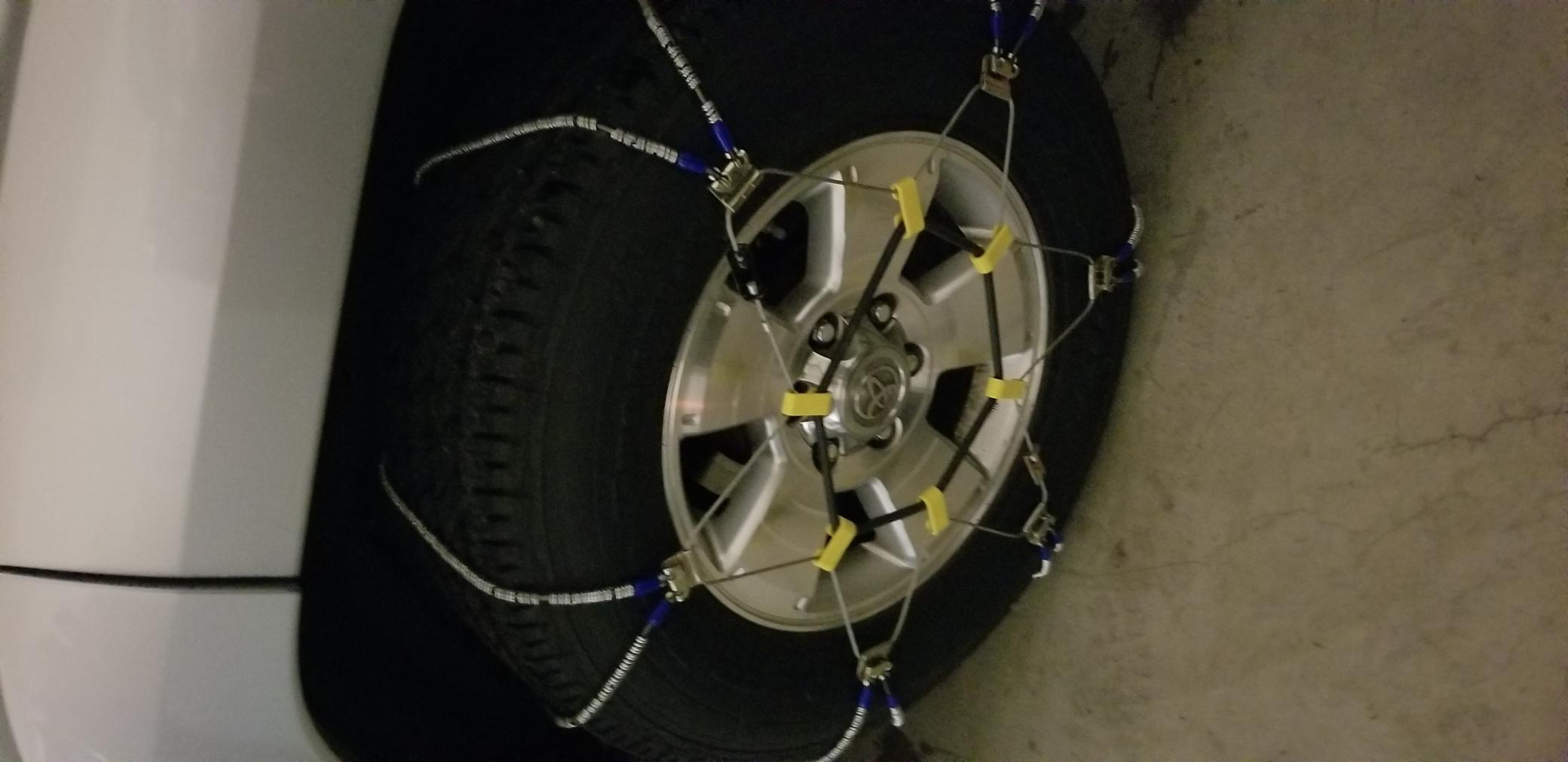

I need your advice on snow cables
missslucrew
Yes.... the dreaded snow chain/ cable question. Ive tried to search for the answer but every website has a different answer!!!
I have a 2004 Limited (best car ever btw)... should I put snow cables on all 4 tires or just the rear... or front????
I know I should know this! My guess is all 4 to get the most traction.... but then I read somewhere that your could damage the front brake line?
Any input is greatly appreciated!

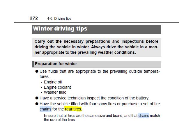

But here comes a shocker>
page 272 of the '19 4R owner's manual
states they go on the rear.:cheers:

Found another mention in the manual on page 274 where they state
■Tire chain installation
Observe the following precautions when installing and removing chains:
●Install and remove tire chains in a safe location.
Install tire chains on the rear tires only. Do not install tire chains on the front tires.
●Install tire chains on rear tires as tightly as possible. Retighten chains after
driving 1/4-1/2 mile (0.5-1.0 km).
●Install tire chains following the instructions provided with the tire chains
