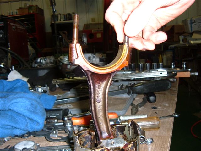

It doesn’t take very deep water to do much to a running engine. I was driving slowly through ankle deep water in a ’98 Taurus. A policeman in a Crown Vic was coming the other way, pushing a huge wake in front of him. I stopped, but before I could get my engine turned off, the wake washed over the hood. This what happened.
The car had 125,000 miles on it. My philosophy always has been, always try to fix it before you junk it. With one new rod and a piston it went another 60,000 miles before I sold it. We put 70k on this car and sold it for more than I paid for it!
