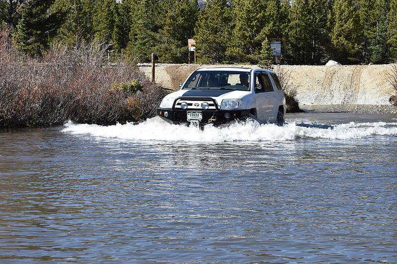

I don't understand how that caused a problem. This is something I do frequently w/o problems. Then again, it's water and not mud.
see where you're fog lights are? Mine were underwater. I just think I pushed it too hard trying to get unstuck and ****ed something up.
Understood. My photo is at the beginning of the crossing, typically it tops out at the top edge of my bumper / right below the headlights, I have ruined headlights though. Sorry this happened but I hVe to say thanks for reminding me how much IH8MUD.
