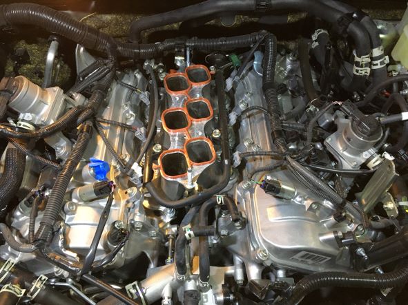

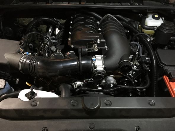

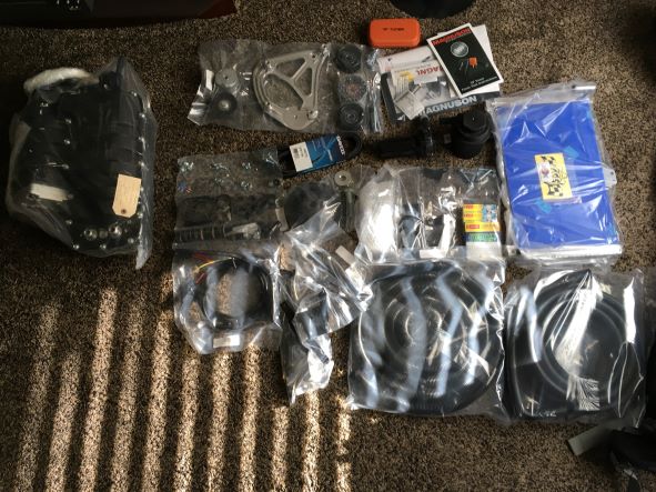

Mine took 2.5 (10-hour) days total to install including updating the tune, testing and test drives. I did it solo and was careful and methodical. I did not use any power tools except an impact wrench for the removing the crank pulley bolt.
Make sure you have a pulley holder for installing the SC pulley on the OEM crank pulley, I did not have a pulley holder/install tool and had to go old school with maximum effort - the torque spec on that bolt is 204 ft-lbs. I strongly recommend buying a pulley tool!
Make sure you have: a good set of metric tools; a 4mm/5mm or 3/16" socket (for stud removal); Pulley tool for Toyota V6 engines (on Amazon); torque wrenches (10 in-lbs thru 220 ft-lbs); a laptop (a crappy old one will work fine); heat gun/small torch; magnetic pick-up tool; some extra 10mm, 12mm and 14mm nuts; and patience!
I also replaced the Orange plenum gasket on top of the Intake you see in the photos, Magnuson says to probably re-use it, it's dirt cheap so I bought one before starting and replaced it. If you ever break a gasket, oring, seal, etc, just go ahead and replace it.

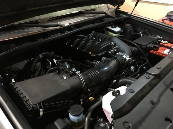

One last thing, if you are mechanically inclined I'd say do it yourself. You will learn a ton about your engine which is always helpful down the road.
I am an engineer, I build complex machines for a living and I grew up working on vheicles - my grandpa was the senior engineer at two GM plants in the 50's, 60's and 70's. Having said that, you are not breaking any major gaskets, youre not doing valve work, not removing the head, you aint dropping a gear box, etc. This is something you can do yourself.
I've seen other posts of people wanting to do other stuff while they do the install or already thinking about modifying the Tune from Magnuson or swapping out pulleys - dont! Magnuson knows what they are doing and they work with Toyota directly. Do one mod at a time. Ask Magnuson or Toyota before modifying the SC system.
The 4Runner is a very well engineered vehicle and Magnuson makes SC's for Toyota. This SC was specifically made to work as a long term bolt-on upgrade for the 4R's, it was thoroughly tested and has a great track record. It's not a race car and never will be.
