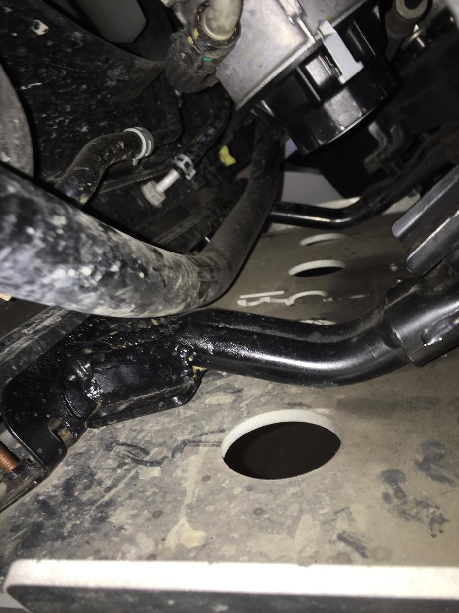

You're probably thinking about the left radiator support bracket that needs to be modified or removed to clear the sway bar with the Fox kit.

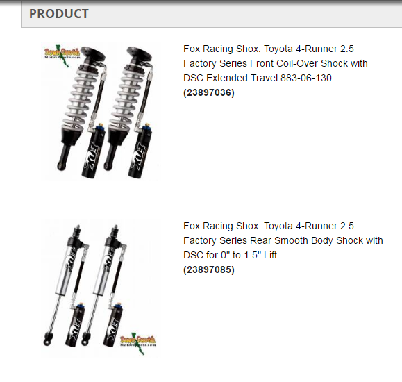

So this appears to be the part #'s for the Fox setup if you want dual speed compression. It doesn't really let me call out KDSS vs non so to what was stated earlier the bracketry for the remote-resi is the same.
