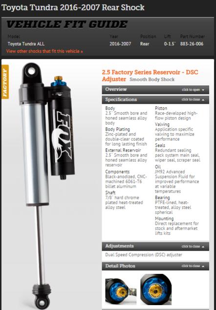

This is what I have received back from Fox when inquiring about the Tundra 2.5 vs the 4-Runner 2.5 rear shock.
The part number 883-26-004 is designed for up to 1.5” of lift, we would not recommend going over this.
The tundra rear shocks are close to the same design, but use a different size lower eyelet and have slightly stiffer Valving. They are just over 1” longer.
I've requested information on putting on the Tundra shock from 2 separate vendors and they don't really like the idea of doing this but with DSC it makes sense since you can dial in the ride you want. It's not as though I would be tossing in a non-adjustable shock. Plus it's been done before without issue. Expect some kick-back when ordering or order separately I suppose.
For comparison here are the two shocks as listed on the FOX website.

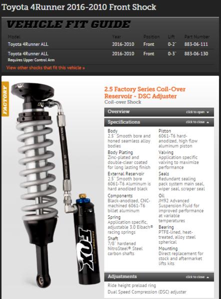

Also, [MENTION=99702]jrandom[/MENTION] this was the response from Fox when I inquired about sourcing the front coil-over with a heavier rated spring.
Can this coil-over be had with a 650# spring vs the 600# spring that comes with it by default?
Other springs scan be switched in, however from us they are only available with a 600lb spring. (14” x 3.0” ID x600lb)
AND I also inquired about pushing the front coils to 3 since King doesn't really condone this with their front coil-overs.
Are there any issues running this coil-over at 3" of lift? Is there a loss of ride quality if running at the max 3"? What height are these set to by default?
Out of the box they will provide 2” of lift, they are designed to go up to 3” so there will not be any problems in doing so.
