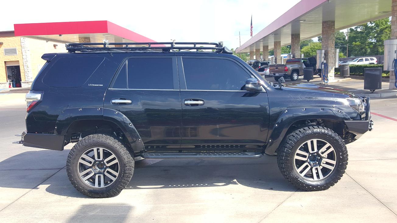

Here's mine with the Overland Springs up front and in the rear. Truck is unloaded and low on gas in this picture.

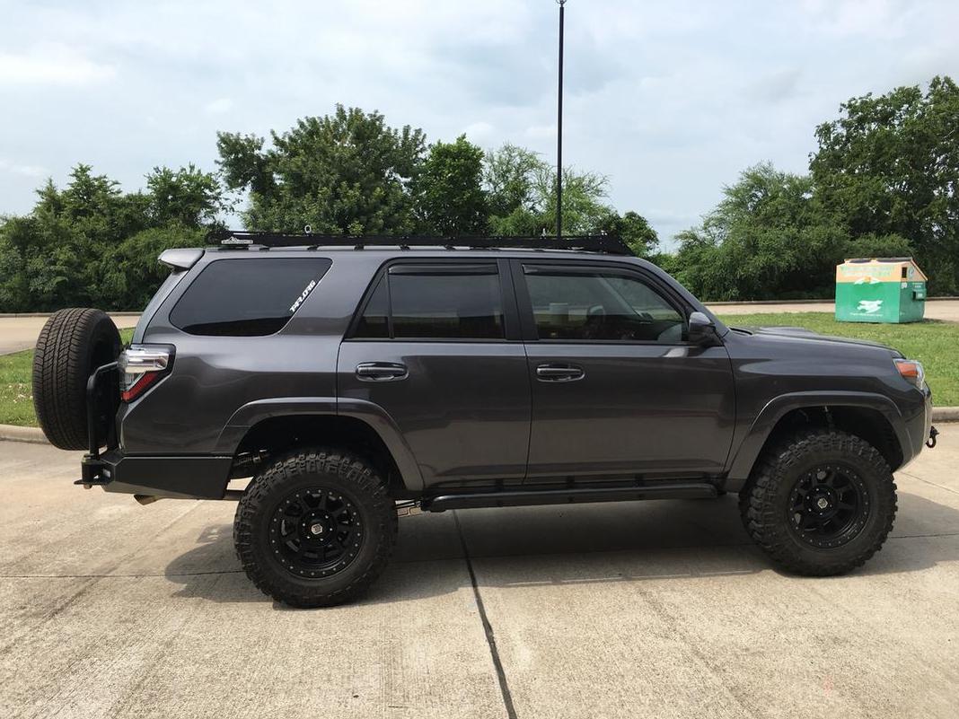

i have the icon's regular springs on with shrockworks rear bumper with the tire and carrier on and it sits pretty leveled on mine maybe a slight rake, i also have about 120lbs worth of winch and sss bumper on the front.
