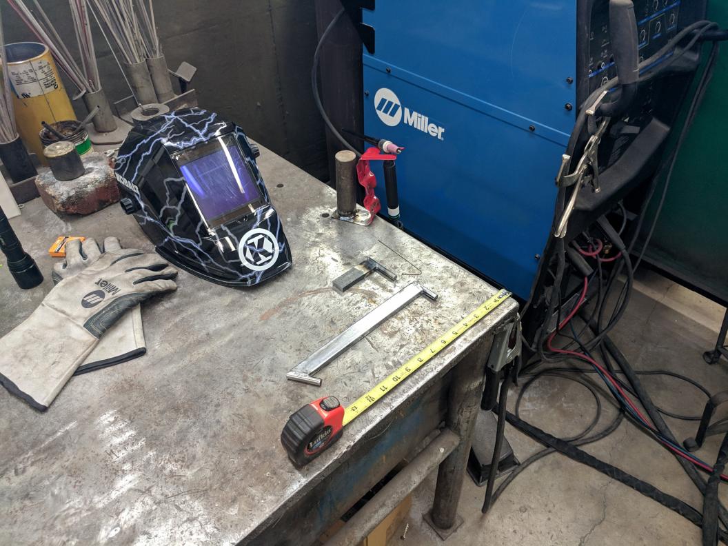

Hey guys, thanks for the alternative ideas. Online reviews of the Icon wrench weren't very promising so I made one in my shop. The 3/8" pins are 2" long. Tig welded to a 10" long by 3/8" thick steel handle. I'll try them out this weekend after I install the IVD coilovers.

I'm not sure i see how this is going to work with the 3/8" pins in that orientation to the handle. Would your fender well not get in the way when trying to put the pins into the coilover to adjust? I have to use the non hooked end of my icon spanner wrench for that exact issue. Maybe i am just looking at the picture wrong. :shrug:
