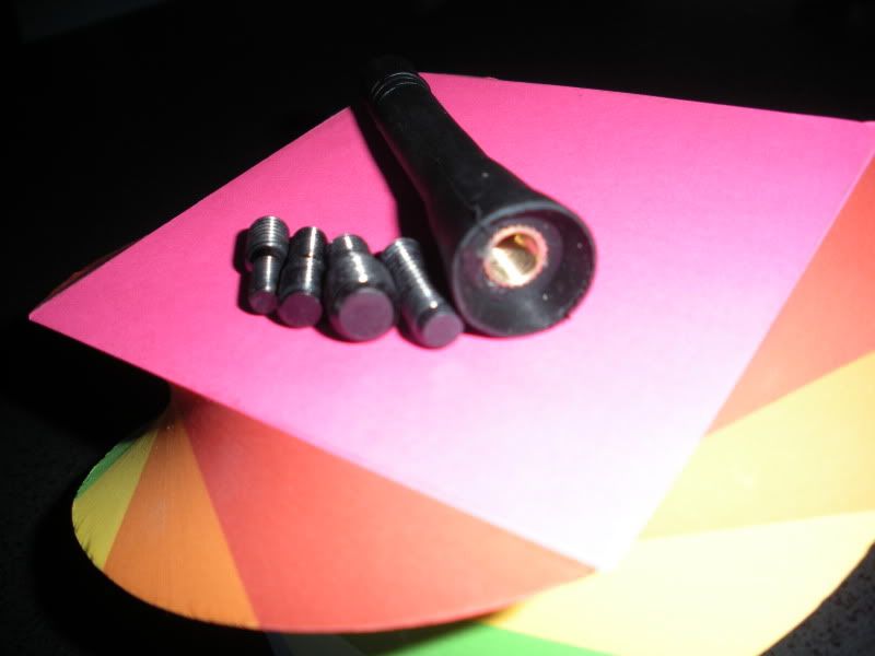

no modifications necessary. they include 4 or 5 different sized mounting studs to fit a wide range of antenna base applications. just screws on from there.
Hey all I just received my mangowalk stubby and it will need to be modified to fit much like the S2k antenna. It came with 4 different sized mounting studs and none of them are long enough. So Im headed to the drawing board lol

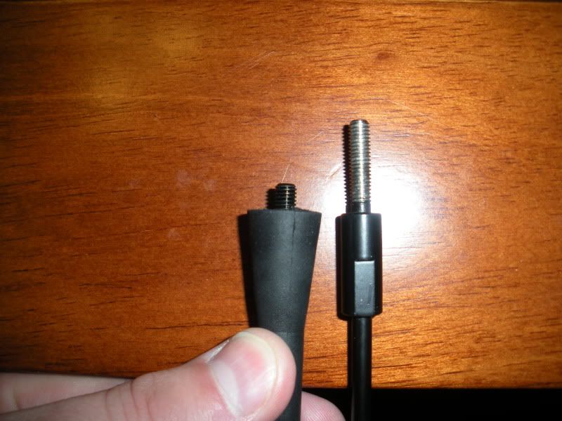

Yes it will need a mod of some sort. The threaded stud just isn't long enough. here is a pic of the factory mast and the length of the stud that comes with the stubby.
Can the supplied stud simply be replaced with a longer one? That would be a lot easier than adding all of the adaptations necessary with the S2000 antenna.
[/QUOTE]Can the supplied stud simply be replaced with a longer one? That would be a lot easier than adding all of the adaptations necessary with the S2000 antenna.[/QUOTE]
The problem is the stud is a different diameter on each end and a new stud would have to be made. The stud on the left is the one that would fit if it were longer.

This is the reply that I got back from Mangowalk when I sent them a message this evening about the length of the stud being too short for the T4R replacement antenna. I had ordered the 5" antenna (most of you have ordered the 3" one, I think) and it should arrive tomorrow. I had hoped that they might be able to supply a longer stud, if mine was not long enough!
"Thank you for contacting Mangowalk Customer Service.
The antenna mast included 4 studs, but we don't have anything longer
than those.
We saw that post lately and we don't know how he, fins, made it works.
Did he make his own studs? Maybe it's better if we can ask him for an
answer."

Hey, sorry guys. Just getting time to get on the forum. I received mine today. None of the studs would even screw into the base. ckon, were you able to screw yours in? I believe once it's in and tightened we wouldn't have any worries. I just can't get the stud to screw in.

No, I just took the adapted hardware off the S2000 antenna when I made the switch. The same problems with mounting the S2k exist with the 3" stubby and require the same modifications.
