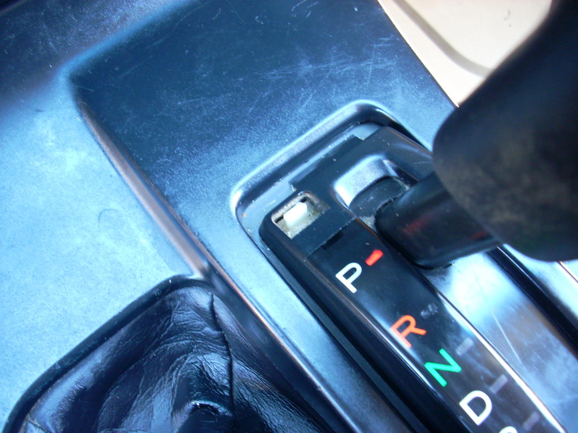

I seem to be missing a part of the shifter/console right above the park indicator, I'm not sure if its supposed to be a light or what not, any help, with possible P/N?
pic of console

its a little cover that you pop off to get your rig out of park if the brake switch fails. Press the button inside and it releases the shifter.
Cool, learn something new everyday thanks :)
I have to find that cover that goes over that, for some reason it bugs the hell out of me.
Yep it's a little black plastic cover. The carwash guys sucked mine up when they vacuumed my interior, didn't notice for a couple of days, so couldn't go back. Bought another at the dealer, don't remember exactly but it was expensive, like $20 bucks for it. About a month or so later it's missing again. Now I just put a piece of black electrical tape over it.
