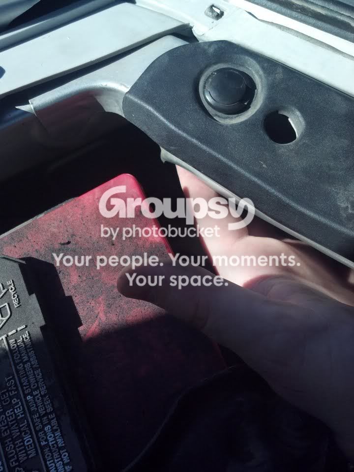

Anyone know the part # or bulb ID # for this little guy? Mine's out.
lens.jpg~original
Looks like i'll have to remove the battery to get to it.
A 168 bulb? So if i go to Auto Zone and look for this particular bulb, then # is 168? Mine's yellow/amber for an 03' SE V8.
For me NOT to take out the battery, id need the hands of a 5 yr old.
how big of a battery do you have? haha jk. yes the # is 168. they have them at any walmart or autozone or anything with auto lights, they are quite common. im going to run down and look at it again... maybe i just have small hands.

Yeah, that upper-outer corner is blocked by the battery. Its gonna have to come out.

I dont think i could get my hand in there AND twist that connector in and out of the light housing.
I'll give it a shot tho.

THAT....was a PAIN in the REAR END!!
Had to take the battery out to get to the one on the driver's side, but that wasnt the trouble. What did give me issues was the angle the bulb-sleeve is at, and i had to contort my arm to get in there, and then turn it counter-clockwise WITHOUT BREAKING IT....that sucked.
