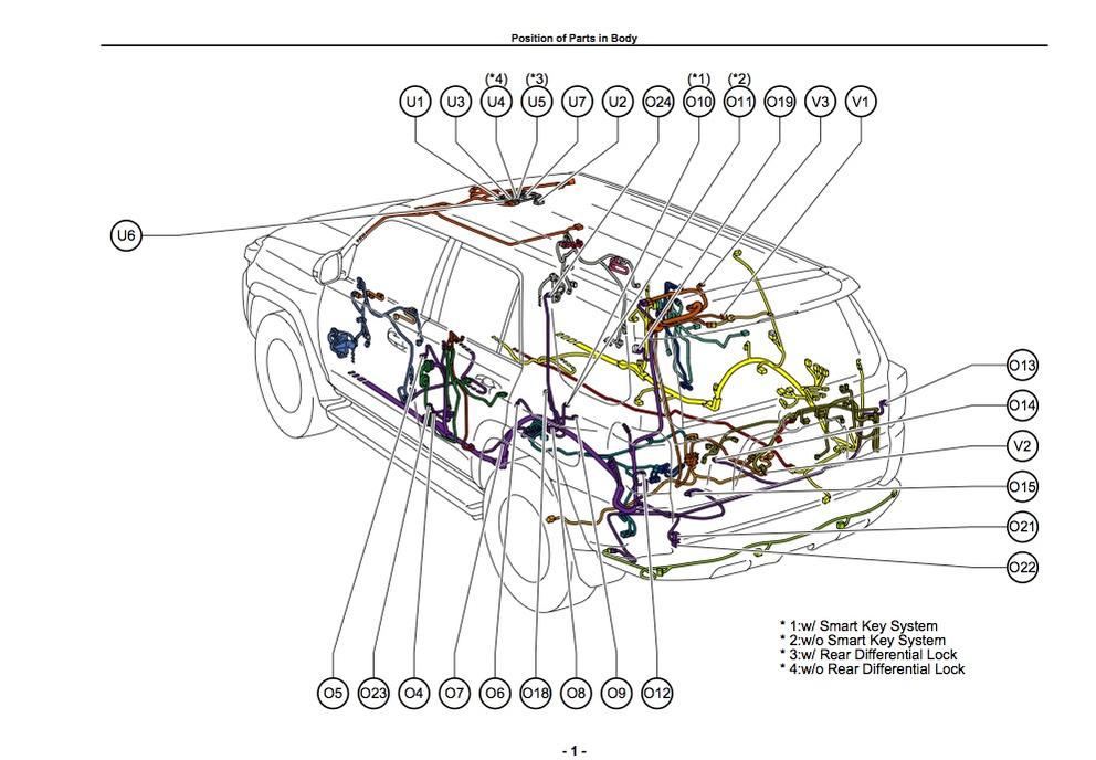

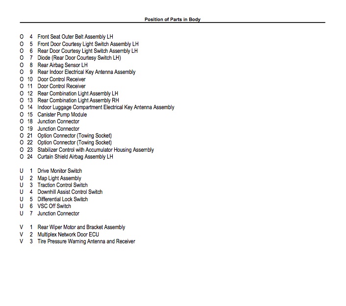

I'm not 100% sure, but it looks like it could be O14; "Indoor Luggage Compartment Electrical Key Antenna Assembly"
This is what the plug will look like if it's this...
No problem covering it up from a safety standpoint.

Looks to be an antenna for the keyless entry and/or smart key. Should be okay if you cover it with wood, but it may reduce/impede performance of the antennae pick-up range.
When I removed my 3rd row seats to make a storage area I also wondered what this part was. I made a metal cover to protect it from getting damaged. I also insulated the area, stored crap on top of it and have a plywood cover over the storage area with the factory carpet pad and a huskyliner. My smart key system seems to work just as well as it did when the seats were installed.
