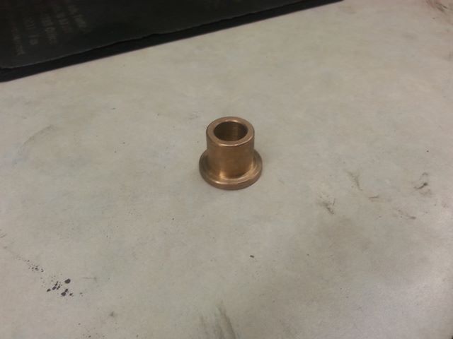

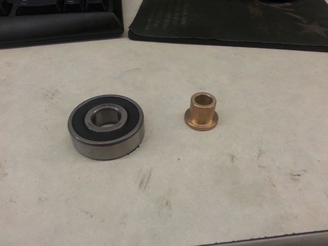

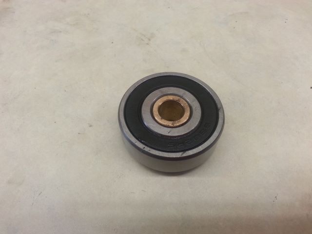

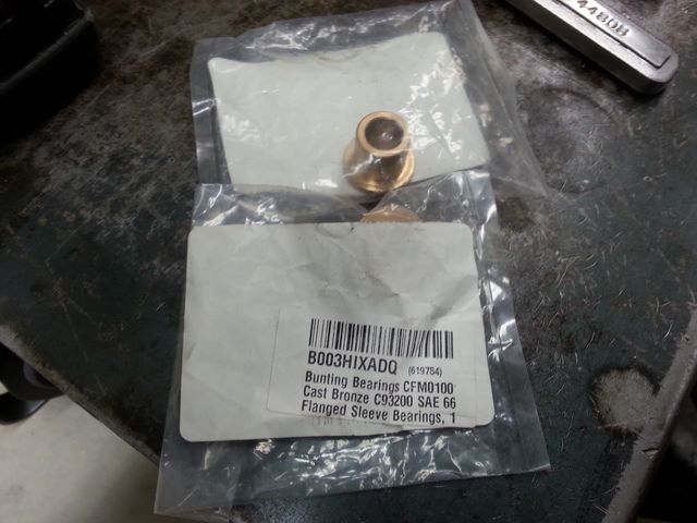

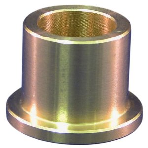

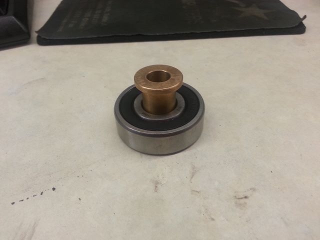

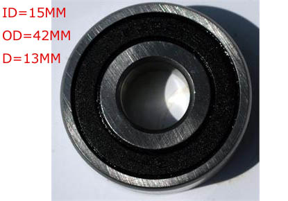

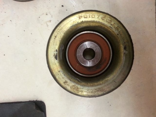

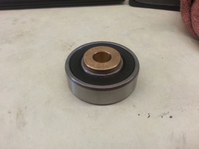

So i ran into a little problem, the stock 6302RMX bearing have a 42mm OD and a 10mm ID. the bearings i ordered were 6302-2RS bearings which have a 42mm OD and a 15mm ID. Apparently you can't buy the 6302RMX bearings because they were a custom bearing for toyota. so i came up with a solution to this problem, I found a 15mm OD with a 10mm ID bearing sleeve on amazon for $4.76. They are made by Bunting Bearings and the part number is CFM010015016. So i ordered three of those and they should be here thursday. I will keep you guys posted on this.
Read #6 post before ordering anything because the No. 1 Idler Pulley and the No. 2 Idler Pulley are different
Bearing Sleeve
6302-2RS Bearing
Stock 6302RMX Bearing

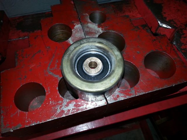

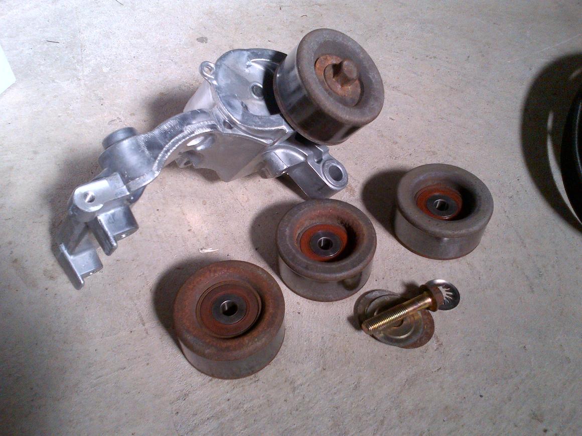

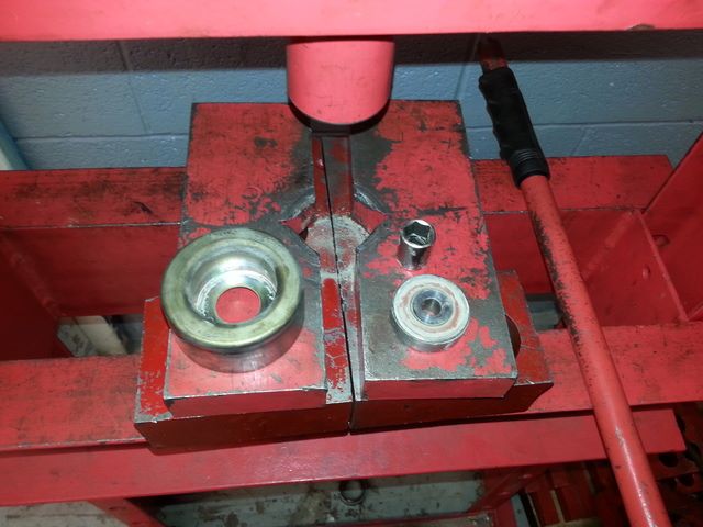

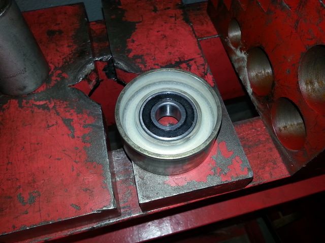

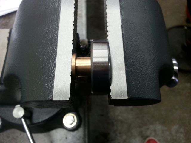

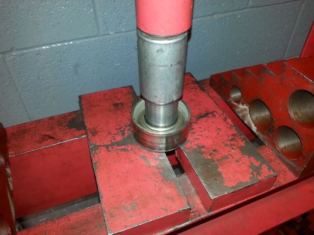

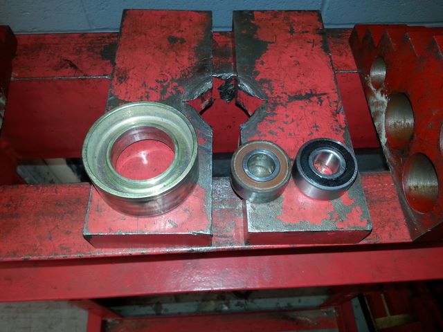

So I finally got all the parts I needed to swap the bearings in the idler pulleys and belt tensioner. Here are some photos of the process of the bearing swap.
Idler Pulley bearing removal and install
Continued....

The only issue I ran into when I was replacing the bearings was with the Idler No. 1 pulley, the difference between the No. 1 and No. 2 pulleys is that the No. 2 pulleys have 1 bearing compared to the No. 1 pulley which has 2 bearing in it. I didn't replace the Idler No. 1 yet, because it was still in good condition and I didn't feel like it was necessary to replace it yet. The only problem with replacing the No. 1 idler bearings is that you can't use the bearing sleeve that was used for the No. 2 idlers pulleys because they aren't long enough to go through both of the bearings because it has two bearings in it. A solution to that would be just to remove the flange on one of the bearing sleeves and use a flanged sleeve on the outer bearing and the non-sleeved bearing on the inner bearing.
