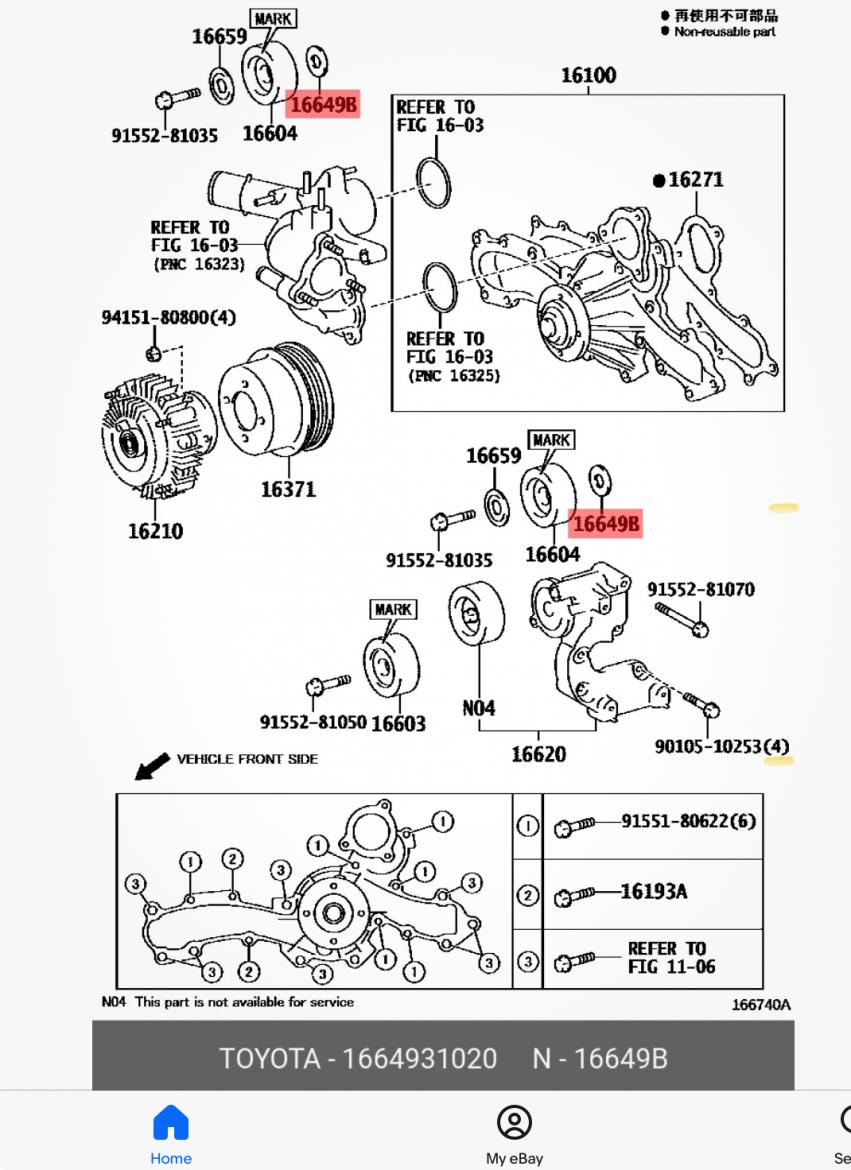

Belt Tensioner Kit 16620-31013 7PK2120 For Toyota Tacoma 4Runner 2005-2015 4.0L | eBay
Ordered the inner and outer plates in case I need them.
Part No.: 16649-31020
2x - PLATE, IDLER PULLEY.
Part No.: 16659-AD010
3x - PLATE, IDLER PULLEY
I’ll give an update when I get them installed
Back plate
PLATE, IDLER PULLEY
Front plate
PLATE, IDLER PULLEY
This package worked great along with the plates.
