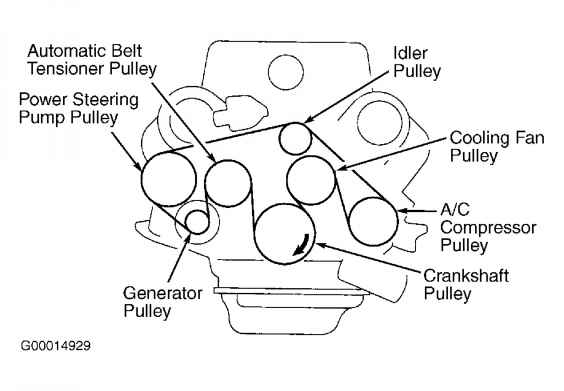

I used the Napa pulleys since they are sealed and I’ve heard they hold up better in water.
The V8 uses:
1 idler pulley: Dayco 89154; Toyota 16604-50030
1 Tensioner/pulley: Dayco 89255; Toyota 16620-0W101 (reverse thread pulley bolt :keyboard: )
belt tensioner pulley

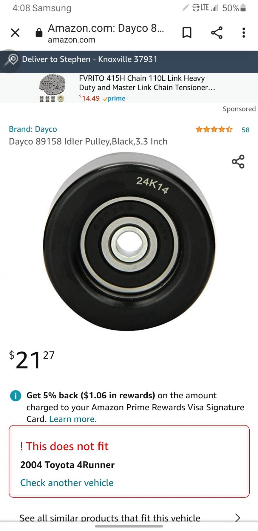

Hi guys. When I check on amazon. This part I need 2 of is saying this doesnt not fit the 04 4runner v6. Is this just an error on Amazon? I will order them if you guys say it is in fact the correct part. Thanks
I think I attached the photo correctly

I can't say for the V6 if that's the correct pulley or not, I don't have the V6 engine, BUT I would highly suggest you get a tape measure and try and get a measurement of the pulleys on your engine, the reason I say this is because I have the V8 and for the 2004 year model the V8 came with different size pulleys depending on when it was manufactured, later 2004 V8s had a smaller pulley than the earlier 2004 V8s.

Check Rockauto to confirm your part #s. Usually a little cheaper than Amazon too after the 5% discount code found everywhere. FYI, you might save a few bucks with Dayco but odds are that it won't last you even half as long as a Gates. All the gates pullies and tensioners I've seen were made in Canada by OEM maker Litens and used the OEM NTN bearings. Even the older US made Daycos I've seen used cheap Chinese bearings
Thanks guys.
I ended up buying the whole set from RockAuto. I went with Gates. After talking to advanced, they are pretty clueless on which pulley may be for which pulley. So I gave up on them and at $60 per pulley, forget that.
All 4 pulleys with the tensioner and a new belt at 180 something. Itll do the ol girl some good

Does anyone know what position the Under Idler No. 2 pully (upper) is supposed to be in? I replaced my alternator and when i installed the Idler No 2 back on when you tighten the bolt the thing moves 360' in every direction.
Am i supposed to push the pully down on the belt or just let it rest against the belt? I just tightened the bolt and let it sit in whatever position it wanted to. Should the belt be turning the Idler pully or just skim across it?
Thanks for the help!
UPDATE: It looks like im missing the little center insert thingy that the bolt goes through. Am I wrong? My Idler pully next to the alternator has no center piece. Is that why the wheel is moving 360' degrees in all directions? Looks like I answered my own question which is depressing. now I gotta wonder if any other pullys have missing hardware.
Does anyone know what position the Under Idler No. 2 pully is supposed to be in? I replaced my alternator and when i installed the Idler No 2 back on when you tighten the bolt the thing moves 360' in every direction.
UPDATE: It looks like im missing the little center insert thingy that the bolt goes through. Am I wrong? Mine Idler pully next to the alternator has no center piece. Is that why the wheel is moving 360' degrees in all directions? Looks like I answered my own question which is depressing. now I gotta wonder if any other pullys have missing hardware.
Im not quite sure. The belt diagram is under the hood.
This video does a pretty good explanation of the pulleys and belt path. Go to 10:50 and watch. Hopefully thatll answer your questions
