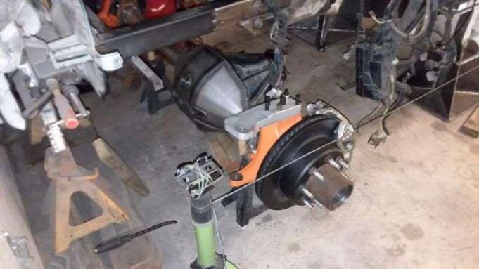

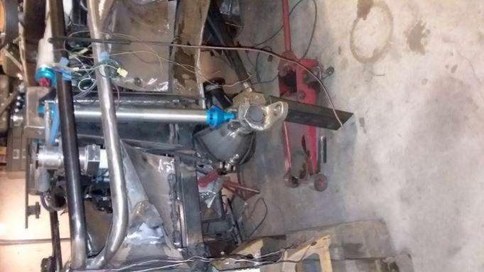

I am getting close to finishing up the sas on my truck. I decided to go all out and imo do it right by redoing both the front and rear suspension. I kinda went down the rabbit hole of no cutting corners on it while keeping it toyota based. But between all the parts alone I am at least 15k deep. If I start adding up all the other stuff I did to make the sas better, turbo, standalone ecu, etc I would be well over 25k into it i think. Ive done all the labor myself. What I went with was a LC 9.5 axle in the rear and a HP 8". Coilovers front and rear and all the bells and whistles.
I just sourced a HP 44. It has 8 Lug outers so now I'm working on gathering parts still.
I'm in Billings and am looking for IFS Lift Suspension parts for now. Do you have Coils or your take off stuff you want to get rid of? I won't SAS until I have everything ready to go, that may be awhile. haha
Only thing I have left from the ifs at this point is a set of gusseted spindles and 4 spare cvs. CVS I'm selling for 40 a piece. Spindles 100 for the set. I'm over in Billings fairly often so it wouldn't be a big deal to bring anything with me if you're interested
Re reading your original post too that high pinion 44 will be able to be built plenty strong, especially if the truck is primarily used in the snow and mud. The smaller diff will also make your life way easier when you're chasing up travel and a low ride height.
