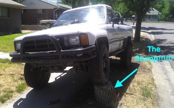

It is a JD Fab kit that I get 12.5" of travel with the straps and bumpstops, I built it to go fast - with the 3.0 I don't want/need to slow down for big bumps :) - It has T100 axles like most of the long travel stuff on them. ARBs front and rear, The winch is in a custom made cradle so it can be moved to the rear, IR headlight for night ops :P.

nothing wrong with the 3.0 i can go pretty fast in mine. i can cruise at 75+ and have no problems passing cars. plus im auto!!
i havent figured out how much travel i get out of my Blazeland yet. im sure im not getting the full travel since im running stock locations for shocks. i have tons of droop and i should get just as much compressing but the shocks will bottom out.
I think your limiting factor will be your factory bumpstops, you could remove the rubber bumper or better yet just shear some off.
I cut mine of completely to get to where I am at and am only running a 8" shock. It will do 13.125" but I don't want to be running against the shock for the stops.
i already have low profile bumps. the problem is finding a stock the will fit in the stock location that will extend and compress the amount i want. the old shock i had allowed me to compress to the low profile bumps but limited my droop. my new shocks allowed more droop but fell short at hitting the bumps on compression. thats why if i cut the upper shock mount off and extend it up more. i can get the most out of my new shock. its the only way imo
