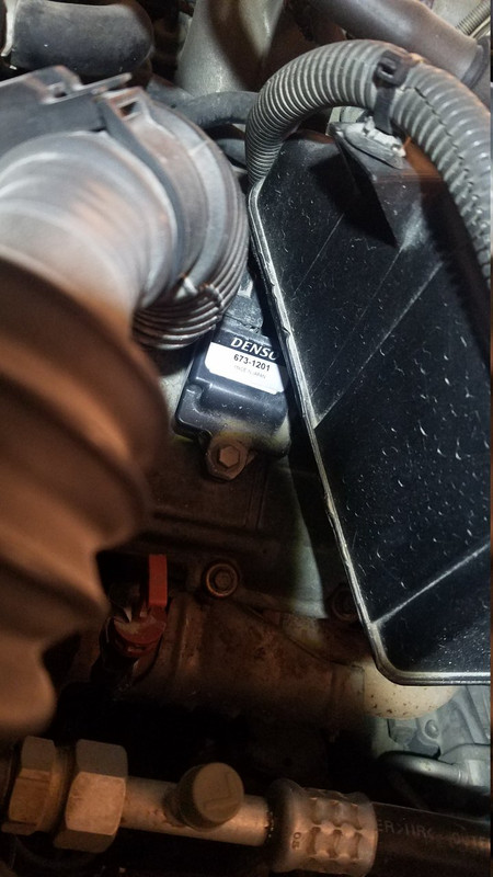

Denso coils (673-1201) are $53 ea @ Rock Auto & Amazon
Wondering if I should just refresh it all... Plugs, wires, coils (oh my)

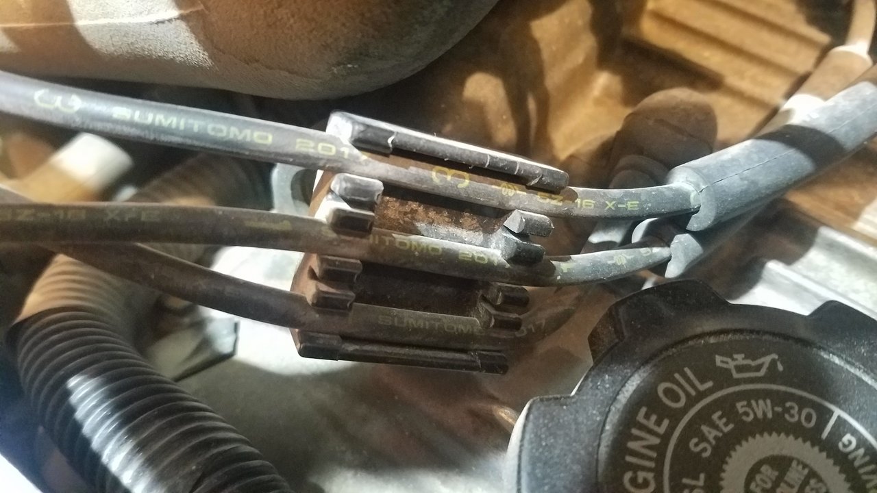

Factory wires were Sumitomo (according to The Durk on another thread)

I’d just replace the coil boots unless you’re having an issue, I don’t think these coil packs really soft fail like on some vehicles, that is where you have degraded performance from old coils.
I didn't know they were so cheap, I thought the coils were a lot more expensive honestly. I thought about doing them last time I did plugs but just went with new coil boots instead because those are really cheap. Now that I know all 3 Denso coils could be had for about $150 though I may replace them on my next spark plug change because that will be north of 300k+ miles and I'm big on preventative maintenance like that.
That said, I've never really heard of people having issues with them so I'm sure you'd be fine to keep using the original ones like I did. I may also buy just one and throw it in with my spare parts/tools so incase one does go bad I can swap it out while on the road/trail.

I like oem Denso full array for longevity. Like others said, coil boots are a must, Denso is cheap on Rock Auto. Coils will very rarely fail, you can get a million miles on them, but fresh coil boots are a must on every plug wire replacement.

I also replaced all the coil packs with Denso for no particular reason other than one of them had blue corrosion on the connector that I couldn't fully clean off and I like to just preemptively replace stuff that I'm suspicious of or will have to be replaced one day anyway. It's nice having all OEM because it's one less variable to wonder about with diagnosing things, compatibility, longevity. This 4runner is quite literally the best consumer purchase I ever made so I don't feel guilty about spending extra on OEM parts.

I've had 1 coil go bad in 22 yrs. 2 different Runners around 600k mi.
Coil on the shelf 10 yrs. from chasing a rabbit that ended being a bad wire.

198k mi 01 Runner I bought in 17 dealer serviced had Sumitomo wires.
