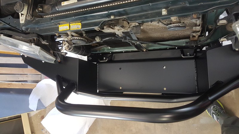

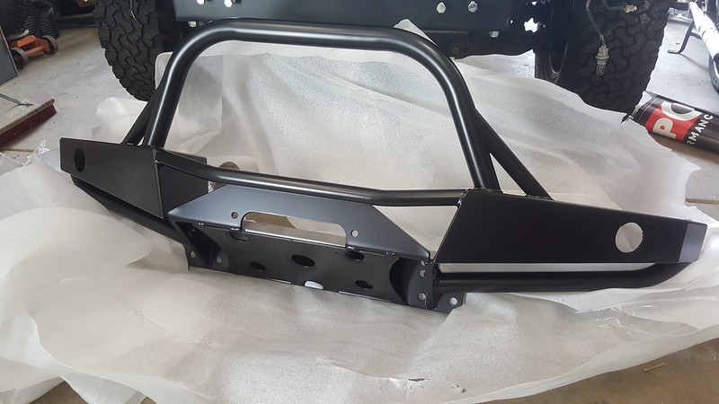

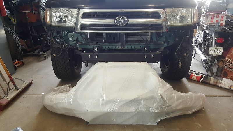

Got the Addicted Offroad bumper mount primed and painted and installed. I decided to have the bumper powder coated, so hopefully it'll be done by the end of this week! VERY excited to get that bad boy on there.

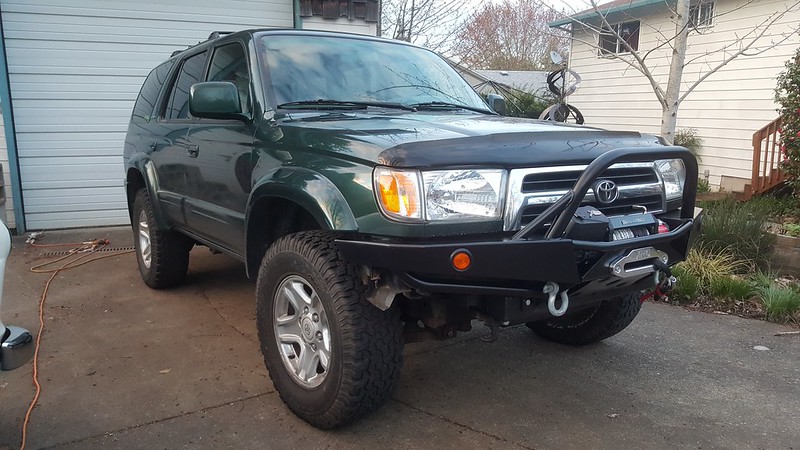

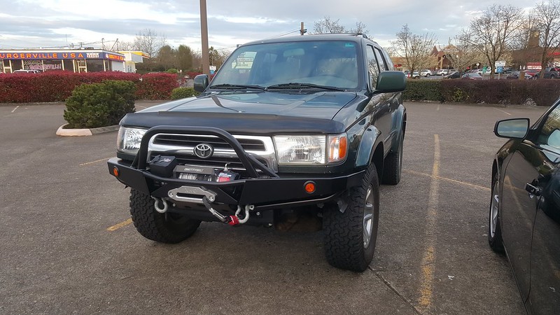

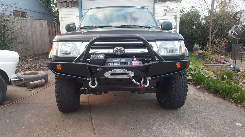

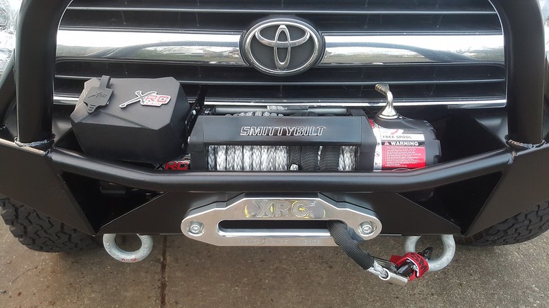

I got my bumper back from the powedercoater. Turned out great! The Smittybuilt 9500 XRC mounted nicely in it, although I had to trim a bit of the bottom of the grill to get it back on.

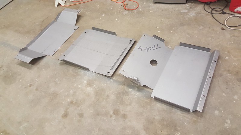

Skids and sliders are next.

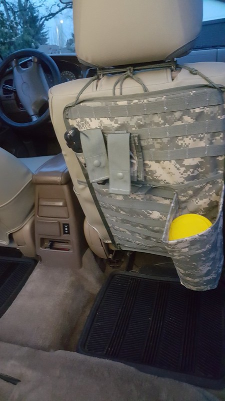

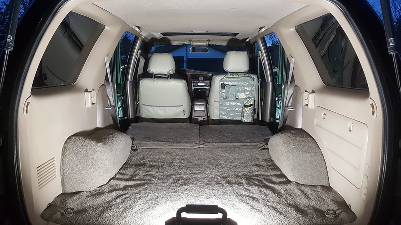

I also ordered a MOLLE seatback military storage thing off Ebay to help organize accessories, and I reinstalled my carpet.

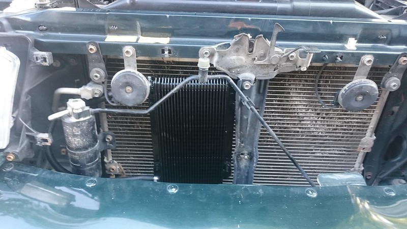

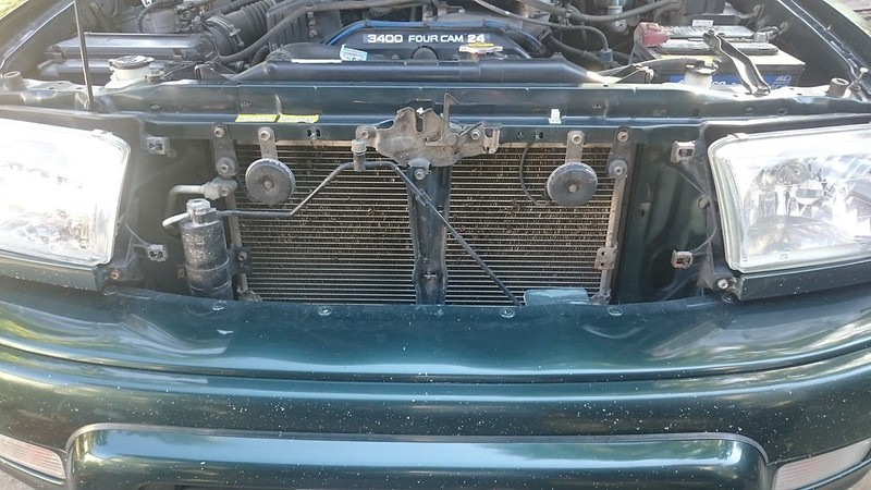

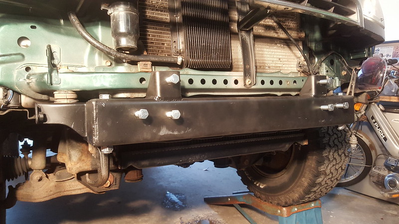

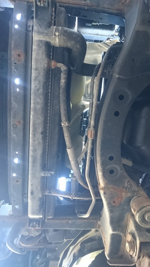

I just did the B&M Tranny Cooler upgrade. It took about 2 hours, and was very straight forward thanks to the excellent write ups on this forum.
-Removed Grill, removed skids, removed old hoses (hardest part, I cut them off), attached cooler, ran new hoses, topped off ATF.
