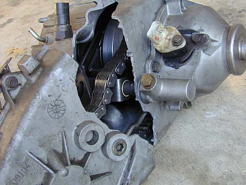

No. The correct answer is ....
1) don't engage on pavement, ever.
2) your front diff and transfer case will be damaged, costing you thousands of dollars.
3) read the owners manual. There are on a few pages that cover when to engage 4WD.
Read this ----> http://www.4x4abc.com/4WD101/axle-wind-up.html
