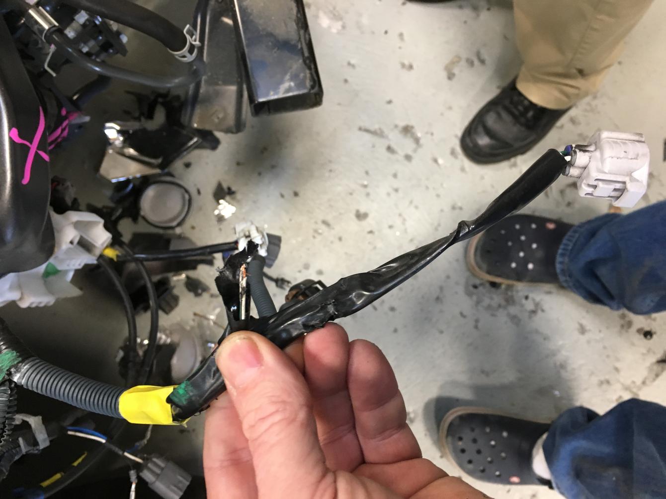

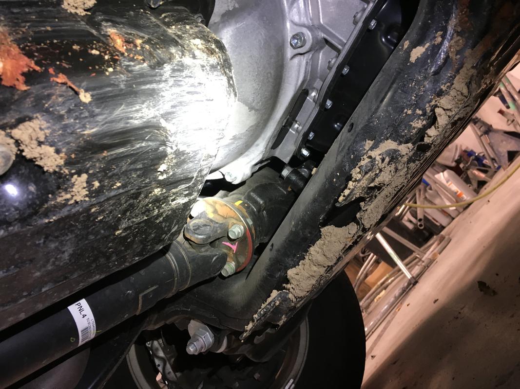

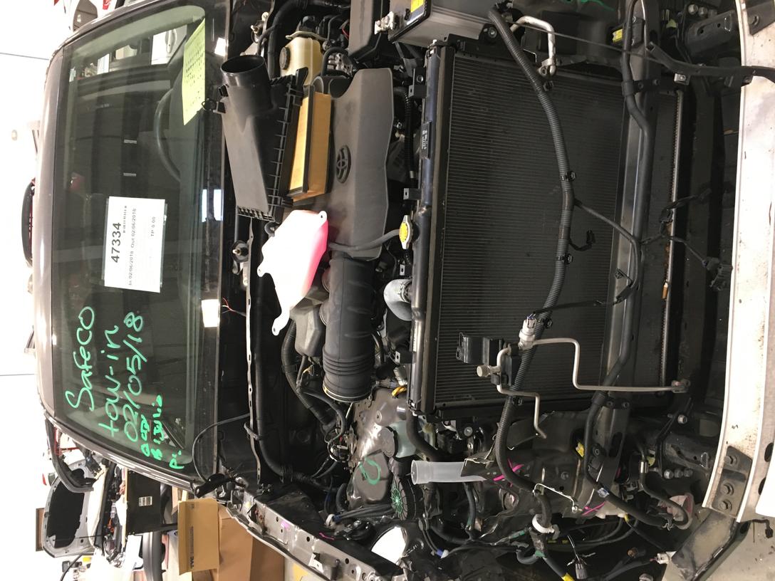

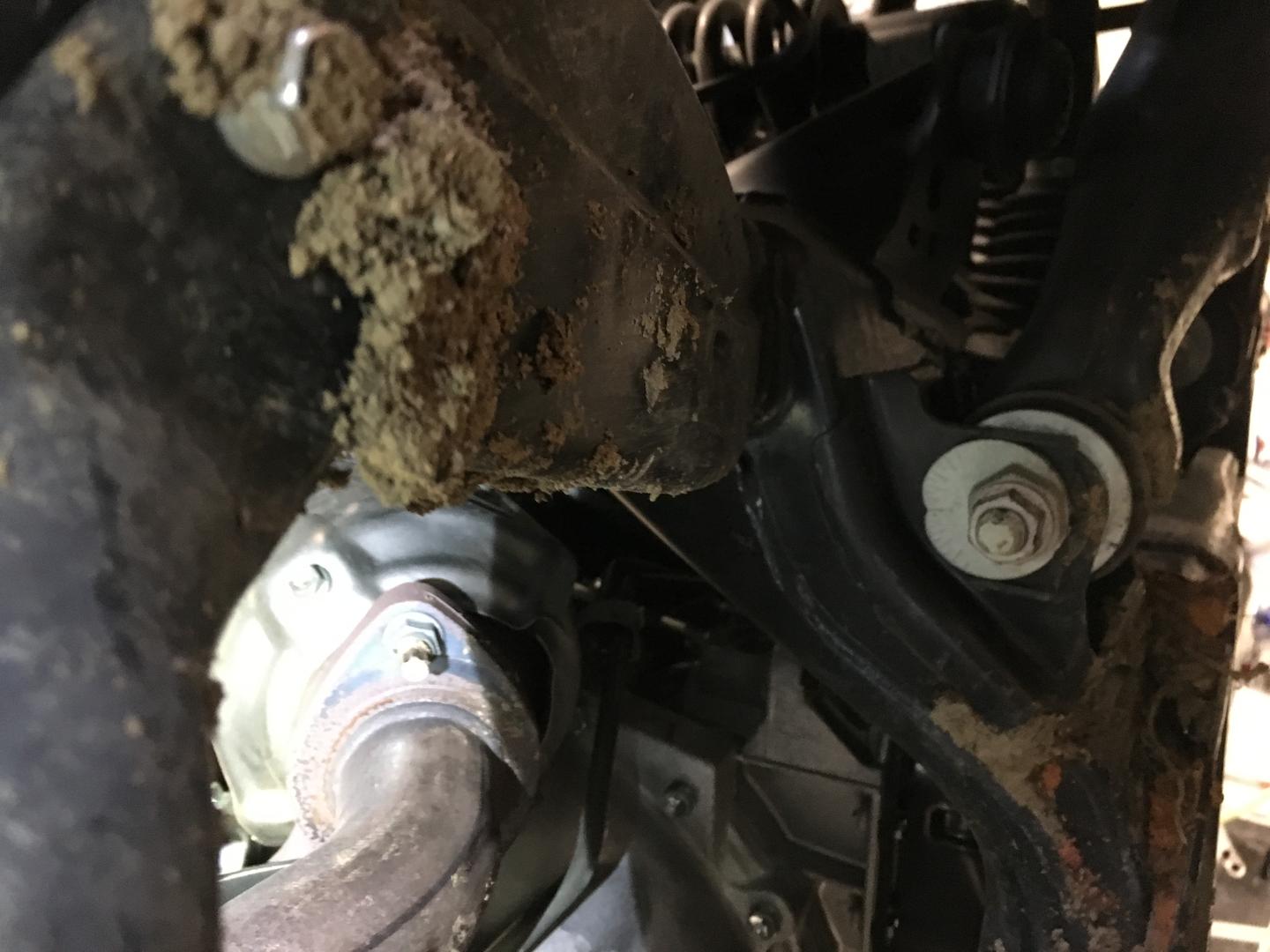

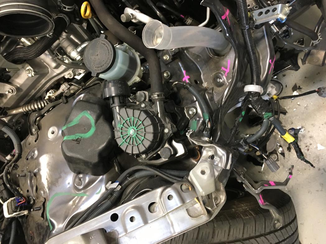

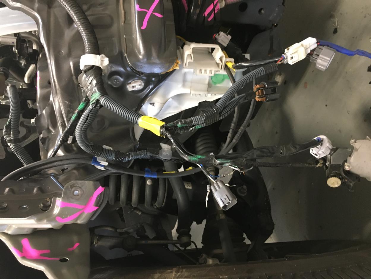

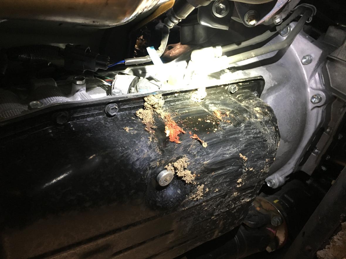

Well went out to shop today to look at tear down. Took a buddy from work who was ASE guy for first career before coming to work on the trains.
Estimate went from 8,600 to 18,200 without going up on the lift. Bottom of transmission was in contact with tree, wood everywhere from lower control arm to transmission pan. None of that was included in supplemental.
Dash has to come out to replace heater core as line was pinched and damaged. Wiring harness got yanked, six plugs pulled out it it, bare wire and make spades pulled through connectors. They want to splice in new connectors because a new harness is 2,900 and splicing is 60 bucks or something.
Both fenders and whole front damaged. Shop has spec’d out a lot of aftermarket parts and some salvage (small low dollar parts). Traction Control light on. Air pump cracked. 17 pages
Some concern about losing the remainder of my factory warranty and there are a lot of warning signs in the estimate about it. Anyway that’s another discussion. I’ll post up some pics if my iPhone will let me.

the cost is body damage of $18K so then the drive train will most likely have problems .. toyota parts are expensive so I would not do the fix should be totaled with those pictures .
most all the time a front end collision and the lack of a steel bumper and steel member support , these are costly to repair . warranty will be gone.

Just buy the new harness, they do many other friggin parts to order. I would fight it out. Maybe they end up totaling it if you are a big enough pain in the ass.
Once warranty is up your stuck...so all new or walk. That’s a 2015? Sr5? It’s a truck worth 25k on the used market??, why would the insurance company bother to fix it?

I went to Toyota’s certified collision center after the tear down, showed them the pics and they said totaled was probable. I did get their paper on warranty transfer if repairs done at Toyota.

As far as the damage to the wiring - ref pics in posts 67 & 68. They show pics of damaged wiring and connectors with pins pulled out and bent. This is clear indication that at least some of that wiring was stretched and some of the insulation was scrapped off. The question is how many other places have damage that can't be seen. Sure those connectors can be replaced as long as you have a guy that knows how to properly re-terminate and crimp new pins on and reseat them correctly into new connectors. Then it should all be rung out (continunity check) to verify proper readings.
The chances for future electrical problems is high with this type of repair. The best way is to replace all damaged wire harnesses with new. Then youre main worry would be that all connectors were seated properly. One question is what warranty comes with this type of repair? If you get like 90 days then push for new wire harnesses not repaired ones.

Anyway I've been through the supplemental quote and looked at what the repair company proposes. A few interesting things come up.
California gives leeway to insurers to use aftermarket and otherwise salvage parts as long as they are certified to meet OEM standards. I have yet to find any aftermarket/refurbish place that states that in their guarantee - and I have the list. The insurance company does not even state it. I suspect most people don't even look;
1). Wiring Harness. They state the new harness is 2,900. I see from Toyota links that price is about 1,000 high from a couple Toyota dealers. That said I see the Harness Repair Manual (pretty old) and it specifies testing. I will discuss with adjuster - I don't know how involved a harness replacement is.
2). Recon bumper cover. Local farm country place in Gilroy, CA. No website. No idea what they recondition and supply (e.g, it it a reconditioned OEM or a reconditioned aftermarket??). Not thrilled about this. New aftermarket - OK, used reconditioned who knows what - not so much interested.
3). Keystone out of Stockton, CA for sheet metal (hood fender, etc). There is a "HSS" designation I don't understand what that means. No OEM equiv. statement on their guarantee.
4). Crest Industries out of Fenton, MO. This is a fastener outfit. No idea on warranty as none is stated on their website. Overall not concerned. This is probably everybody's go to place.
5). All Star Auto Lights. 1 Year warranty. This is for headlight and fog light assy. Specified NSF, not OEM - but NSF is probably OK.
6). The pricing for the harness, hood and fender from aftermarket was higher than OEM Toyota using the prices from imtoyotaparts dot com and toyotapartsdeal dot com
