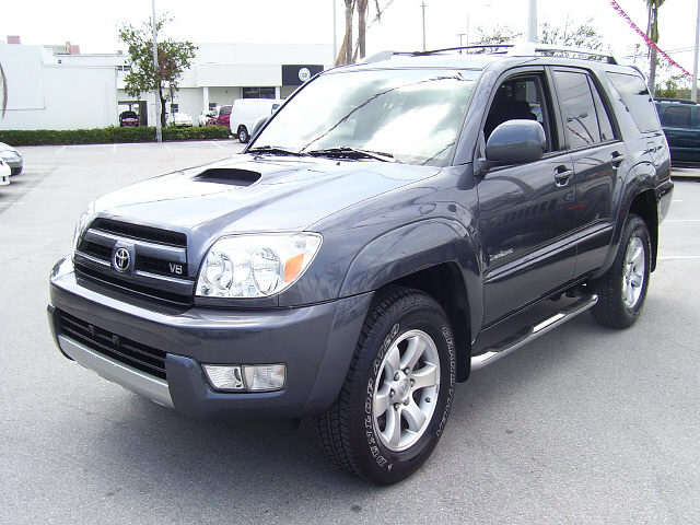

Here's a PIC of the 4runner im getting
What do ya'll think??

And I'm looking really hard, but don't think I see a 4WD emblem on the side of that 4Runner.
You're sure it's 4wd, right?:bugeye:
That settles the question then. Not all v-8 4runners are 4x4's. I know the Durango R/T only came in an AWD option so when I heard that all the 4Runner with the v-8's were 4x4's, my hope soared...so thanks for busting my bubble! I thought I was putting one over on the dealer...
By looking at the pic (and assuming it has not been partially debadged) it does look like a 2WD model. I don't see the 4WD badge either.

I like the sidesteps too, they look aftermarket as they are not OEM. Make sure you find out if it is 4x4 or not.
