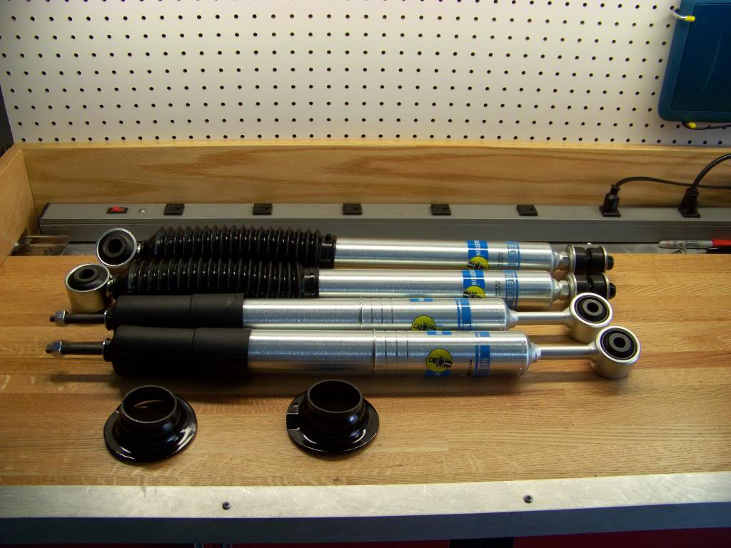

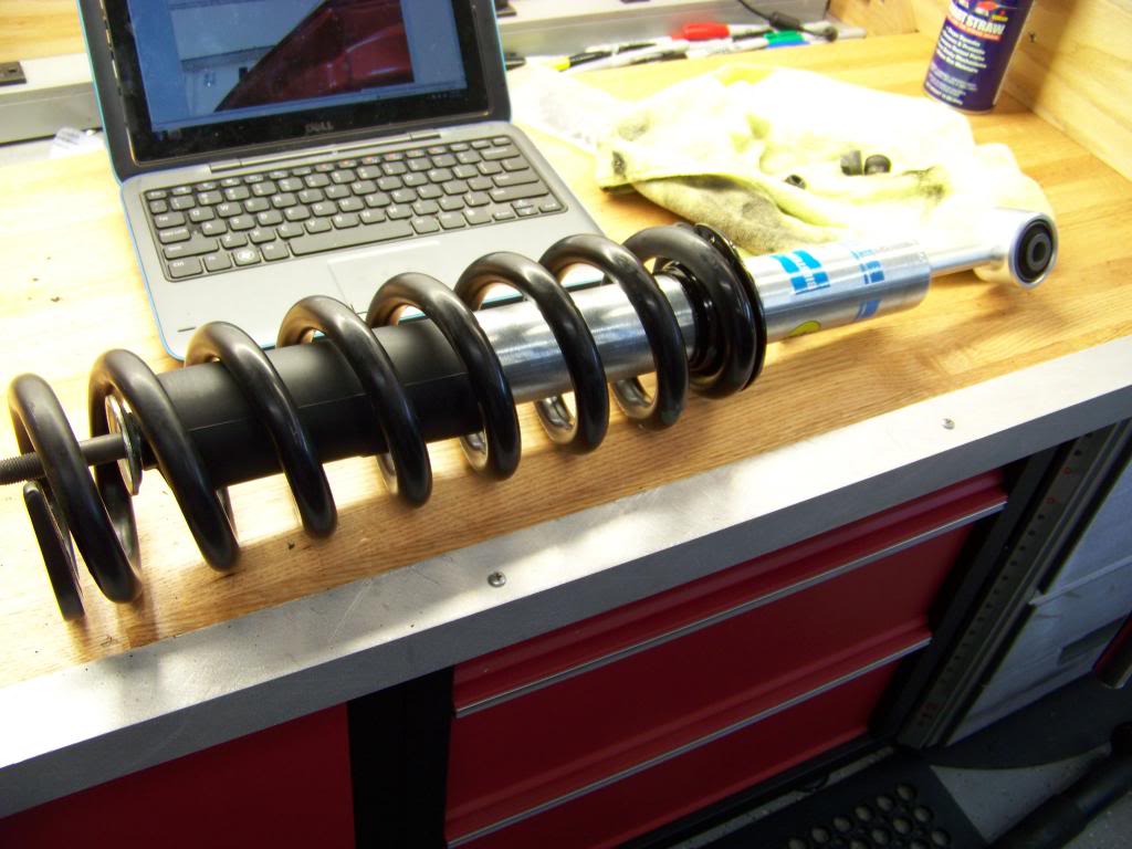

thanks for the heads up. After reading some of the threads, I'm still a bit confused when it comes to the bilsteins, coming from modifying cars, a height adjustment (lowering) came from compressing the coil over springs or simply installing lowering springs... i'm trying to figure out how the bilsteins adjust height... do the springs sit somewhere differently on the shock body as opposed to stock ones? Or do I need different springs too?! :wave:
You don't have to get new springs to get a lift with the bilsteins. Many do, but not required. Bilsteins in the front will lift using the factory springs, in the back you have to either get a spacer or new coils. Many simply level using the 1st setting on the bilsteins and nothing in back…others lift both front and rear which again requires either a rear spacer or new rear coils.
The spring perch is adjustable via a spring clip that fits into grooves on the shock. These pics show the clip in the 2.5" position which is what I'm running.
