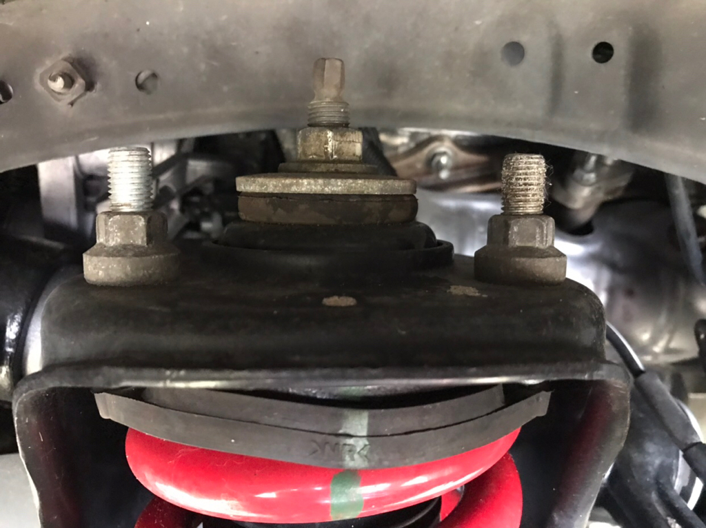

In an attempt to add some ground clearance and retain the Trd Pro suspension that I like I decided to install the Toytec spacer lift made for the Pro. It replaces the lower spring mount with a slightly thicker one and also a thicker top spacer.

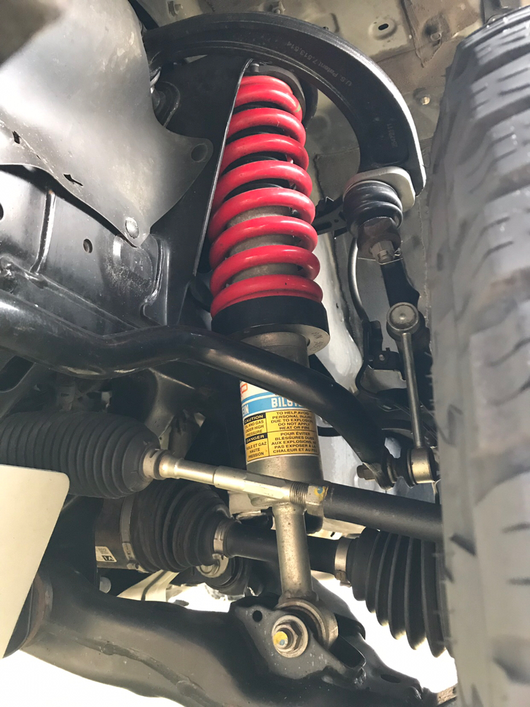

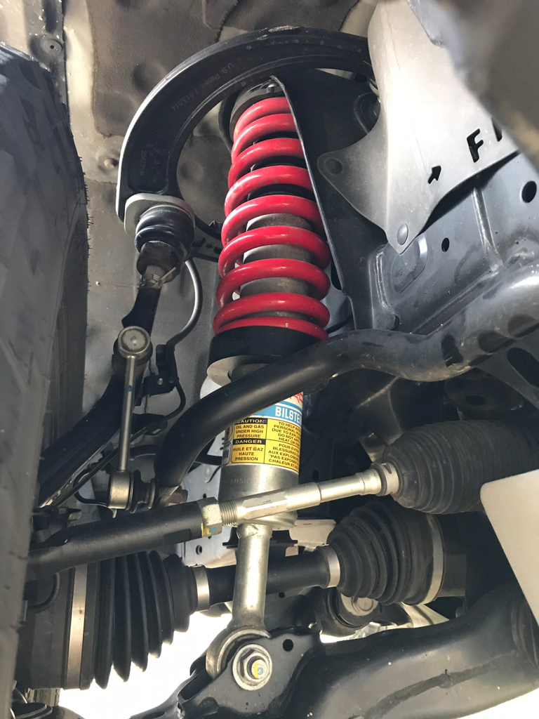

I now have a front end noise. I think it is my sway bar hitting either the strut or the radiator support.

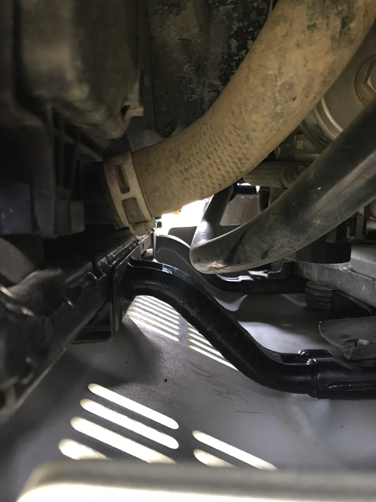

just take your skid pan off and look... youll know if it hitting as there wont be paint on the driver side (thats where mine was hitting).
Or just turn your wheel and with a flash light glance in.
If this is like other typical issues just go buy some large thick washers... Youll need 4. Undo the radiator support bracket (one on each side) and add the other washers to where the bracket meets the horizontal radiator cross member.

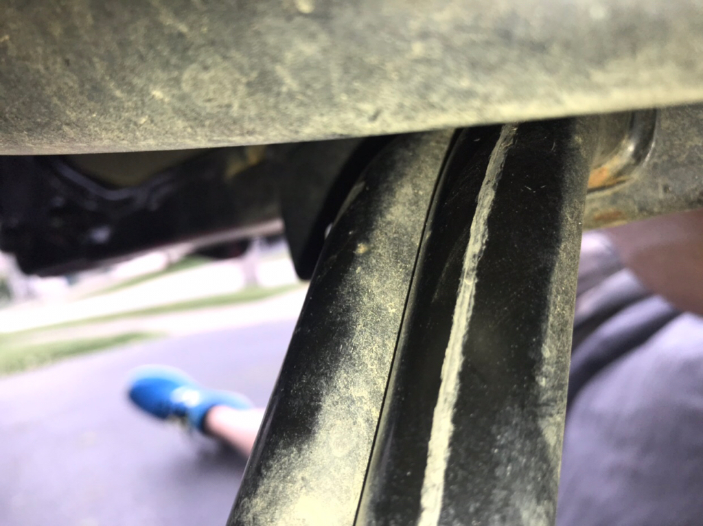

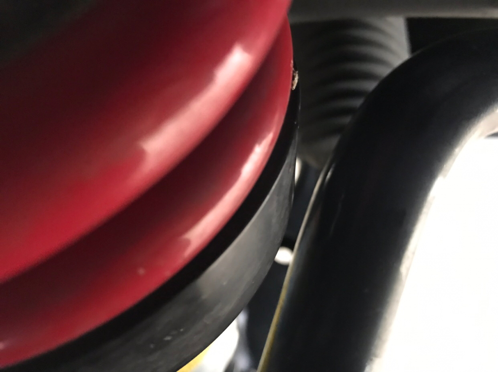

I dropped the skid and found this on drivers side support. But when the truck is parked it looks to have more than enough clearance. Does it really move that much?...
Although I added some grease to the support to see if it would transfer to the swaybar. It has not happened.
It definitely should not be hitting. Here is the link to the video of the lift if it was installed by a shop correctly. I havent heard the trd pro having this issue so please reach out to me with some more photos and I'll get down to the bottom of it for you.

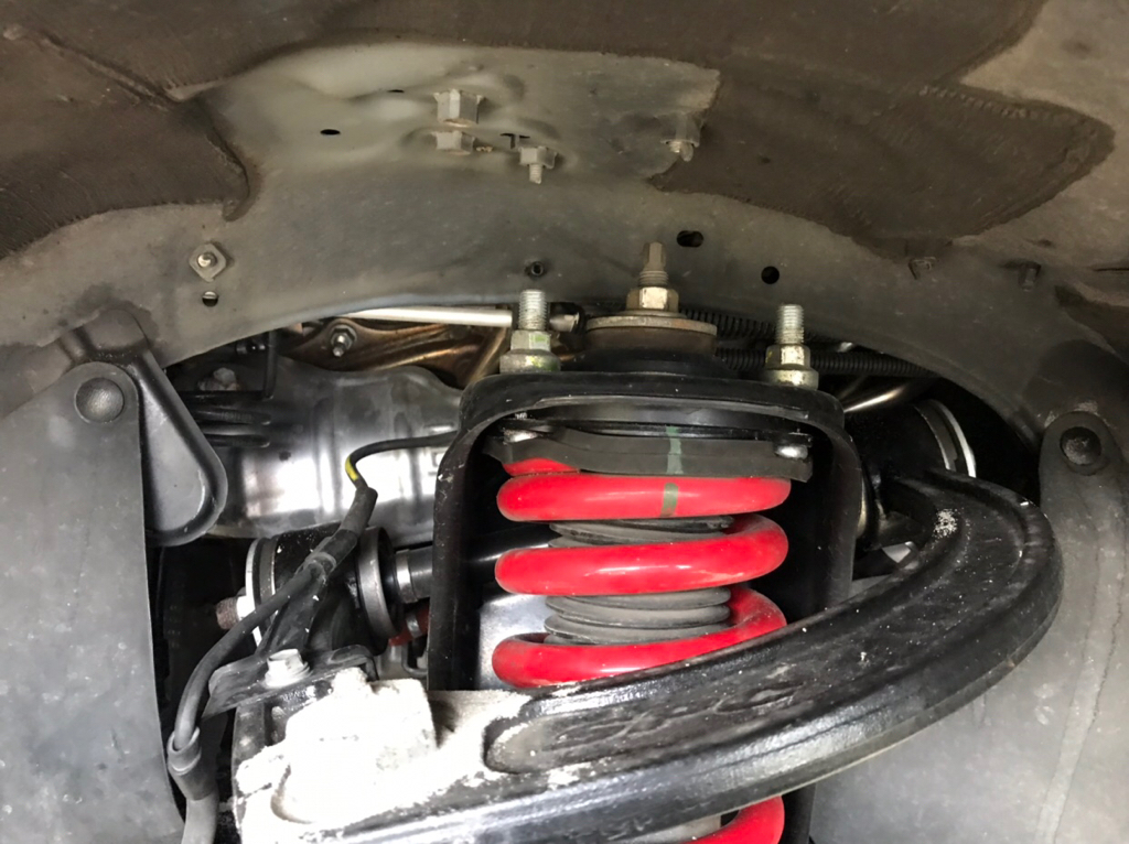

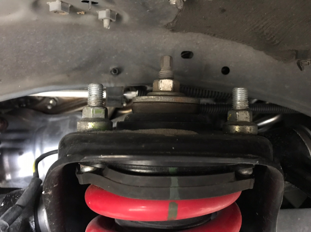

Something is not right so don't give up so quickly. That top isolator sure is sitting in there kind of funny.
