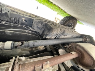

So this is what's confusing me. This is my drive shaft. It only has flanges that connects to the rear differential. The yoke or propeller that connects to the transmission spline is attached to the driveshaft by the u-joints.
The driveshafts I am seeing has flanges on each end. It seems that the yoke or propeller is separately sold and bolted on to the flange.
Is this the correct driveshaft? There are two different drawings. One with the two flanges then the second showing the yoke as connected to the u-joints.

This is where I am getting confused. Apologize upfront for the ignorance.
37140-60480 - Toyota Parts Deal
I gave you a link to what should be the correct drive shaft for your 2004 V8 2WD T4R, I also recommended that you contact whichever dealer you choose to purchase it from prior to ordering and give them your VIN number, most of the dealers also would rather you do this to insure you get the correct part for your vehicle.
That's the best I can help you because I haven't personally held all 4 of the different shafts in my hand, the one you posted isn't the correct shaft IMHO, I also have had trouble finding an actual photo of the correct shaft that looks the same as your photo, the best I could come up with is a photo of a used shaft on eBay that has the same part number as what I last posted for you, it also looks just like the one on your vehicle, flange with a u-joint on the rear and a yoke with a u-joint on the front.
Here's a link to the used eBay shaft, notice that they have the same part number in their listing that was in my last link....Drive Shaft - Toyota (37110-3D540)
Rear Drive Shaft 8 Cylinder 2WD Fits 03-09 4 RUNNER 37110-3D540 | eBay
BUT again PLEASE send in your VIN number to any dealer you choose to buy a new shaft from prior to placing the order, again this will not only insure you get the correct part, they should also tell you if they indeed have the part in stock and can ship it out quickly, many times they list parts like they have it sitting there ready to ship but sometimes they have to have it shipped in to them before they ship it to you, which can turn into weeks before you get it.
