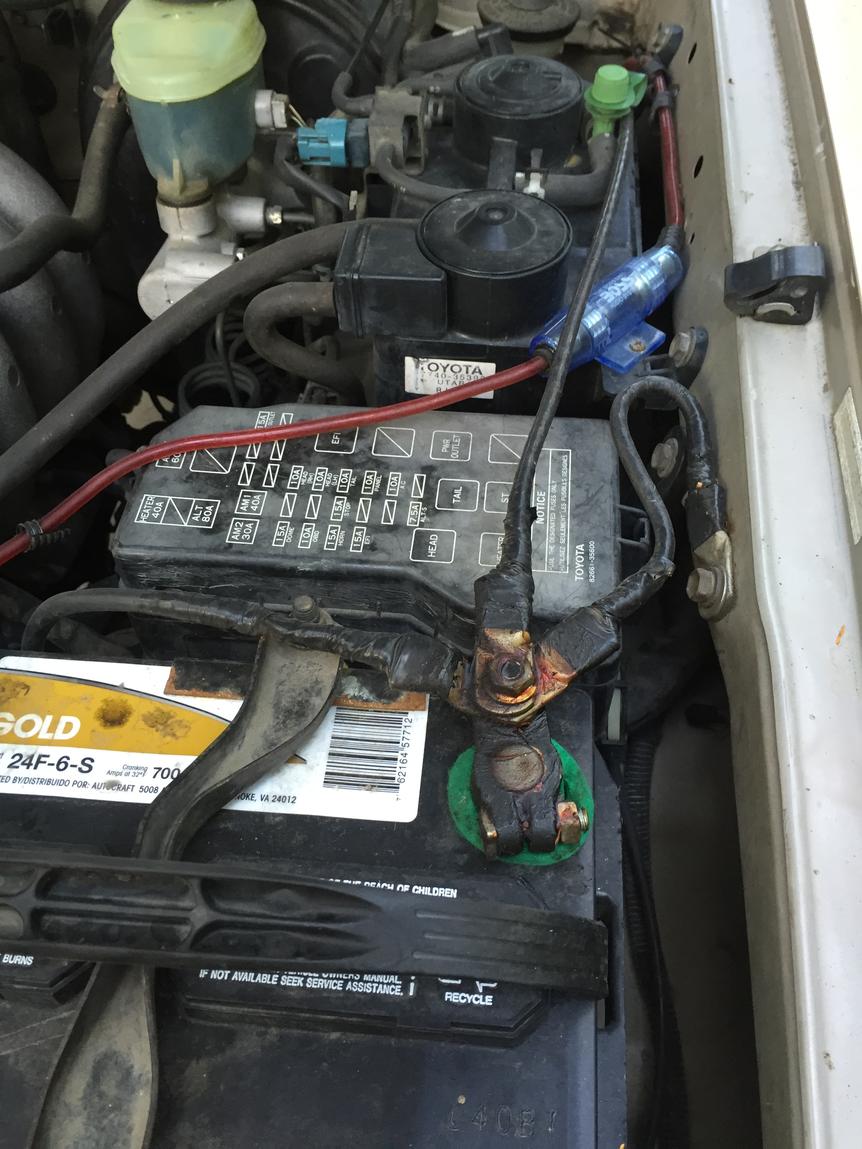

First issue would be fuel delivery. If your fuel pressure is good after it warms up and has been running for a while the next thing I would do is upgrade your ground. I know everyone just rolls their eyes at this but it is important that your secondary grounds are working well. My theory is this , when starting which is your biggest draw by far on both the positive and the ground, if your ground is maxed out, all the functions for the engine to start(ecu sensors etc) will be weaker than they would while running. You can test this out by bump starting if you have a manual and then stopping and crank start it. If it fires as soon as you drop the clutch but cranks for a while when you use the starter you should upgrade your ground. Autos are harder to test but if it takes 5 second of cranking to start, crank it for 3 and then let off the key. If it fires as soon as you let off the key you have a weak ground. This is just my opinion but I upgraded my ground on my tacoma and it cut the cranking time down to normal. I followed a thread on ttora and even if you don't do the big three a ground upgrade will help.
I was just reading up on the Big 3 and you might be right. Between an aging battery and potentially worn starter contacts, that makes a lot of sense since it usually cranks and starts right up without delay if I turn it off and try again.
