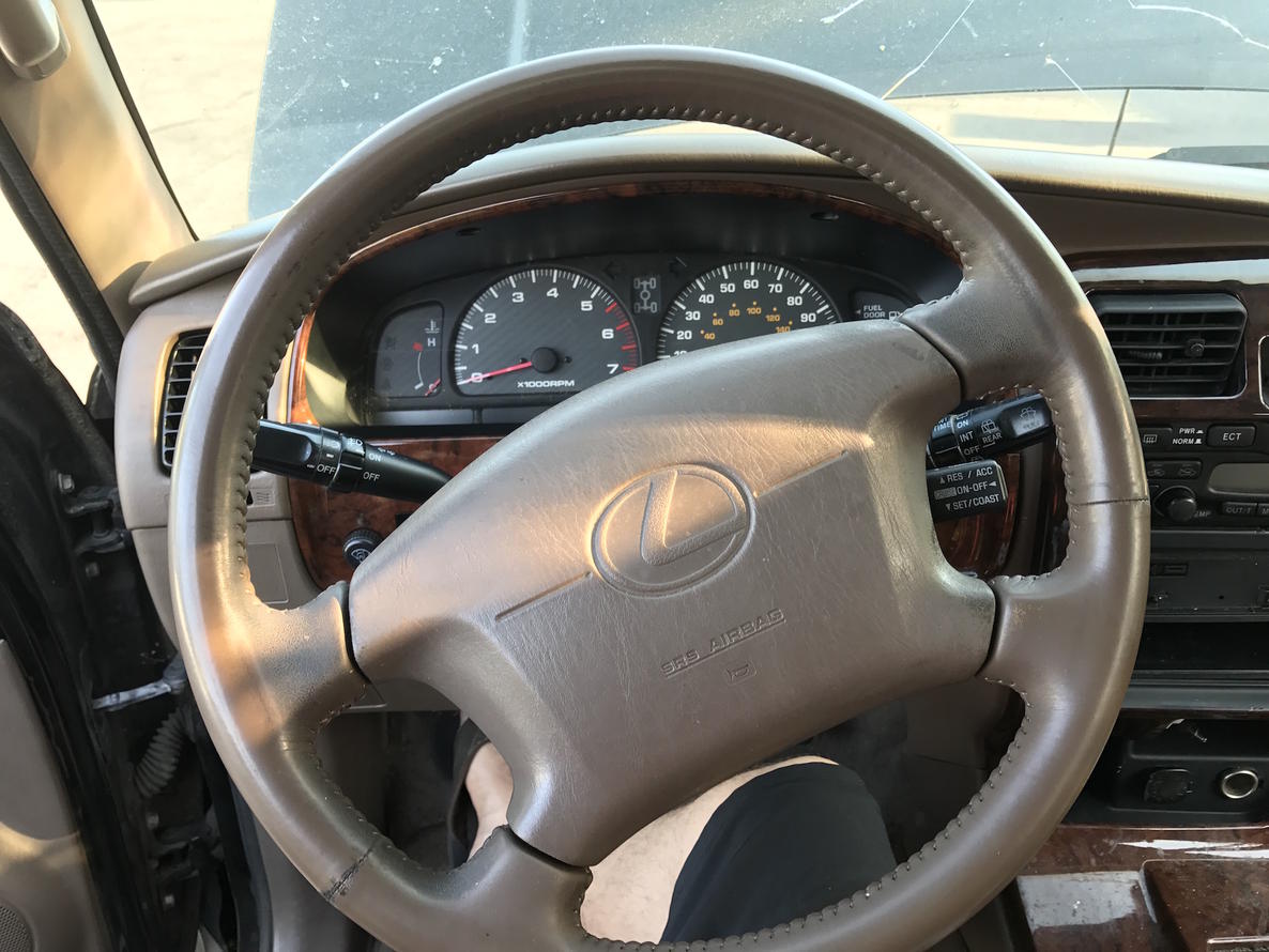

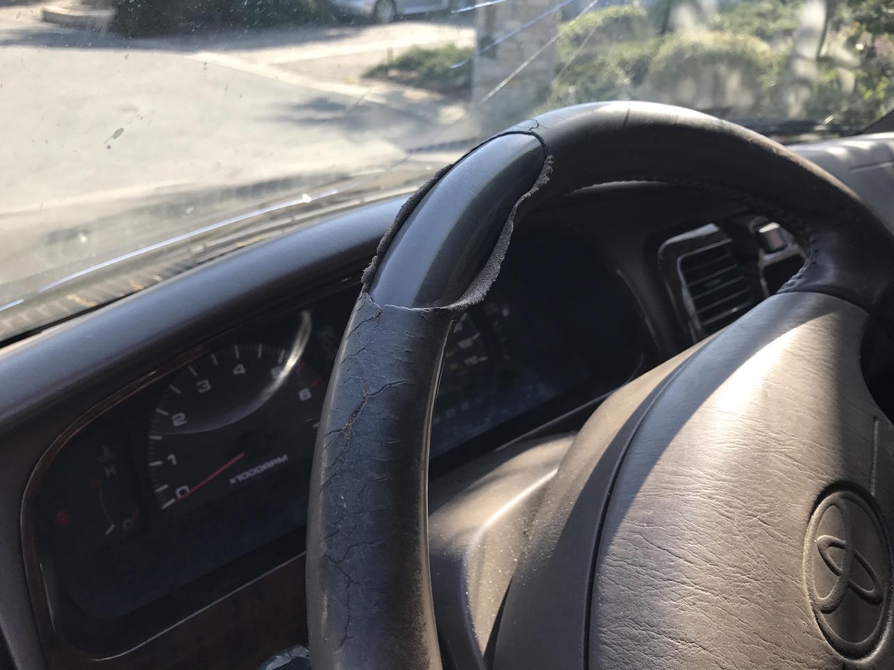

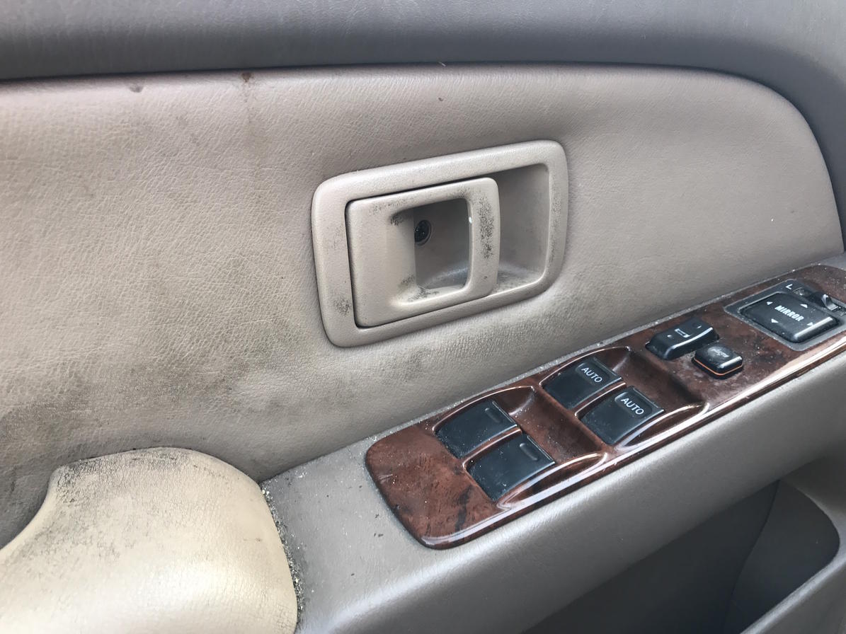

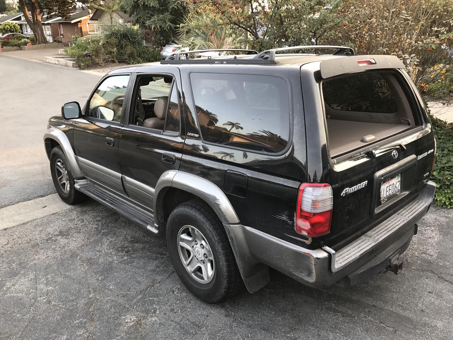

This thing was DIRTY & needed some TLC & since i've been hoarding 3rd gen 4runner parts i was actually able to use some... i had a steering wheel, stereo surround, rear cargo cover to throw in right away...

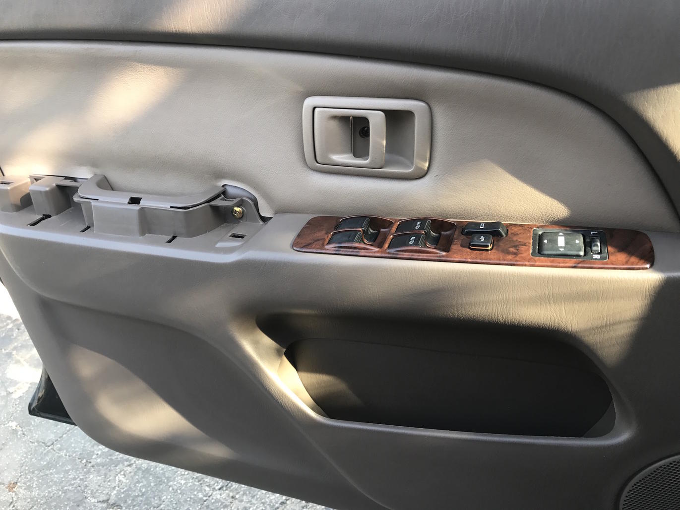

A little cleaning later on the drivers side.
New steering wheel

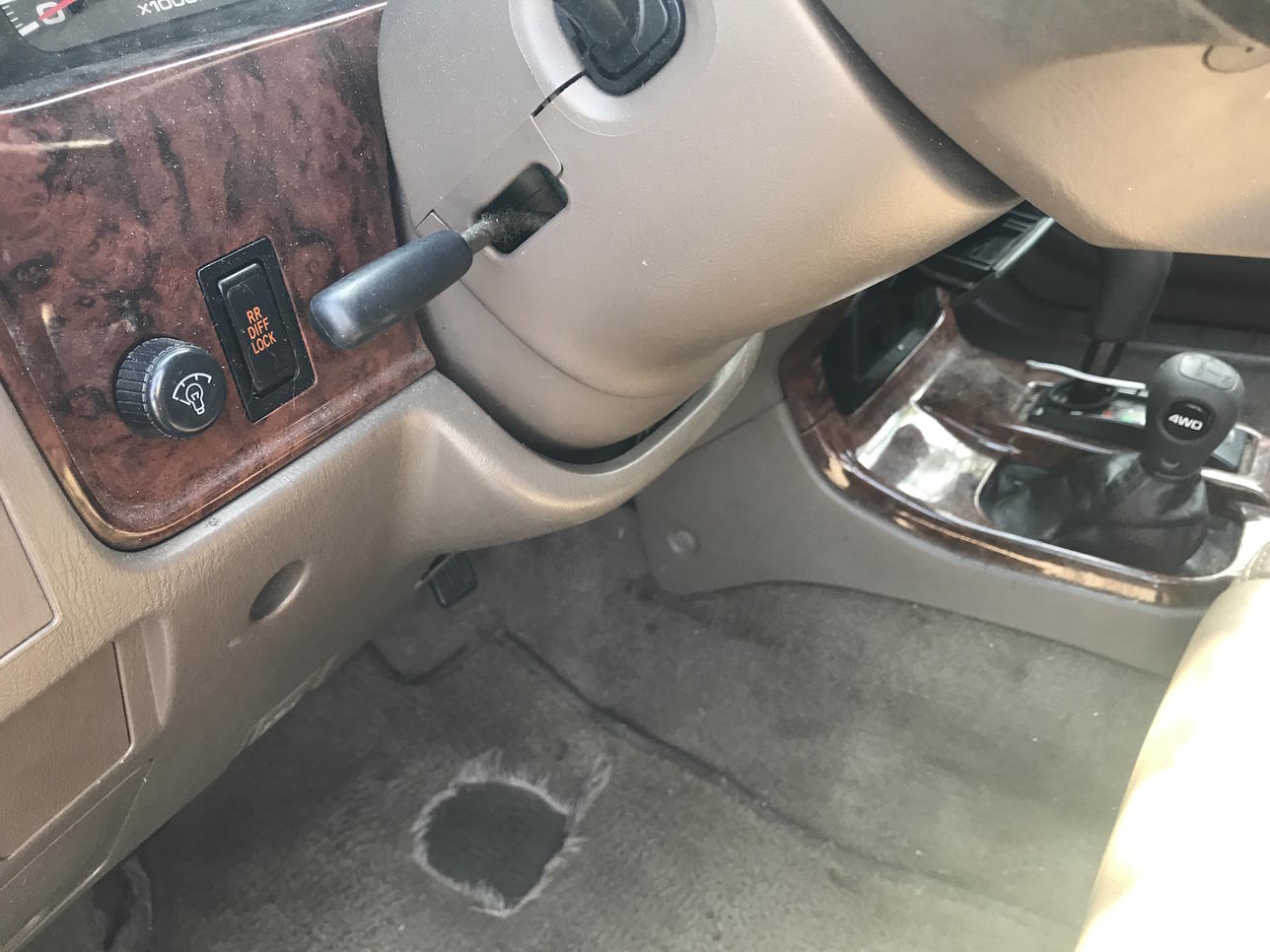

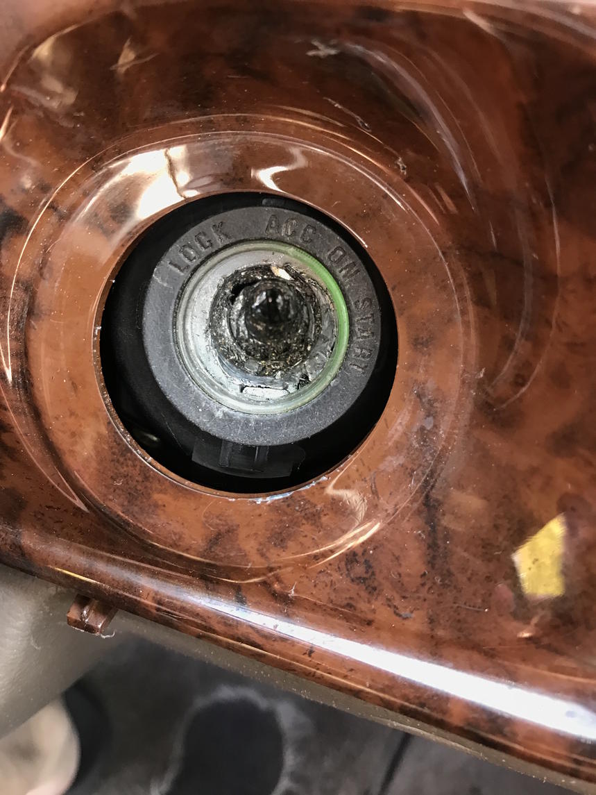

The worst part about this rig is the ignition cylinder....
previous owner had to drill it out days before I picked it up from him since the key had broken quite some time ago & he was holding the transponder portion of the key near the ignition to start it....
Now i start it with a flat head screw driver & hold the transponder portion of the key close to the illuminated ring to start it....

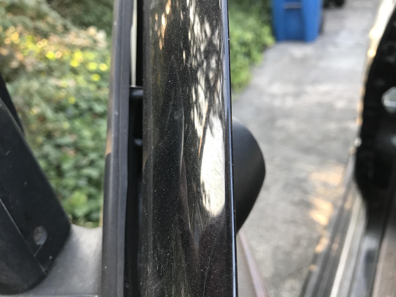

This rig has minor blemishes on the paint, some sap that has dried to a cement type texture & a big ol' scuff from hitting the center divide on highway 17...
could be in better shape but overall I will be less concerned about pin-stripes & such when i finally get this one ready to wheel...
What was funny was when i got it the passengers side mirror was literally about to fall off & was flapping in the wind on the freeway.. when i went to tighten it there was literally one thread on each of the 3 bolts holding it on...

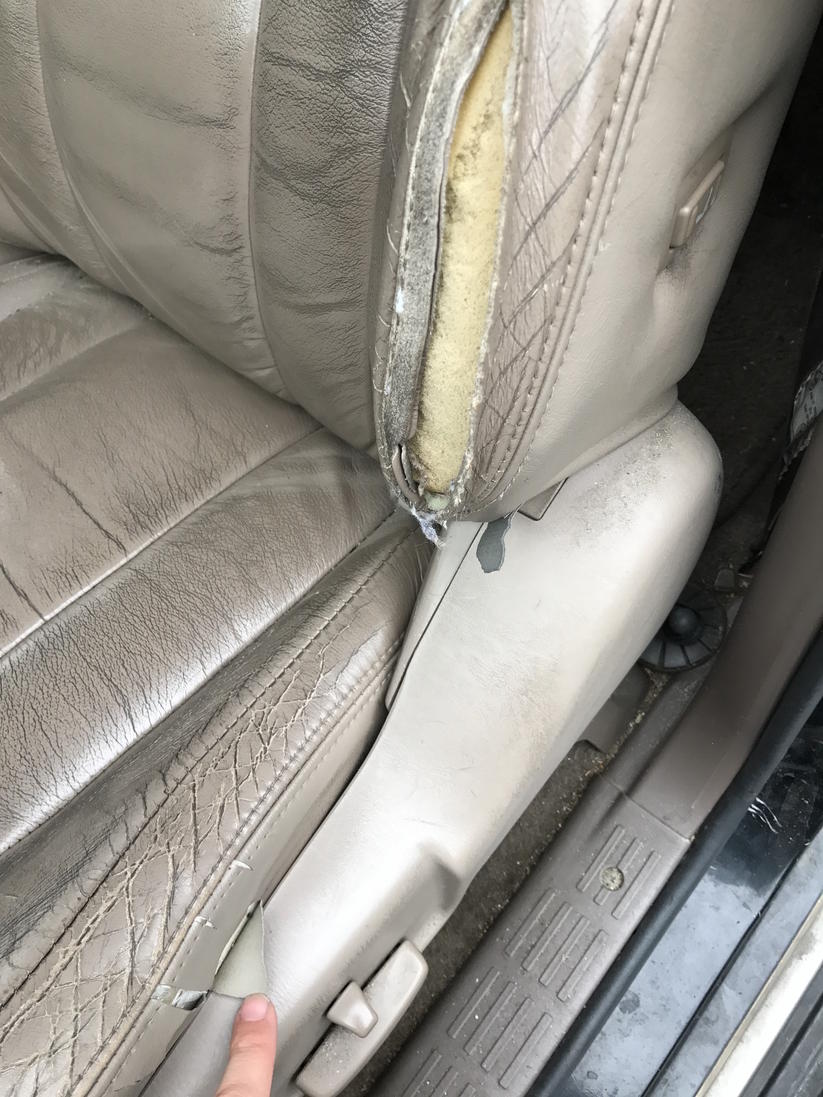

Drivers seat was pretty torn up as well which is common for a lot of us with the leather in our rigs....

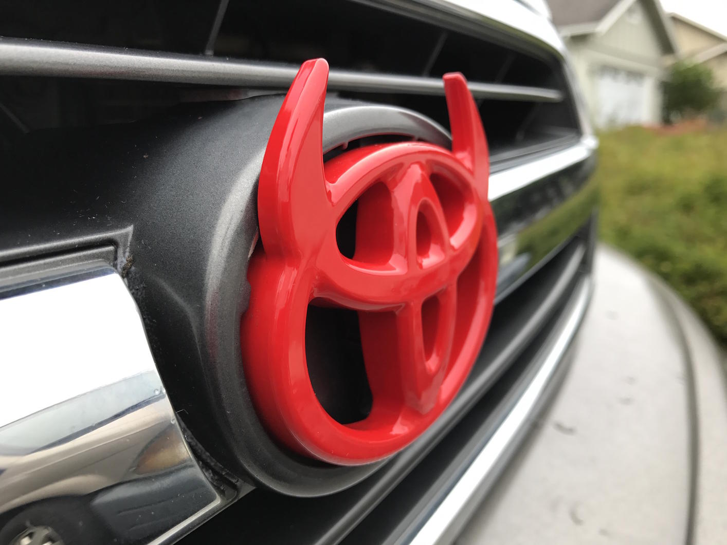

Where did you get the devil emblem?
Custom Emblems

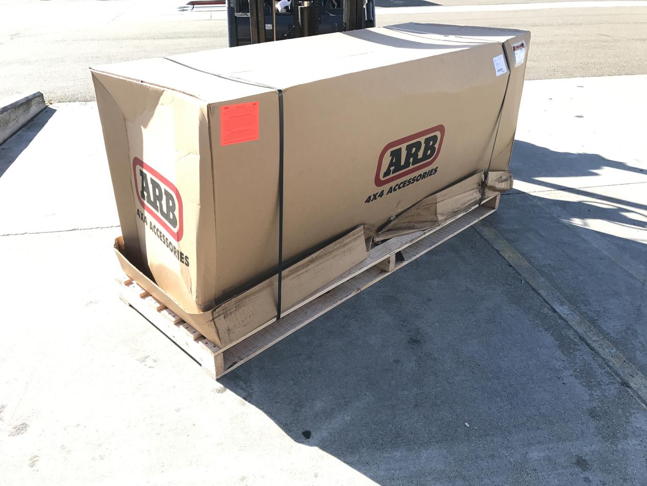

Alrighty my fiends, including you [MENTION=95183]octanejunkie[/MENTION]... we were chatting about the ARB bumper in another thread & I got a call that mine was going to be scheduled for delivery but without being able to accept it at my house I opted to pick it up from the shipping company.
I was a little concerned when I saw the box as it looking like a forklift wasn't so gentle but I inspected where it looked like some damage could have occurred & it looked ok so I accepted it & loaded it up in the back!
I'm trying to coordinate some tim with my buddy [MENTION=120071]mtbtim[/MENTION] so we can film this install for
Future 3rd gen'rs but basically the only thing you have to do is cut the frame rail bumper mounting ends off so the crush cans can fit over the frame..
There are a lot of options for off-road front bumpers out there on the market but IMO this bumper has good bang for your buck, is in stock & doesn't take 3-6 months to arrive & will
Match my thundercloud 4runner quite nicely.
I also sold my front bumper off this rig to supplement the cost of an oddly priced $866 bumper.

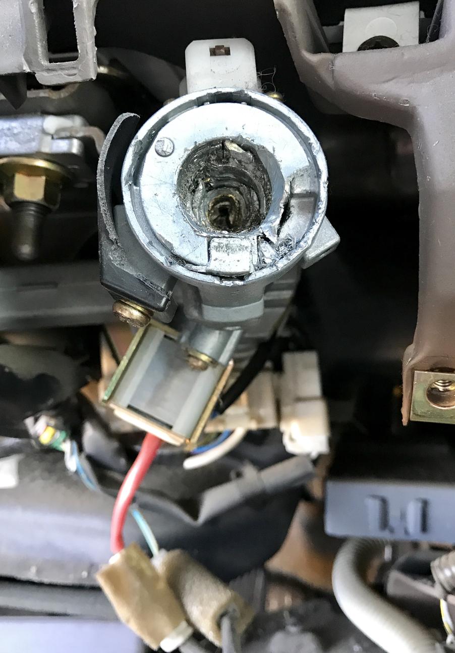

Ok so I'm pretty stuck right now with my ignition...
I attempted to pull my ignition cylinder but wasn't successful..
It wouldn't come out of its home!!!! It's in ACC & I pushed the little pin in on the bottom & it's just plane stuck... plus the ignition cylinder I bought from another member is for a vehicle without theft protection with the chip/transponder key.. so although it could technically work, the front where the key goes into is slightly different & I fear the transponder ring won't fit back on properly...
I don't recall ever reading on here over the last couple years of someone drilling out their ignition cylinder & I really don't know where to go from here... if it hadn't been drilled out by the previous owner I'm sure it would just slide out like it sounds suppose to.
