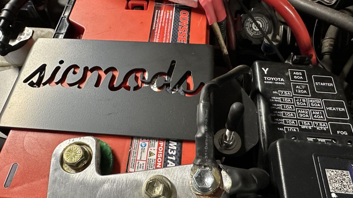

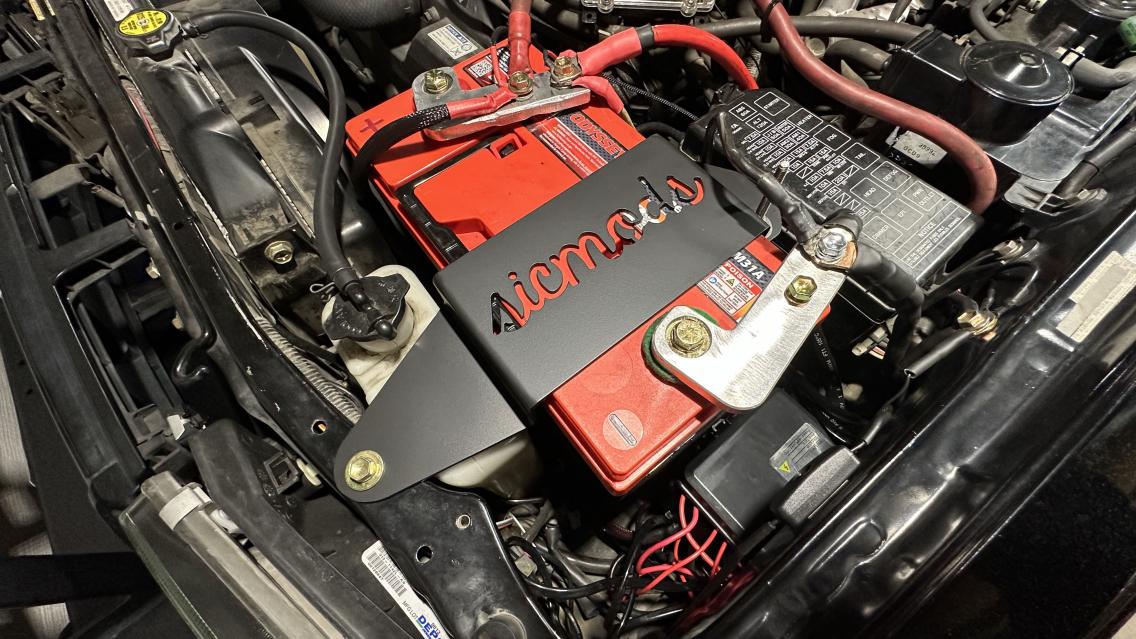

Group 31 battery with custom #sicmods battery tie down.

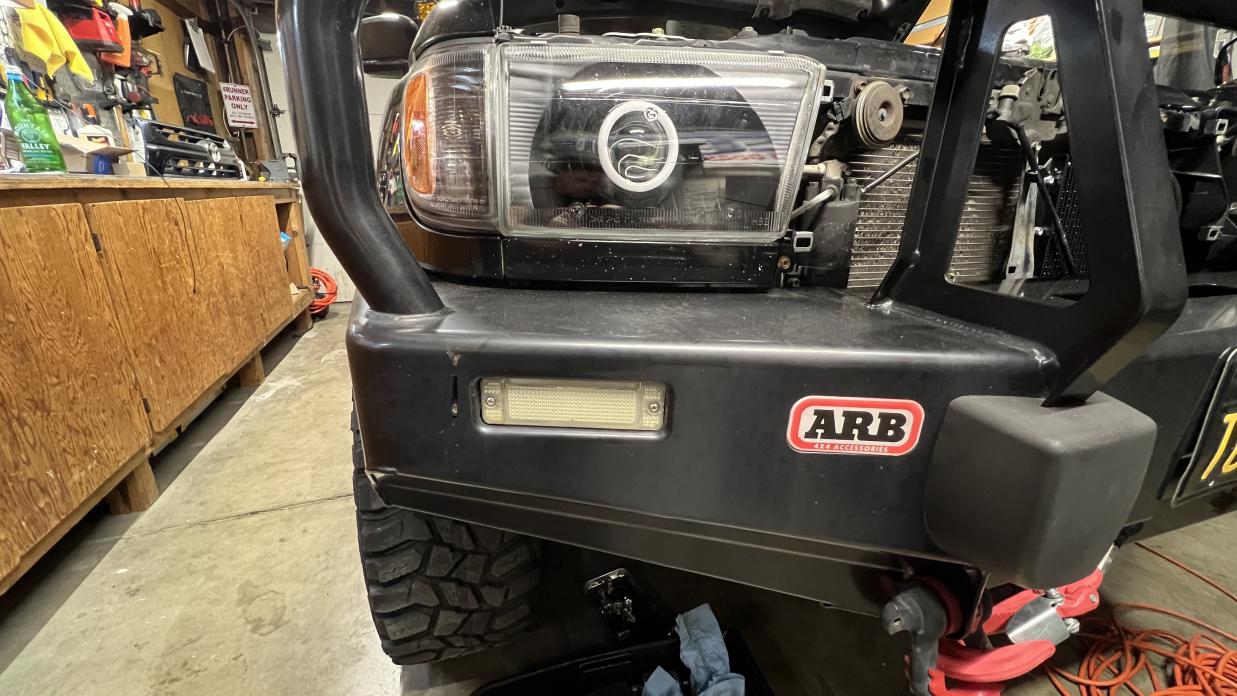

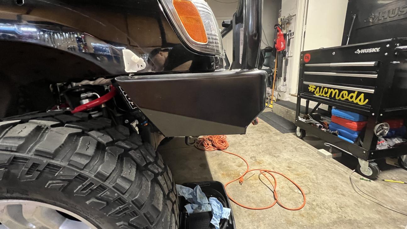

Fixed my bumper gap finally... I moved the mounting holes 1.25" up, and 1" out. I also welded the nuts to the frame horn mounts to avoid the annoyance of pushing out the capture nuts every time you want to re-install the bolts.. it would constantly push the capture nut out and then you basically had to remove the entire bumper to reclaim them. this turned out absolutely PERFECT! if anyone has an ARB bumper out there with a body lift, I highly recommend going 1/4" higher than your body lift, and moving the bumper out. fitment is on point now.

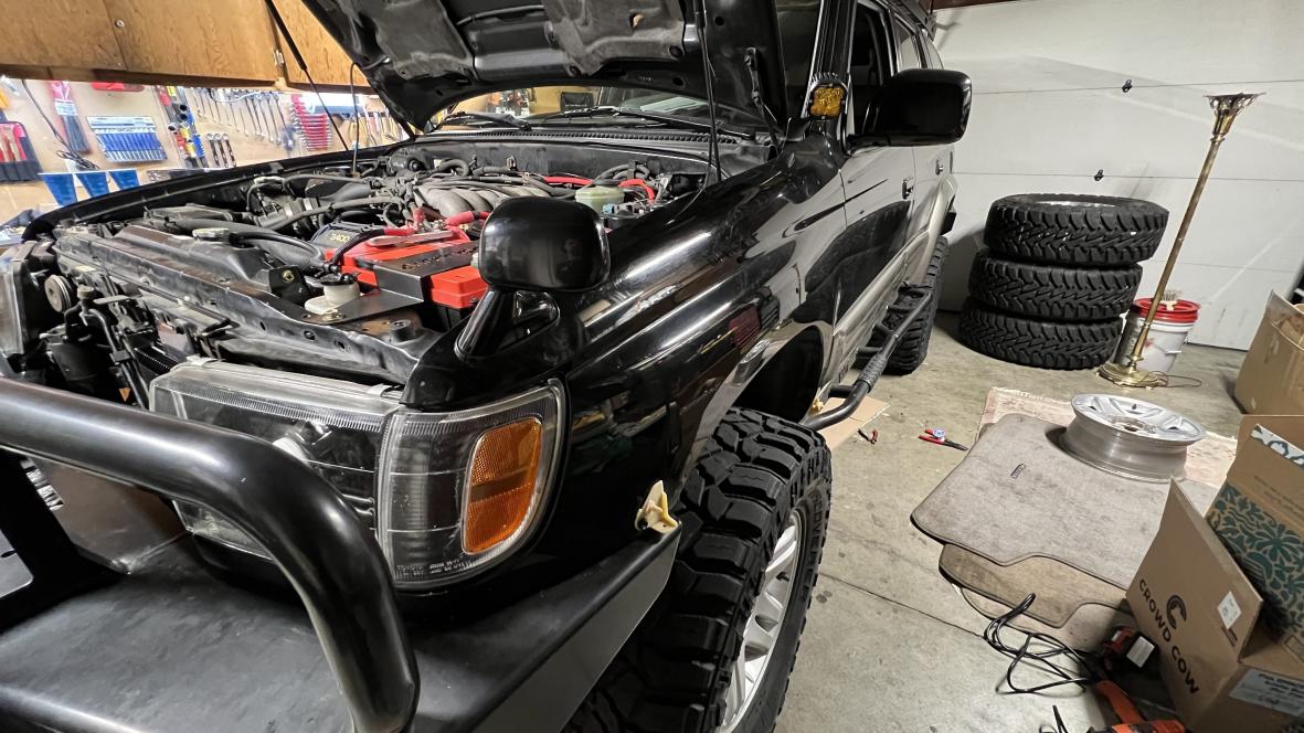

here is a cheeky little mod - Hilux Surf fender mirror. It has no real practical use for a left hand drive vehicle but JDM 4 life.

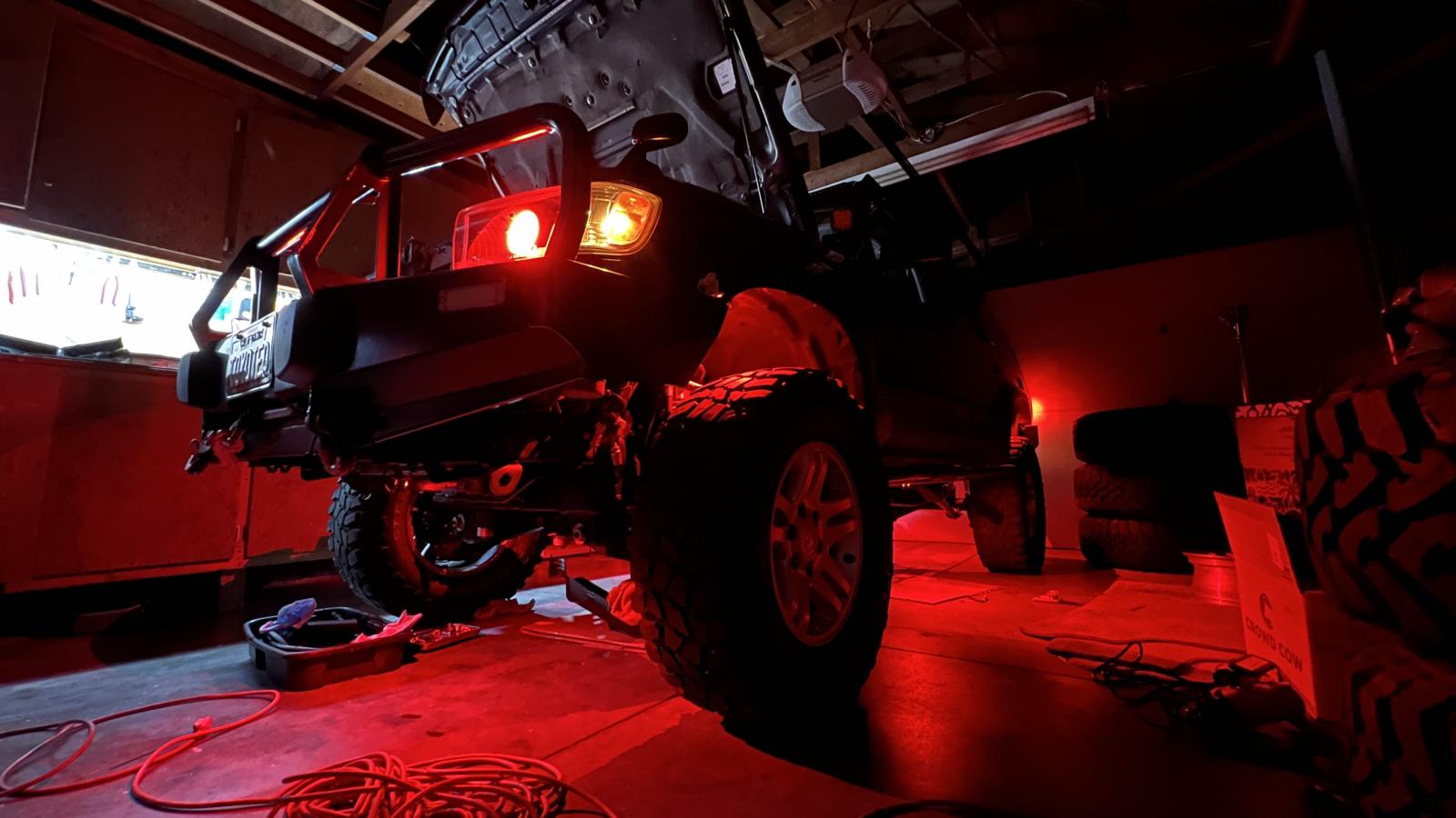

it's getting lit!

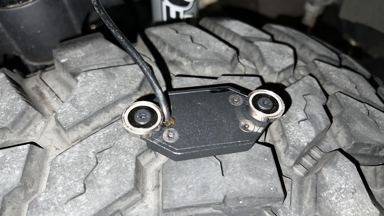

Rock lights installed. 8 total - 1 in front, 1 in back, 1 in each wheel well and 1 on either side of the middle of the truck. I retrofitted some countersunk magnets for them to mount so I could possibly move them around or play around with placement.
