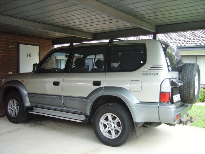

I want to know what is the RPM at 68 MPH for 5vzfe with 5 speed transmission. A friend of mine in Australia got a prado with the same setup and he clams he get 110 KMPH (68 MPH) at 3000 RPM. I got an A/T therefore I cannot help him.
