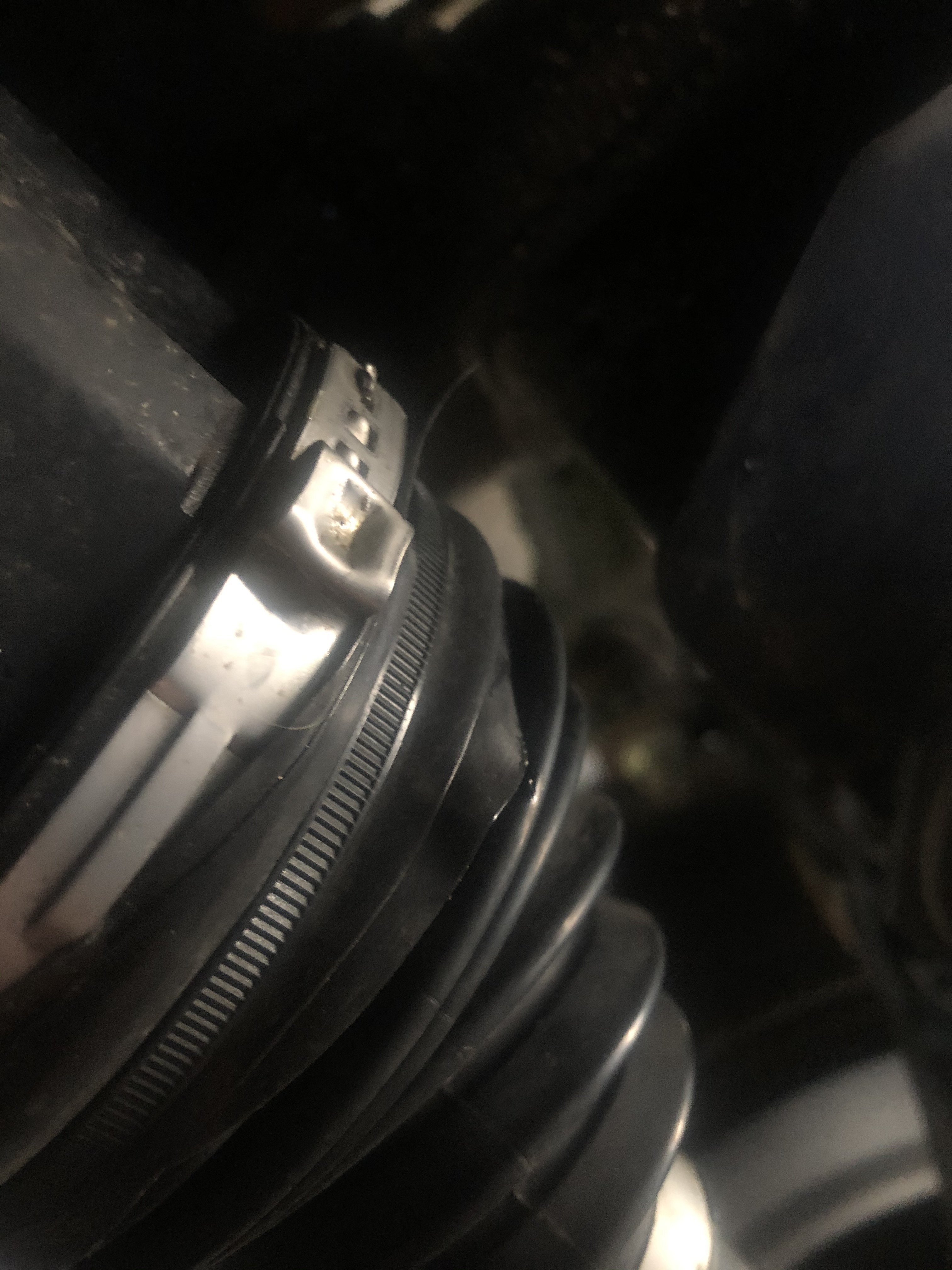

Looks like poor CV boot strap crimps are a thing now, same issue, I'd rather not buy $250 tool... will Lisle 30800 CV Boot Clamp Pliers, work to crimp it better?
At least the new boot isn't torn, so that's a plus.
I have the Lisle boot clamp pliers, and yet haven't had a need to use it on the 4Runner. If you can reach the clamp with the tool perpendicular to the boot clamp, then it would be fine to use. If the boot is not leaking, I would tighten the clamp a little bit more and check it once a month for 3 months.

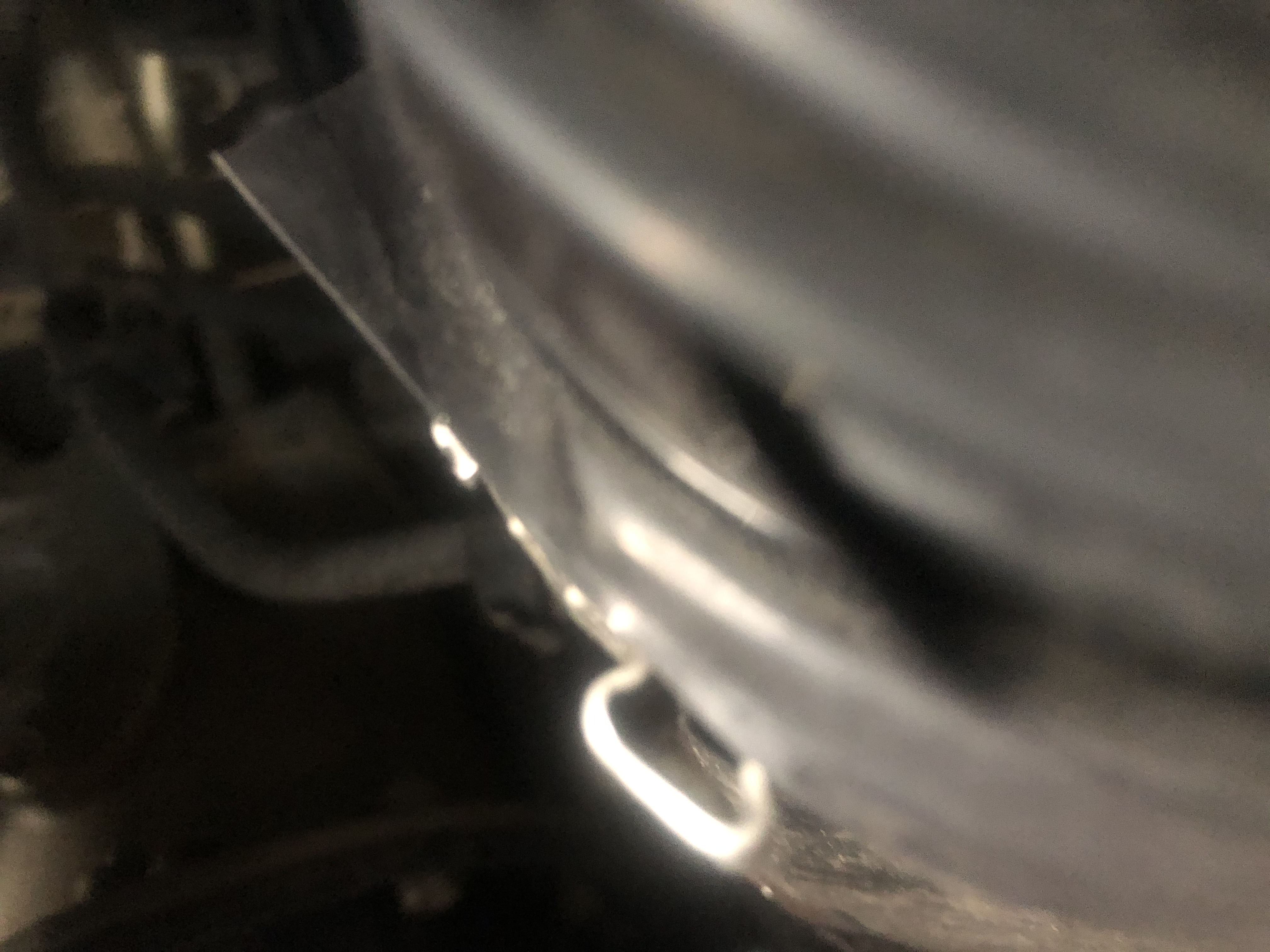

It's leaking, but looks like because the strap is too loose, this axel is brand new, there are no tears.
I'll crimp it until it kinda ears out, same as pic. If it continues leaking I'll switch to warm drive clamps.

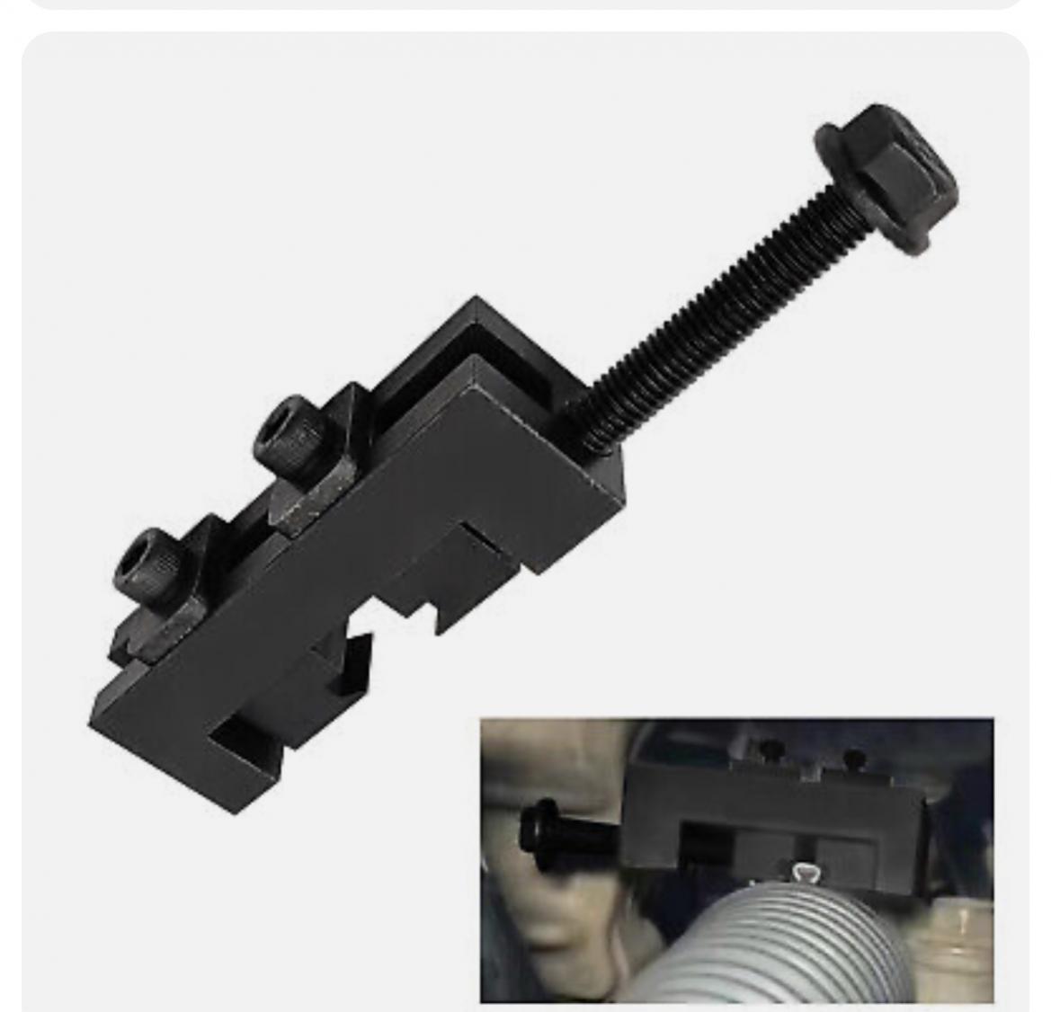

Posting to comment on need for specialty tools.
The Toyota crimp tool is a bit expensive.
Also very popular and desirable.
Unless you are strapped for cash, you can always BUY a specialty tool, and use it as needed, the re-sell it on eBay or some such.
The Toyota tool would sell quickly, and for a good return on a substantial percentage of the original purchase price.
Aftermarket version
09521-24010 - DRIVE SHAFT BOOT CLAMPING TOOL Fit For TOYOTA | eBay
OEM version
https://toyota.service-solutions.com/en-US/Pages/ItemDetail.aspx?SKU=09521-24010
Thanks for the Amazon link.
Is it OEM?
If it isn't, it looks like a good copy. Assuming that the pics are representative of what will actually be delivered.
Note that there are no reviews of that item on Amazon. Caveat Emptor as they say.
