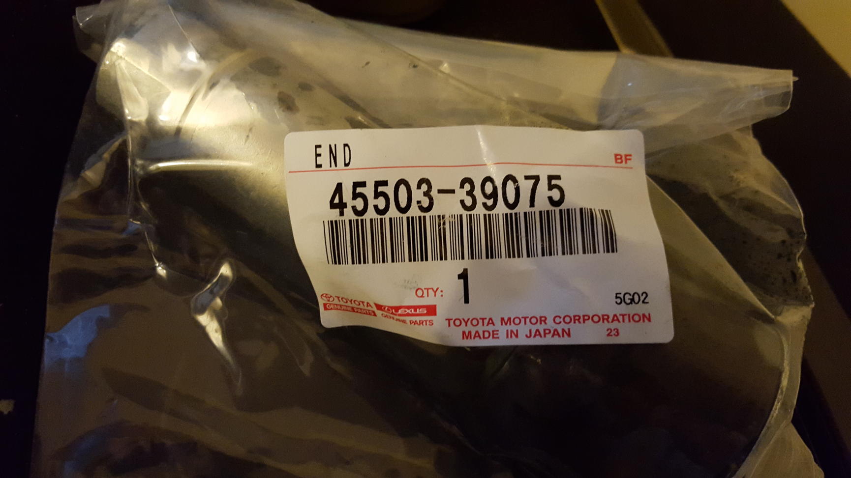

Where did you get factory ITREs? When I did mine the local toyota dealership said they couldn't get inners anymore...
This... I just popped my outer tie rod end out and there is so much play in the inner. Called up a few toyota places and all they sell is the rack with the ITREs attached.
I ended up with an aftermarket inner. So far so good. Next time I have it apart I'll see what kind of shape it's in. Good to know there are factory replacements available though; If I'd had that option, that's the route I would have gone.
