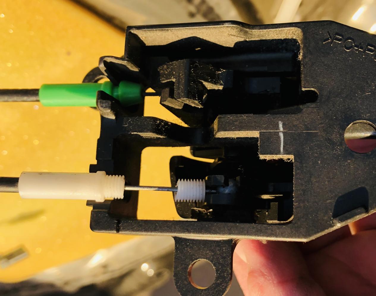

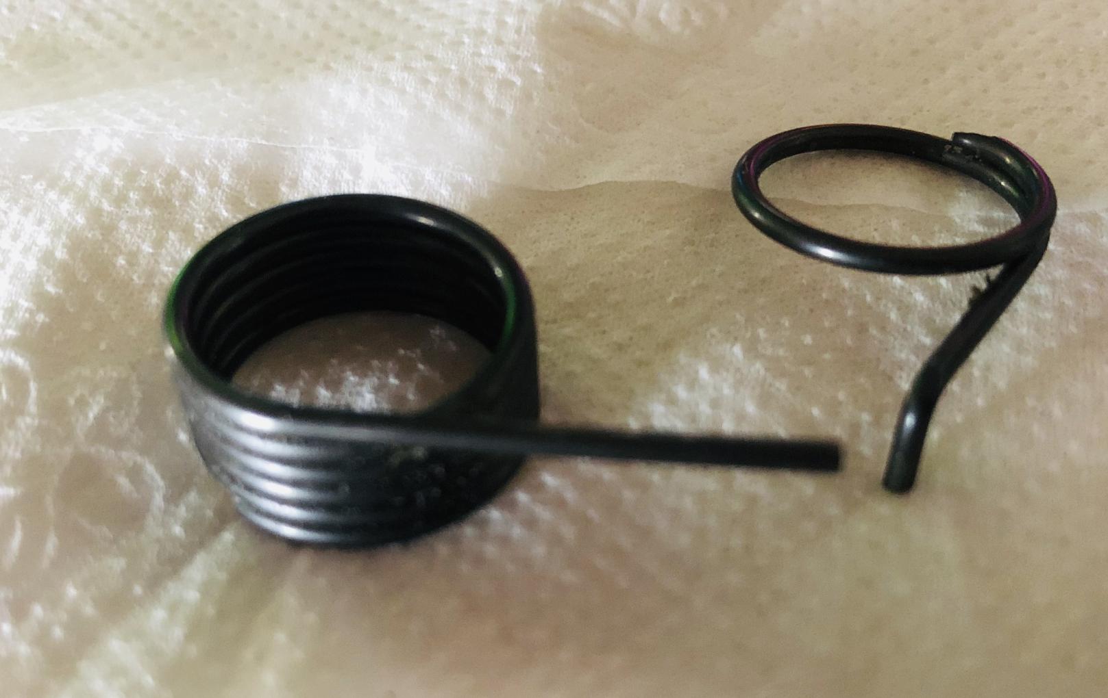

I took my Drivers door panel off to fix issues with Lock and Handle. White Plastic part on Lock Cable at Handle was broken. Fixed with some electrical tape. Lock works Ok Now. However the Spring for the Green Door Handle cable actually Broke. Do I need a New Handle or can I Get a new Spring and replace it? How does the Spring sit in Handle. It fell out when I removed the Panel so I have No Clue on orientation of the Spring itself

You're probably better off going to a junkyard and getting the whole assembly. Then swap what is needed to make it work properly. Finding the spring itself may be tough and seeing there's no replies yet I assume this is not a common issue.
You would have to buy the entire assembly, you can't just buy the spring, either get it from a Toyota dealer, not cheap, or if it were me I would get it from a savage yard as suggested.
