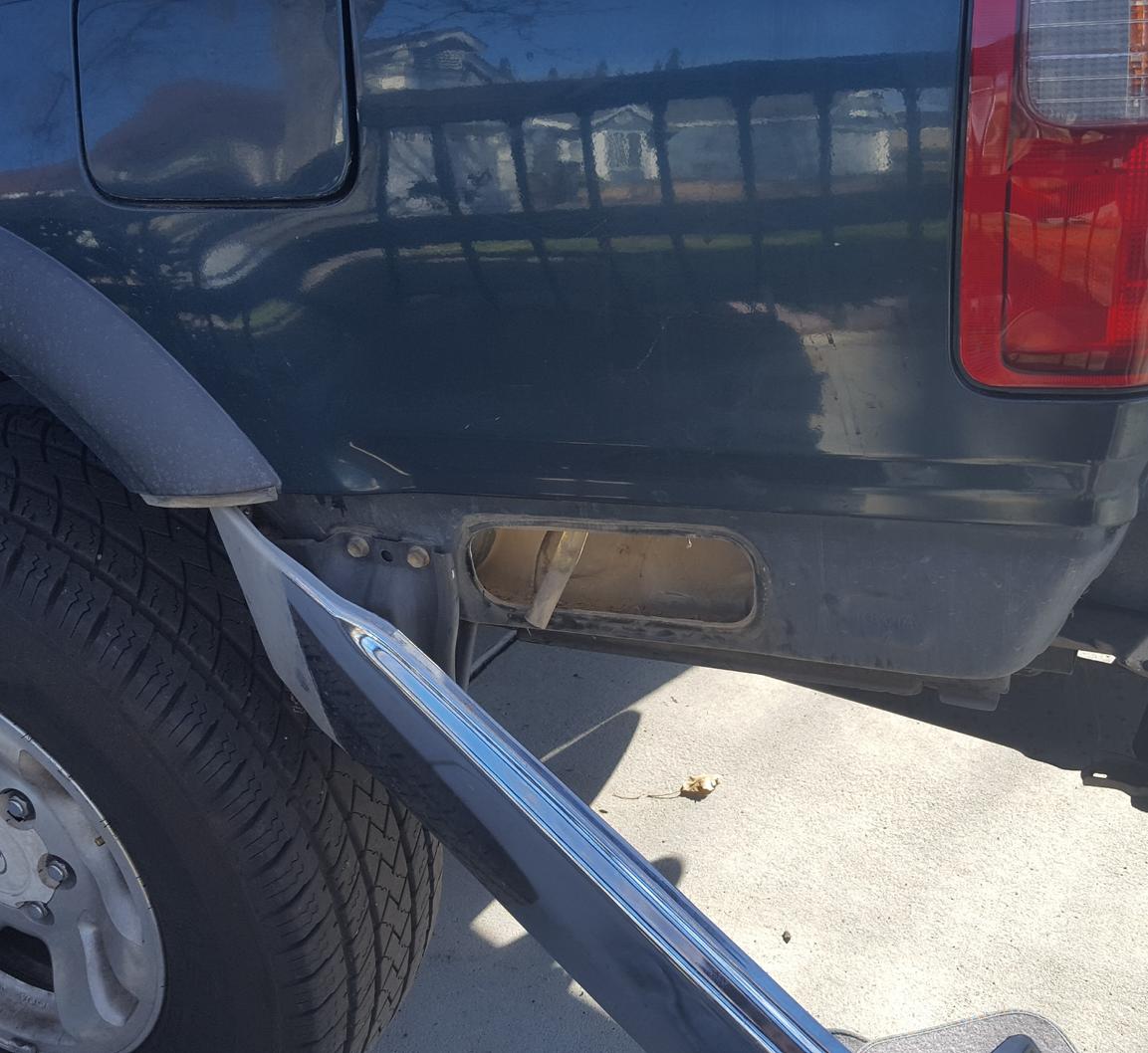

There's only one vent, on the driver's side.
Looks like this:
That is probably the issue. Also could be door seals or the lower 4WD shifter boot (sometimes people cut it when doing transmission work).
-Charlie
There is an air vent outlet on the bottom of the read driver quarter panel underneath the bumper. The flapper came off mine and I had what you have.
I now have a 2nd 4runner and it is also missing the flapper door.
