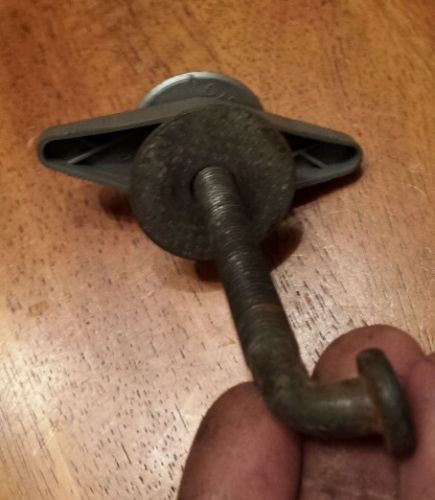

Sounds like you're wanting something like the Cherokee XJ spare tire mount. All you would need is a loop to put a long threaded bolt with a hook onto, put it through your rim, and thread a nut/washer combo on or even a cherokee bolt/nut from a junk yard might do it if it's long enough. Here are a couple of pics to clarify my weird wording.

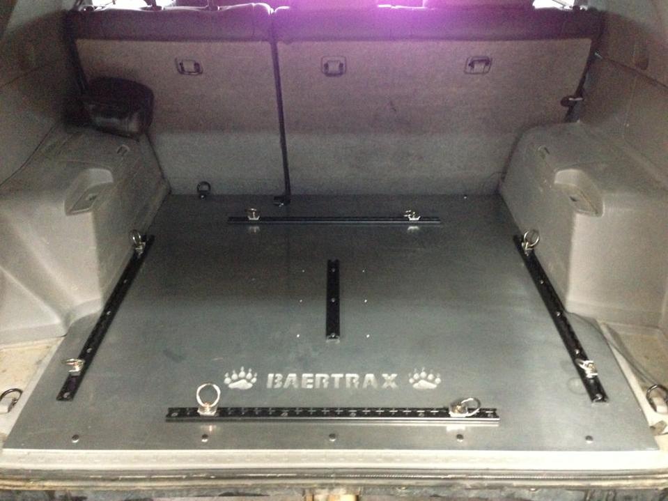

What about having a a large metal platform (sort of like one in linked pic), that would allow you to mount hardware without having to do much in the way of invasive hardware changes to the actual vehicle?
This way, you could rig up an arm that comes up from base to secure tire in an upward position. Or maybe go lower with another layer over for storage over the covered tire?
