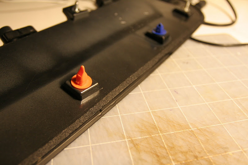

I wrapped the vinyl under the hood about half an inch - an inch. For the hood scoop I did a very close cut. All the cuts I pulled the vinyl away from the hood or paint while cutting.
That looks pretty darn awesome... do you trim it at the edge? or does it wrap under the hood? any pics/explanation would be greatly appreciated.
Okki
I'll take more pics tonight but here's one of under the hood scoop.
