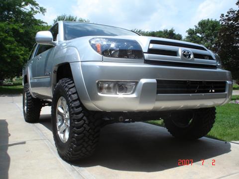

hey guys, after MUCH delay i have a couple pics of my truck.
Its not the best pic, but its a little bit of something, she isn't shiny clean or too dirty. the weather and waves over the last 3 days were wayy too good for me to clean the truck and take pics, so today when some rain rolled across the state i decided to get to one of the spots I frequent for some cruising and pic or two before sunset. Look for more in the gallery section soon, once i can take some good clean pics and some better offroad. Thanks to all who have similar setups, you've been my motivation and at this point i am REGRETLESS! only STOKE! woop woop!
IMG_8365.jpg~original
IMG_8367.jpg~original
Ray
