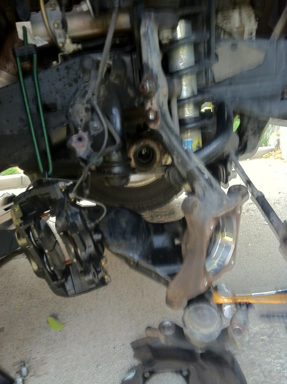

Then, after getting this 100 lb monster in service I commenced to tear the right front side down... so easy! gentle with the ABS sensor...hang the caliper...unbolted the tie rod...per the TOY manual vs the sway bar...
Boy did I have a time getting the Rotors off the HUB...they were rusted fast...I beat the livin crap out of them with a rubber mallet...had previously done the PB Blaster treatment....
The Axle popped out sweet with a 4 lb hand sledge and a 18" crowbar...
here is the tear down...sorry for the fuzzy picture

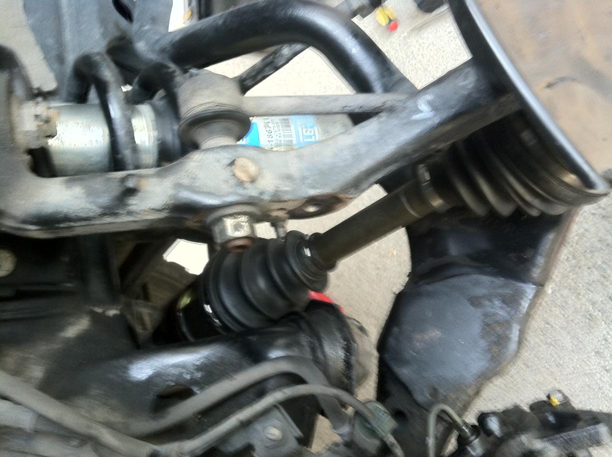

Soooo...the Axle seal at the Diff housing was a $*&% to get out...153000 miles of sealing....
I was not nice to it...as one of our community recommended:
Then I lovingly seated the new seal with a coat of gear oil...had to fuss alittle to get it started before I used the new axle to drive it home...

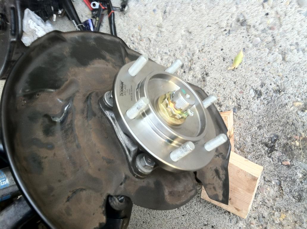

New axle drove home sweet...Put the new hub on....started to bolt it and remembered the dust shield...unbolted it and did it again...I found getting the bolts on a new hub through the dust shield and started...was a pain...but I persevered and got it done...

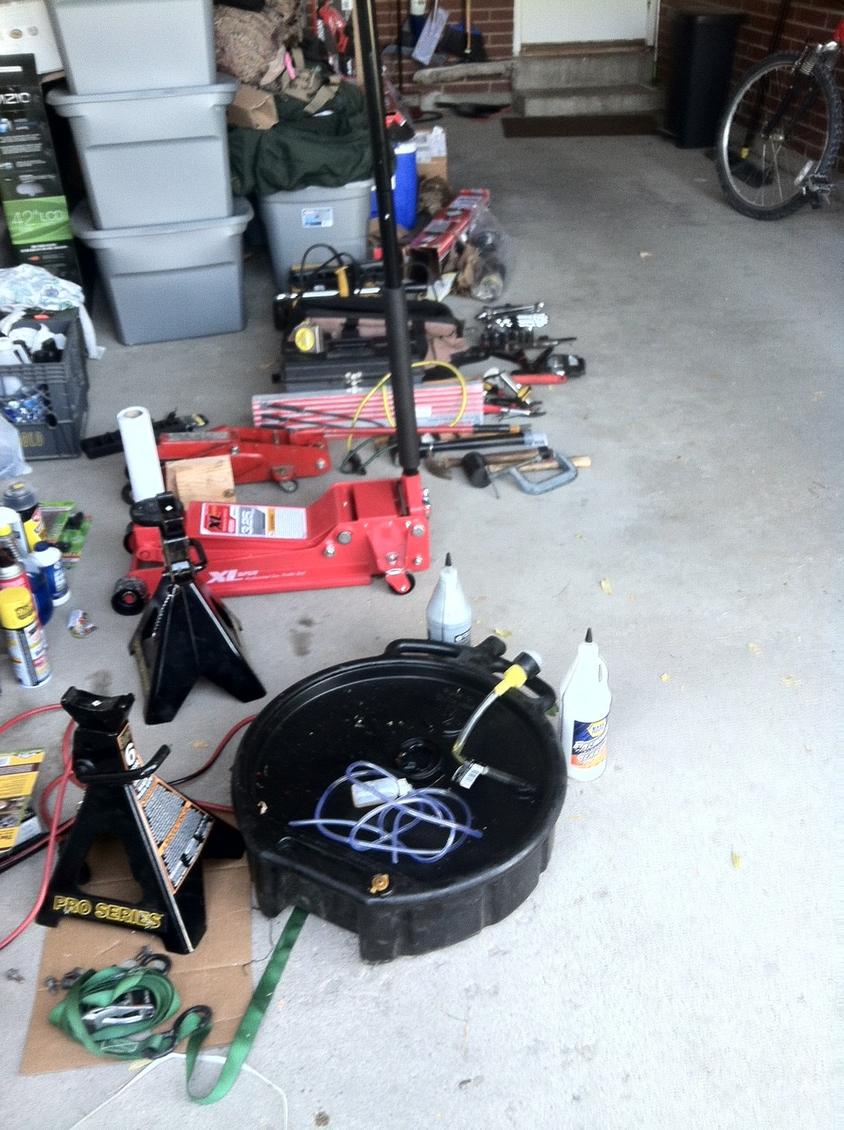

well anyway...that is what can be done in a driveway by a dude that is not accustomed to mechanic work...here is my little fair weather garage...
