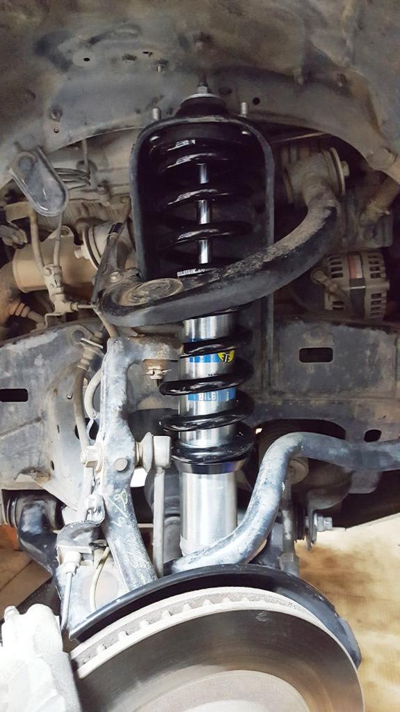

Do you have all the bushings and washers on the top of the shock to hold it in tight to the tophat?
Yup sure do and the nuts are tightened so that bushings are almost the same diam as the washer up top.
