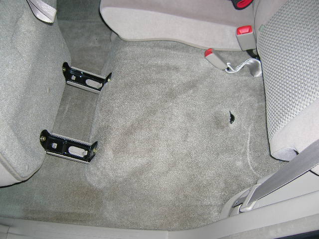

I was wondering if it would be ok to install an amplifier under the back left side seat in a 03 4Runner. Will this cause any issues as far as heat goes, any other issues? Thanks

I'm thinking about that, does anyone have any pics of this install. The amp I am installing is about 10-1/4"W x 2-5/16"H x 9-5/8"D. Will that fit.
There is zero room under the rear seat.
