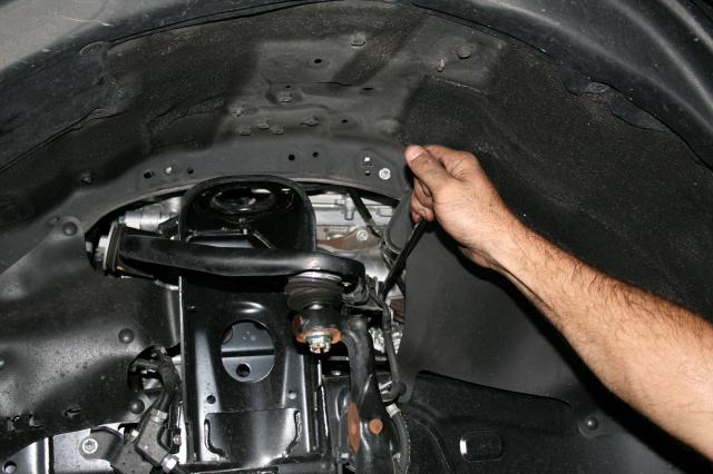

Just doing a initial look see and was wondering if there is clearance to remove the OEM UCA long bolt? Does not seem so. Any insight from those who removed / installed themselves?
there are 2 small AC lines (I think) on passenger side that you need to take care not to bend, it's kind of a 2 man job, not difficult just awkward.
Have to hold the UCA in position from tire well and thread bolt through from engine bay. pretty obvious from this:

Yes there is room. Once you get the nut loose use a small screw driver on the lower side and use it to push the bolt upwards. Hold on to the washer so the bolt doesn't get stuck. As tlflow said, a second person, standing up can help feed the bolt from above. Not bad at all. There are really good install threads on the Tacoma forums. Install is almost identical.
In some cases (pending the battery size), you may have to pull the battery to get the bolt out on the driver side.
As above 2 people will certainly make it easier.
