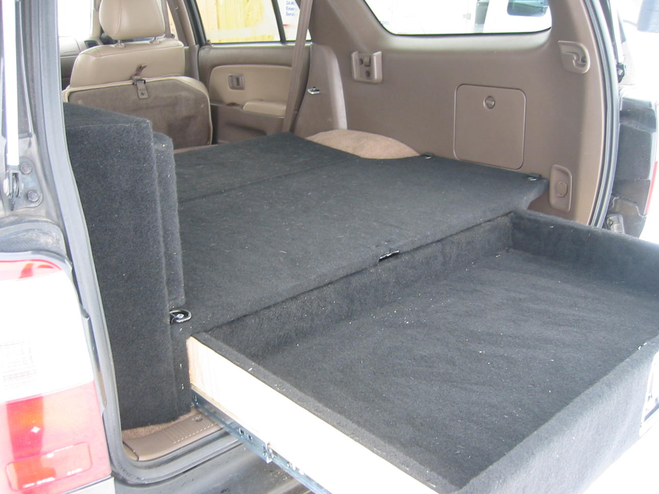

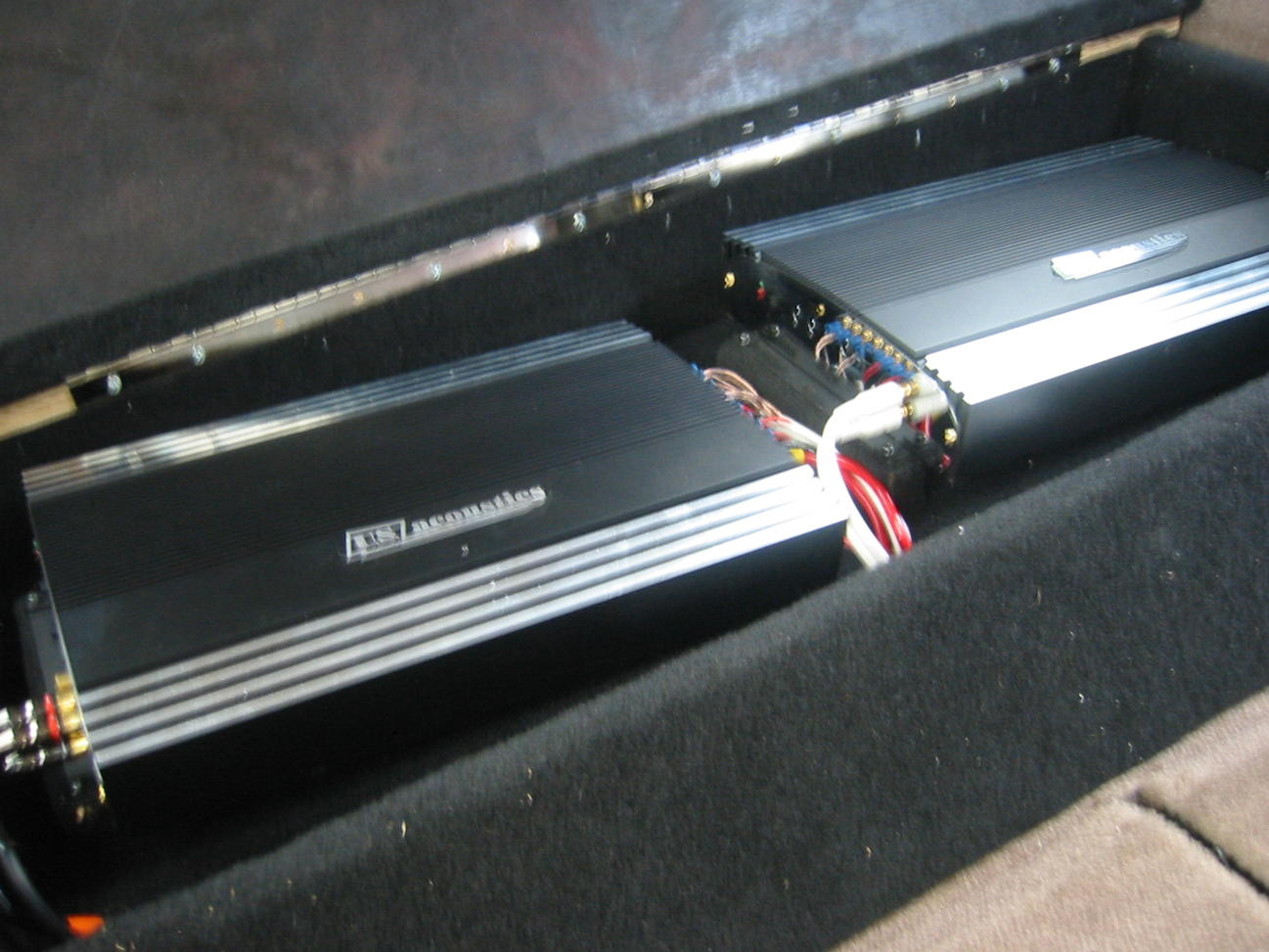

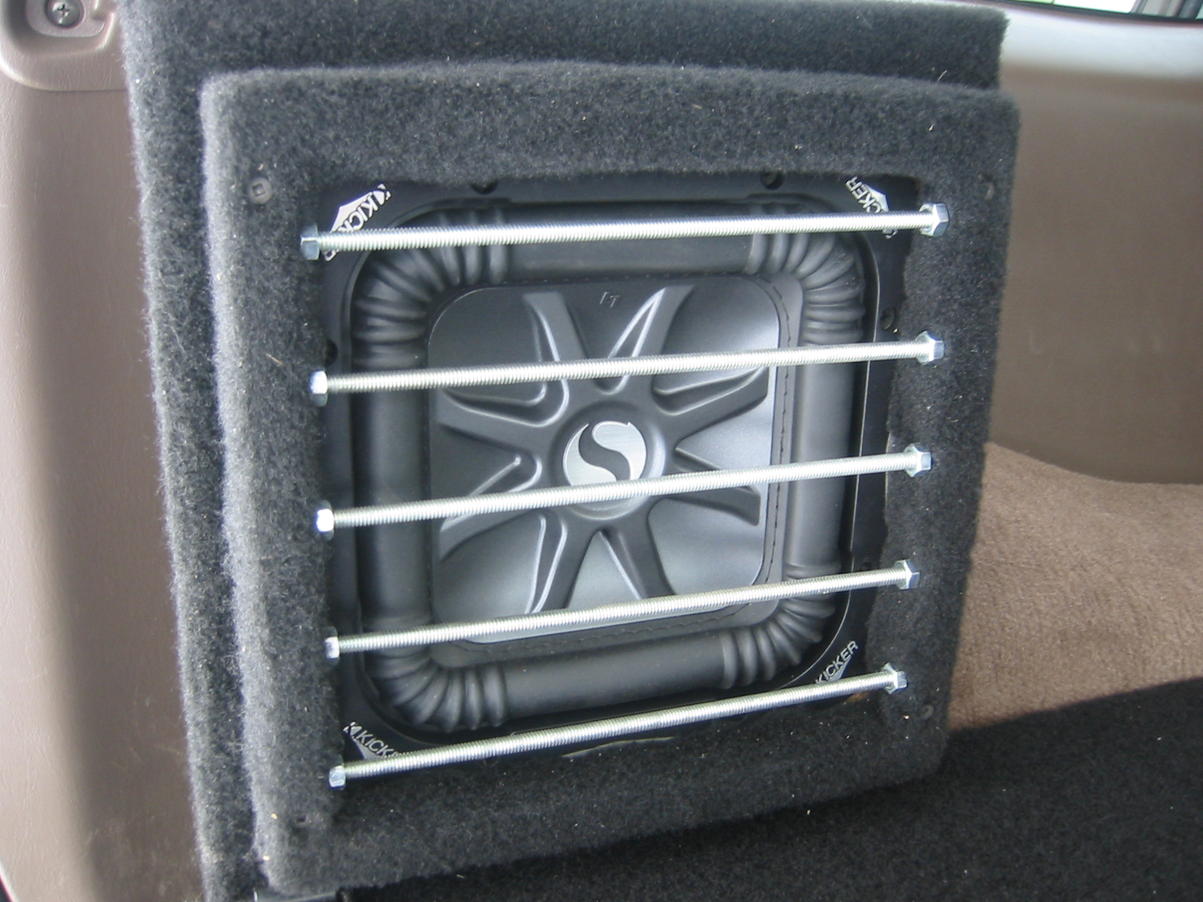

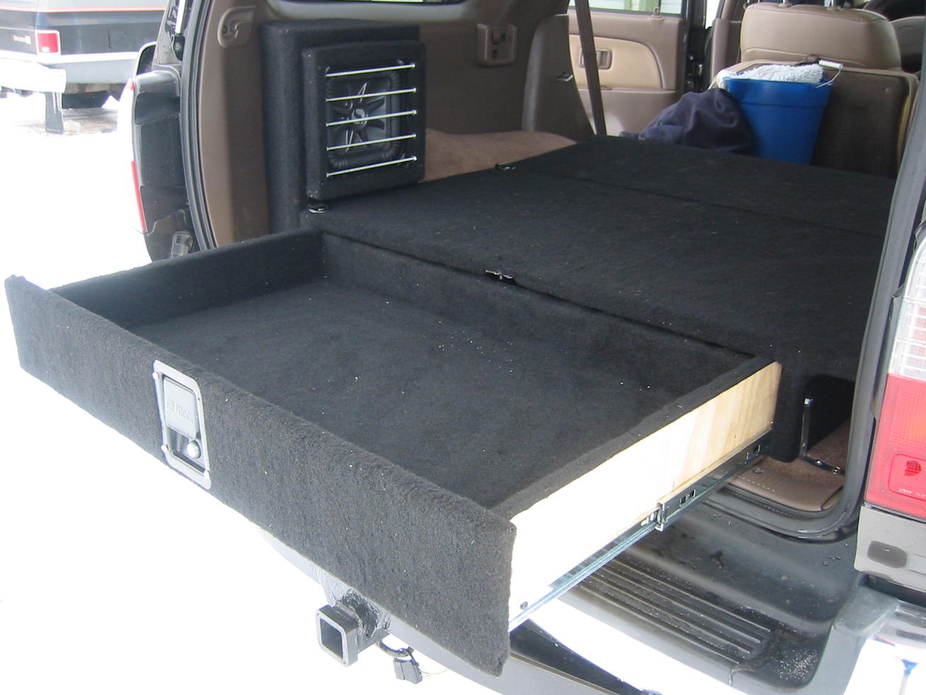

Here was my solution to that problem. I built a cargo drawer and amp rack together. The front holds the sub and high end amp with the front door crossovers. the rear is a 22" drawer I can throw whatever in, jumper cables tow straps, first aid kit and such. I built it low enough so I can use the factory side compartment and 12 volt outlet. The side sub box holds a single kicker L7 8" sub. I have 600 watts rms going to and it sounds great! I was pleasantly surprised. Plenty for me.

Thanks! It took a lot of measuring but it was worth it. It really only took and afternoon to build. It took longer to carpet the thing. The drawer really works well to put junk in and by hiding the amps my mutt can ride back there with no worries.
