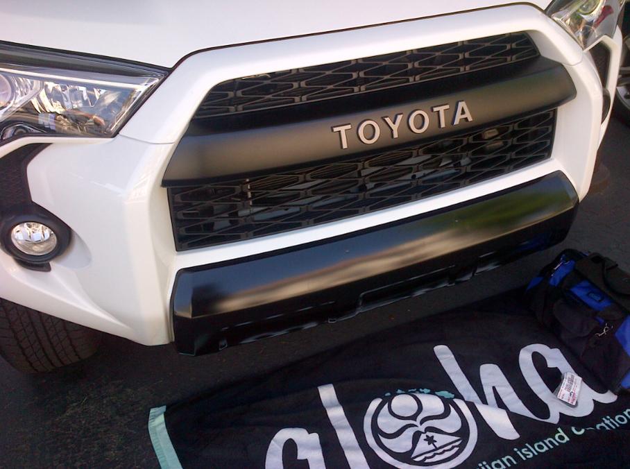

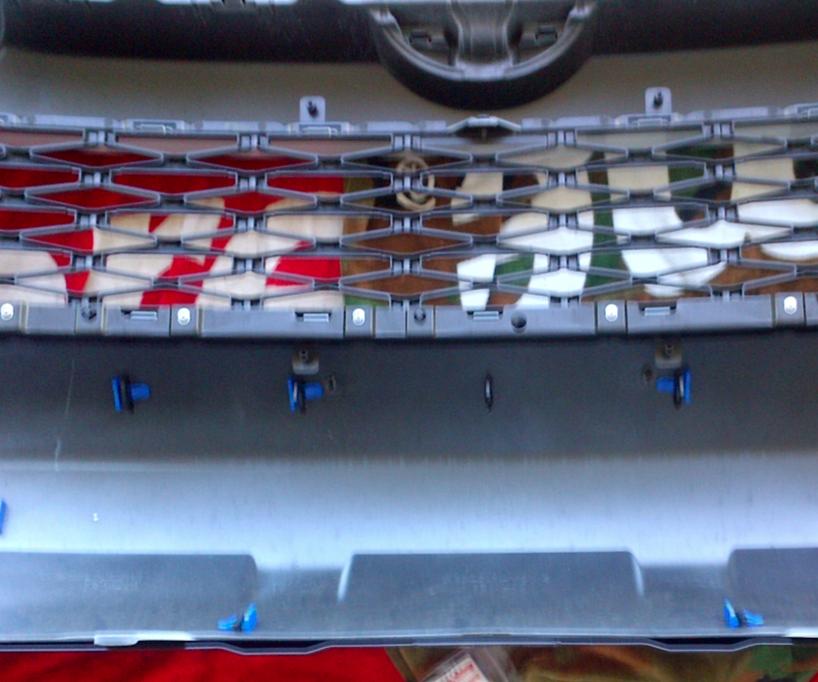

Installing TRD Pro bumper trim pieces on SR5
Front Valance Panel Install

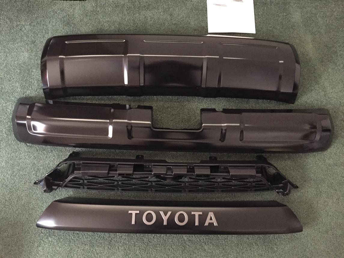

Step 1: Acquire TRD Pro Parts

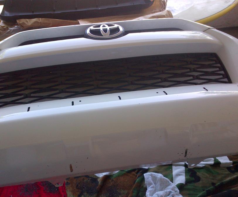

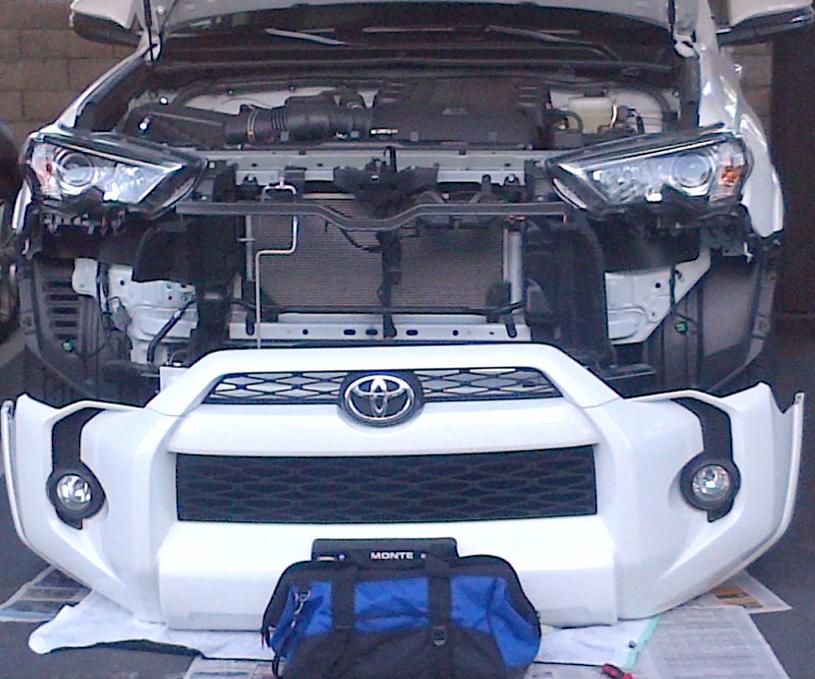

Step 2: Take off front bumper

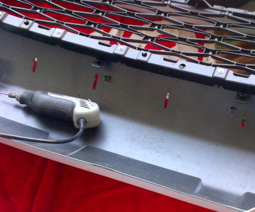

Step 3: Use dremel to create slots. There are 13 indication marks on the bumper.
Not the finest craftsmanship.
Step 4: Install front valance panel to bumper using clips
Step 5: Put back front bumper
Pretty Easy! Hardest part was taking off the front bumper.

Just to confirm are the indications pre marked on the back side of the bumper of where the slots need cut? My Dremmel Jedi skills are strong so if there pre marked then I am def all in for this
to quote TheG00ds from earlier in this thread:
"Step 3: Use dremel to create slots. There are 13 indication marks on the bumper."
That's the whole reason I reordered it. Hardest part should be removing the bumper, but I'm about to be home for two weeks once our baby girl is born so I'm ready!!
