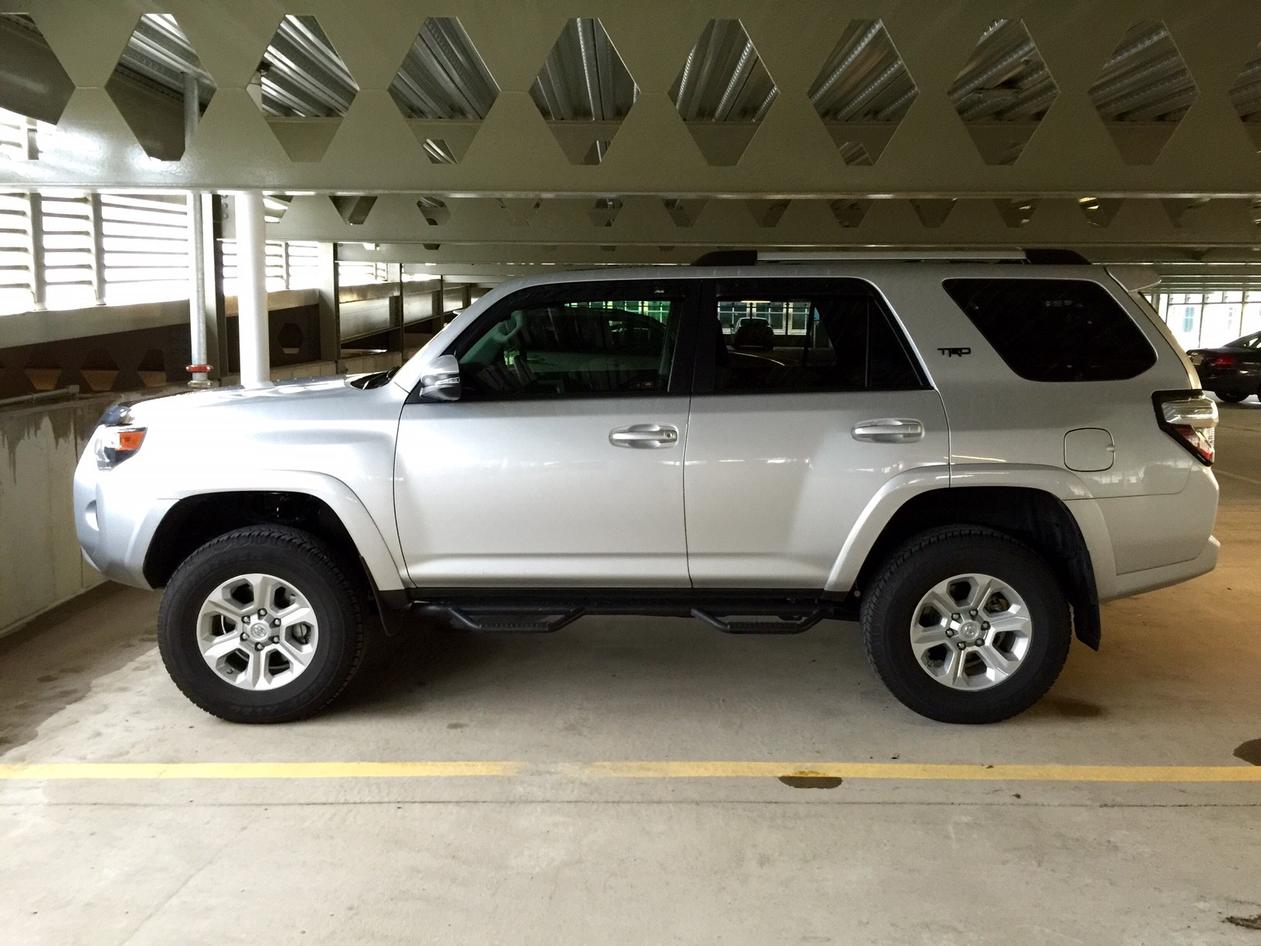

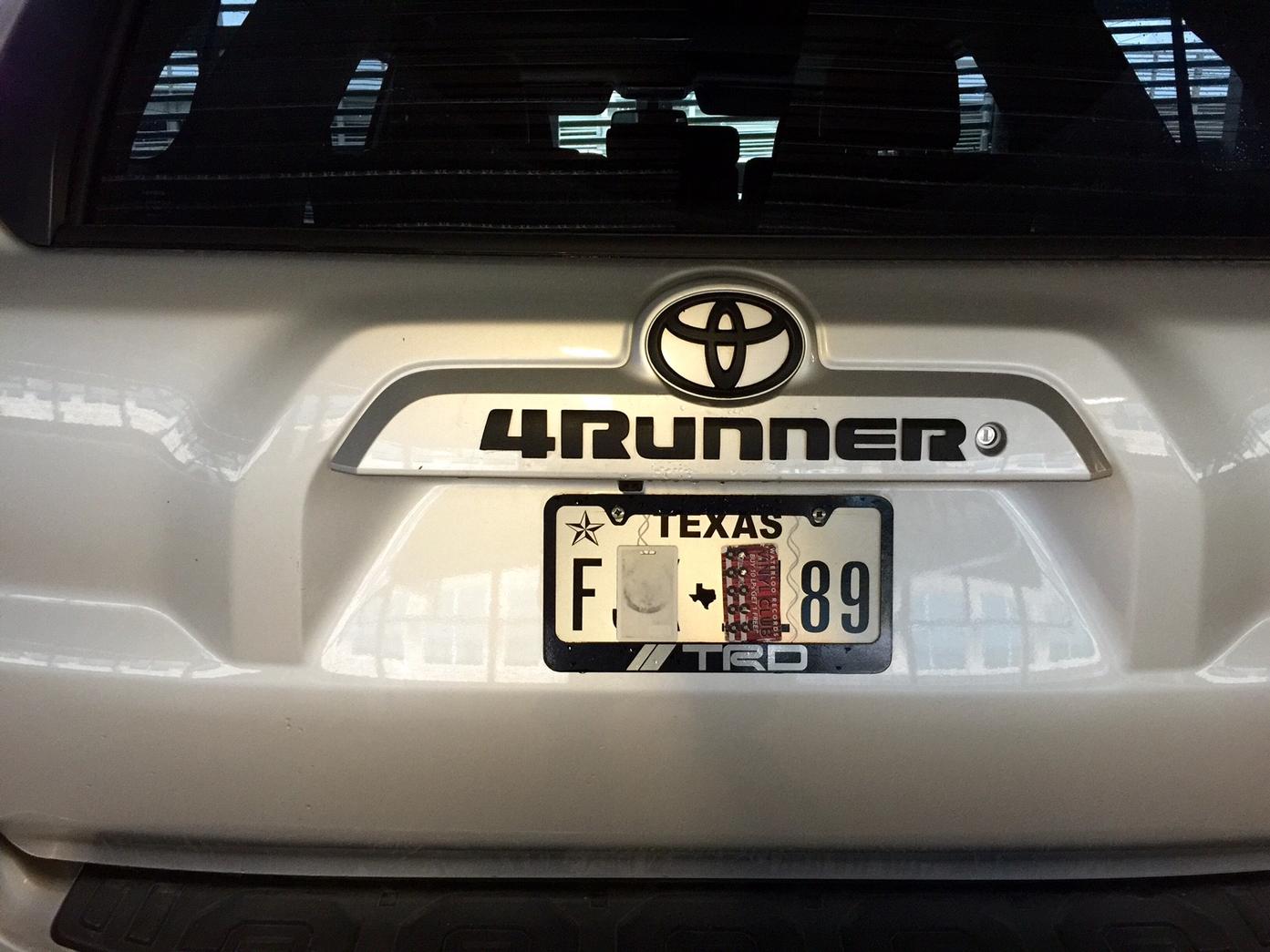

So yeah...Even though I ordered the roof rack end caps and badge/emblem black out kit, I just couldn't help myself and dipped them last night. I fig this will hold me over until I receive the new items and to be honest, I just had to see how clean its gonna look. Oh, and threw on the new color-coordinated TRD license plate frame too!
Baby girl is due Sunday, so this gave me something to pass a few more hours as we anxiously wait for her arrival :)

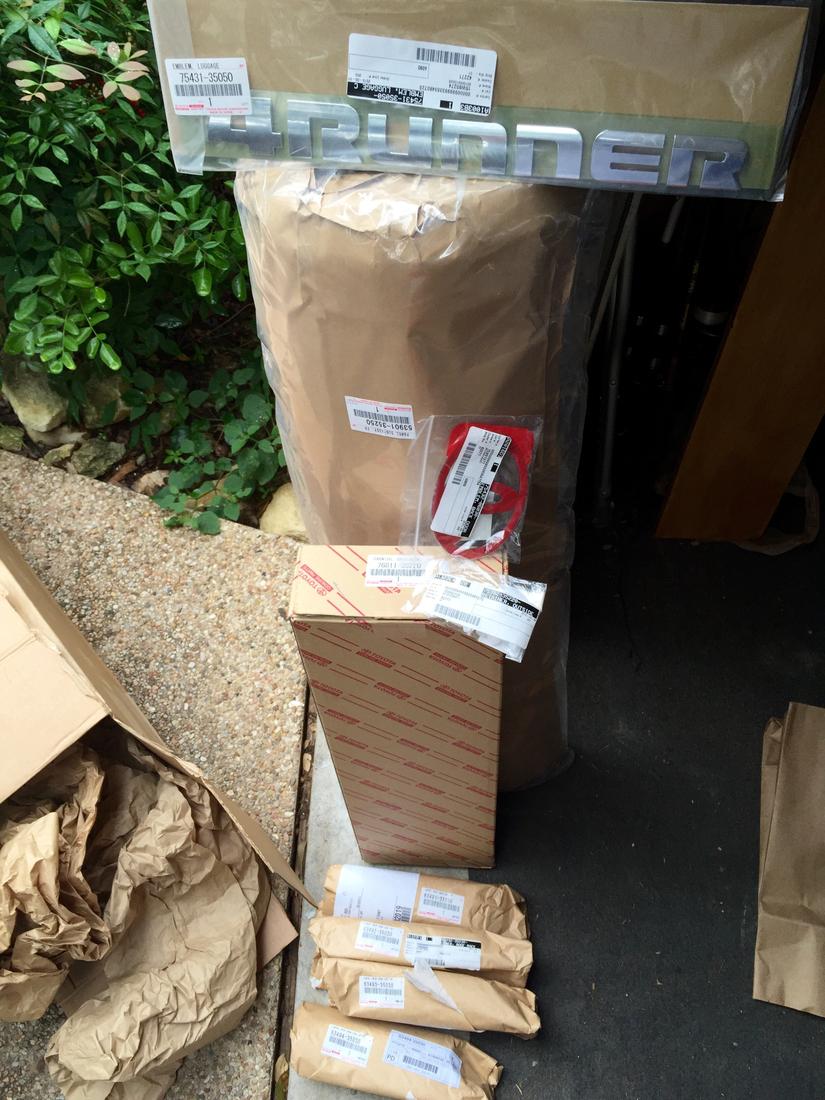

Missed the FedEx guy yesterday, so you best believe I was outside waiting for him today!!
Now I get to learn how to remove front bumper..lol

Awesome Man!!!! Please Post Pics Of All the Goods Unwrapped & Play By Play - I just found out I have Sunday & Monday Off so I will be installing my front and rear valances I hope.
TRD Pro front bumper valance panel & roof rack end caps
Wooooooooooo!! (Ric Flair shouting)

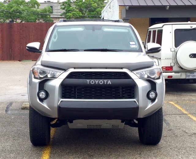

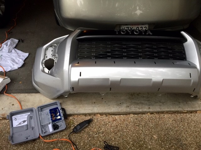

I have to say I’m feeling damn good about completing this mod. I was able to get the front bumper off much easier than expected. If you've already done the TRDP grille then it won't be hard, as the bumper pops/snaps right off just like the upper grille section. If you don't already own one, add $50 to this mod's cost for a Dremel. I got mine for $50 at HD and it came with a pack of bits, which included the one I needed.
The biggest tip I can give you is about the three screws in the fender/wheel well area. After you remove all screws and before pulling bumper away, make sure you go back and pull bottom two holes slowly away from the clamps. For the top screw, you will notice that area has a nipple that fits into the hole--You will need to slowly pry the nipple out (unlike the others that just snap away).
Once you have removed all screw and separated all clamps, pull bumper up and away. You will be scared its gonna break right before it starts snapping away, trust me. Let's just call it a leap of faith lol
I also took off my dipped roof frack end caps and replaced with the TRDP ones.
I love the way all this black contrasting with our classic silver!!

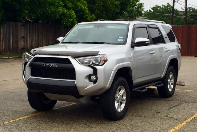

I found out I need a couple parts in order for me to complete the rear hatch handle panel, so today I plan to just take off my front skid, tape the TRD and then dip it like My14runner did. We shall see how it turns out.
This should hold me over until the needed seal comes in for the rear handle panel portion of the project..
