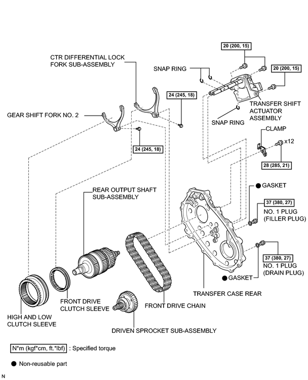

Also, I can't remember the last time seeing one but I thought it was supposed to come with the rods and you have to tear into the transfer case to install it. At least that's what a buddy of mine had to do on a V6 4runner quite a while ago.
I think I'm correct if only judging by this illustration:
Can you send me the illustration picture, never came through. I wish it was as easy as the front diff change. I'm not sure its possible without the rods...thanks
Impossible to install

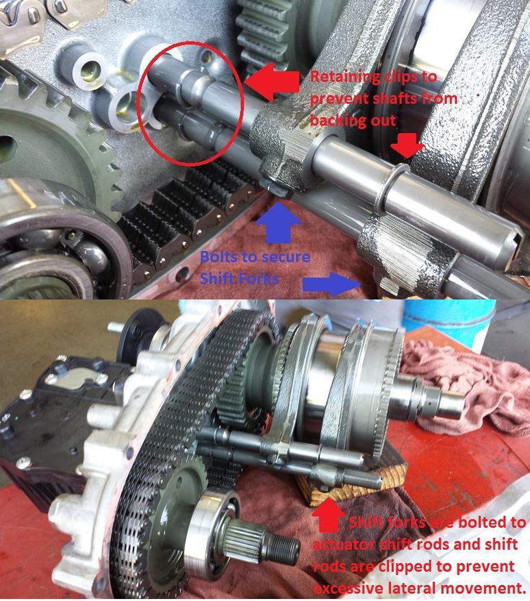

I kept meaning to annotate and post this picture I had on my phone. Sorry about it being slightly blurry, my co-worker was in the middle of resealing a 5th gen transfer case and I didn't want to take up too much of his time.
The transfercase is similar to the 4th gen units beside this one lacking the Torsen T3 center differential.
